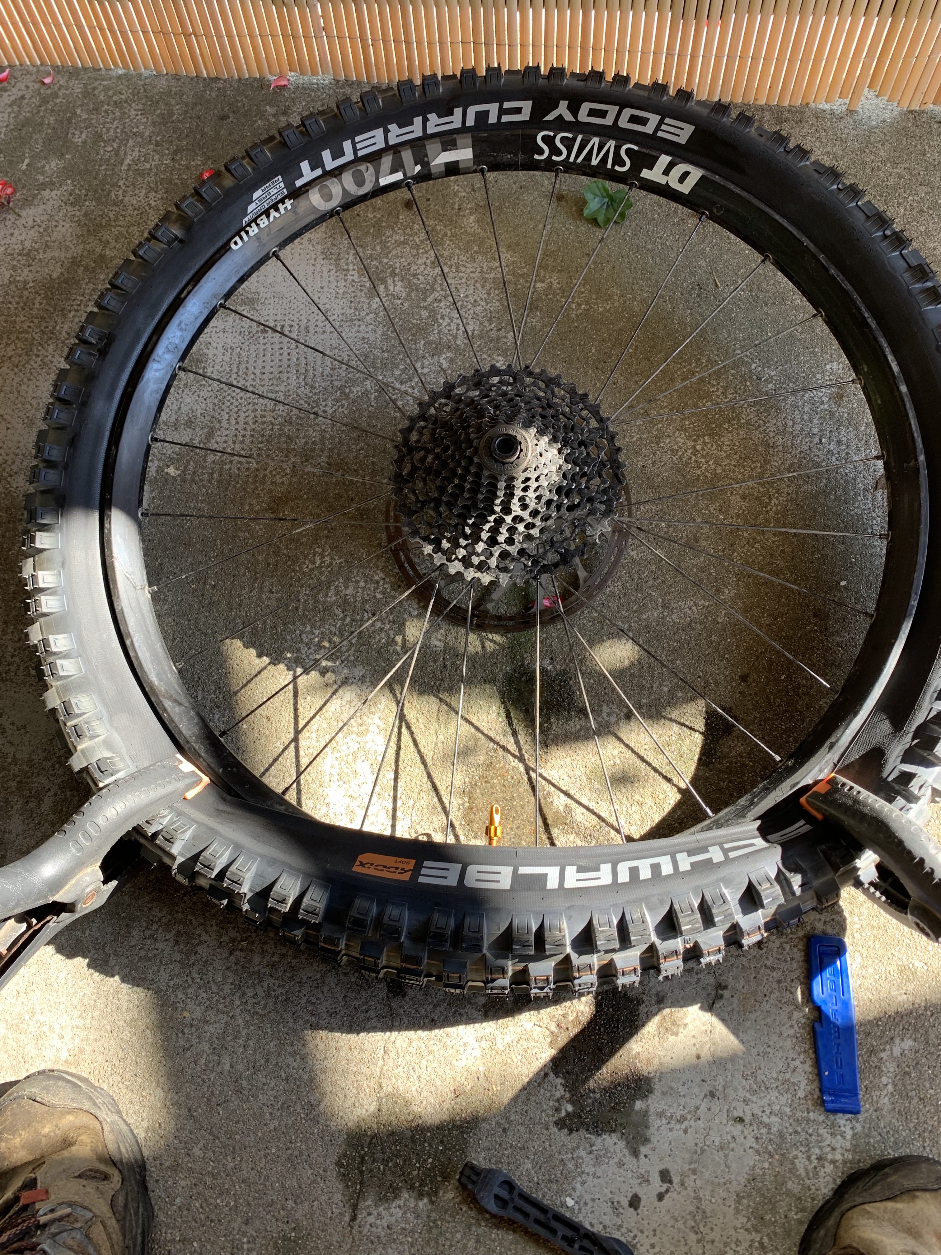

Eddy Current super gravity mounting technique, usually three clamps but have lost one

No inset , no lube, went on ok, the 29 inch front that I did a few years ago was a pain ti get on but I have the super trail on the front now which was a lot easier.
