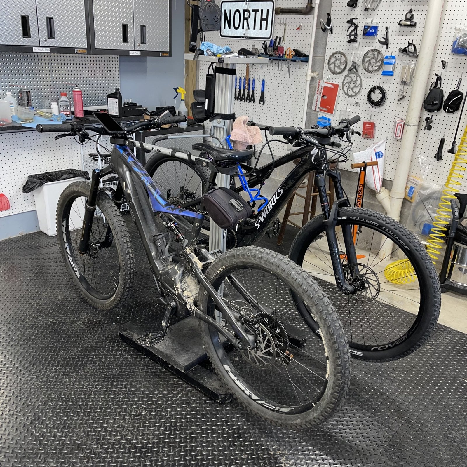

I've been running 29x2.35" Johnny Watts (JW) for over 6 months now on my '18 Specialized Levo ebike. They are awesome tires!
Yes, I am running them tubeless with Stan's. Right from the start they were easy to install tubeless and have had close to Zero leakage; I'm astonished. Most all my other tubeless-ready tires weep sealant and air to some degree, but the JW go weeks and don't leak down or even weep noticeably (I still always set my tire pressure before every ride).
I have two Levo ebikes, this one is my "Adventure" "Sport Utility" "Do-All" ebike. I use it mainly for riding on pavement like greenways and roads, gravel, and light trails. But, when conditions are dry enough, these tires allow me to ride anything that comes along, including the gnarliest of trails that I typically ride on my eMTB with 27.5x2.8" fatties. I typically avoid super wet off road conditions anyway.
These tires replaced a set of Surley ExtraTerrestrial tires in 29x2.5" that were just a little to big for my Levo frame; I needed a slightly skinnier tire, so chose the 2.35" JW front and rear. I really liked the ETs, but I like the JW's even better; they are more aggressive off road, but I find no downside to that on pavement or rolling resistance.
I highly recommend the Johnny Watts if you're looking for a do-anything tire and still want great pavement rolling attributes.
