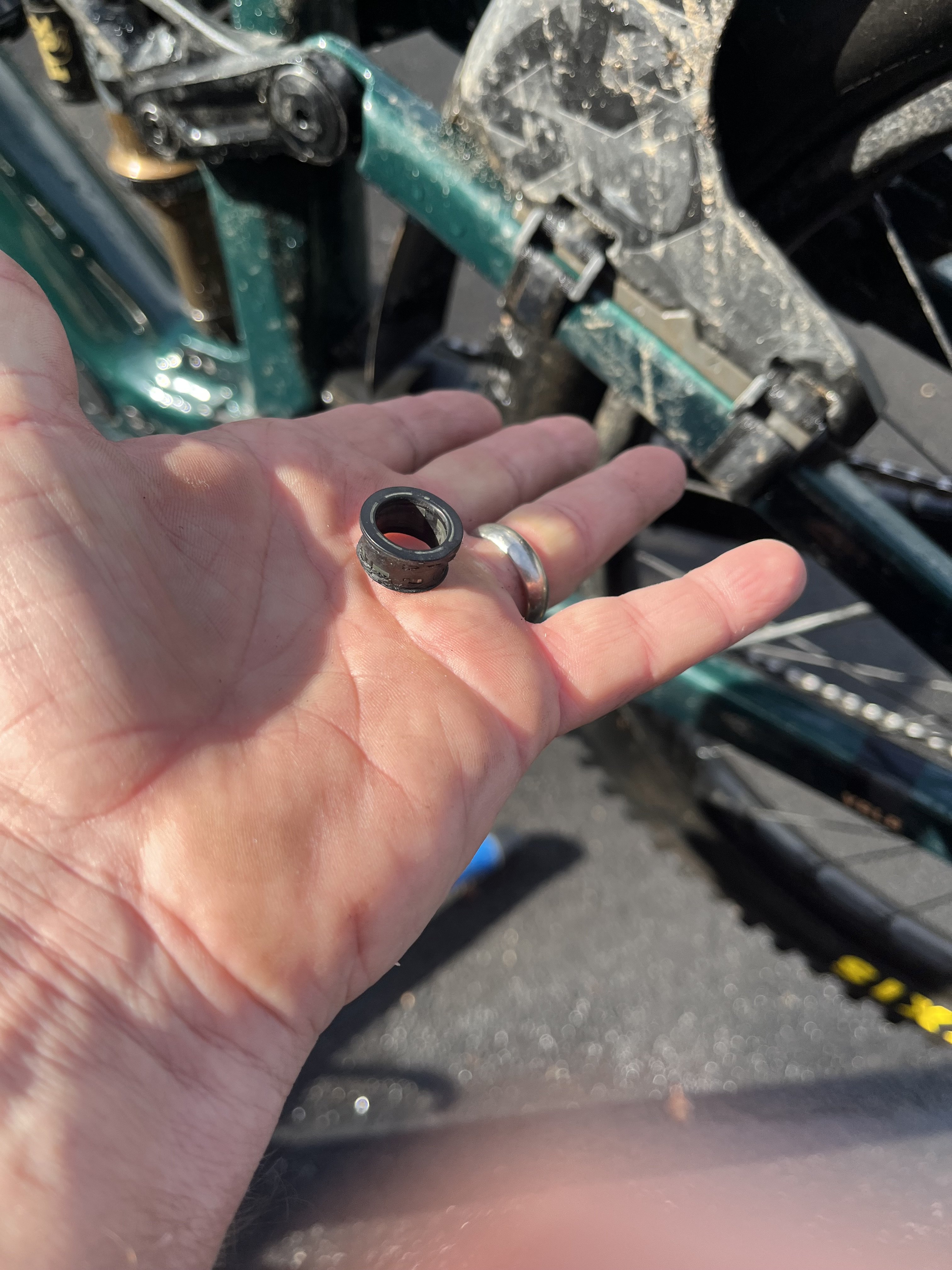

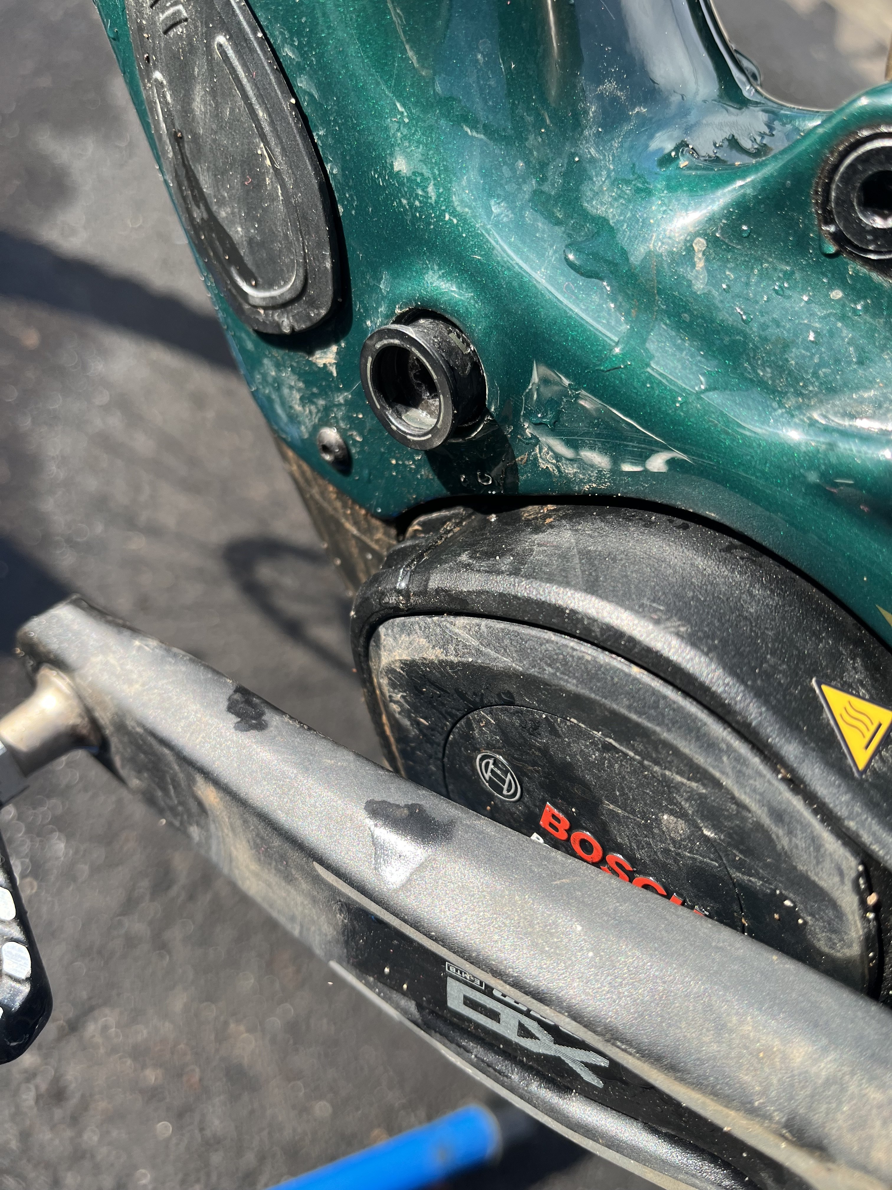

One month and 400 miles later I have come across a potentially serious issue this weekend. The motor mount bushings can walk themselves right out of the frame.
Removed the bolt, reset the bushing even though it is clearly pretty shot. Will run it with a piece of Gorilla tape over the bolt head so it doesn't fall out on the trail. Something to keep an eye out for.
Is that bit important?

Yes that bit is important. Controls how much the motor can twist in the mounts.
Is that a mounting bush or just a seal around the bolt head to keep crap out? Did the motor move when you had it in your hand? I would expect a moulded in metal insert for the motor mount. Not good just not dangerous.
