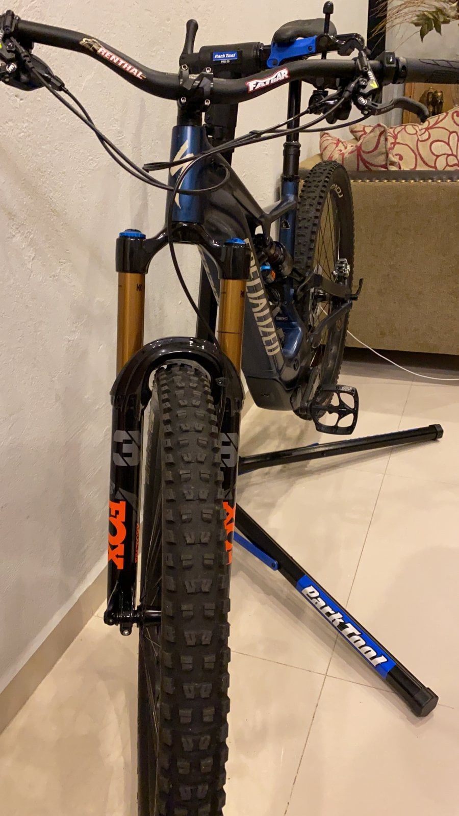

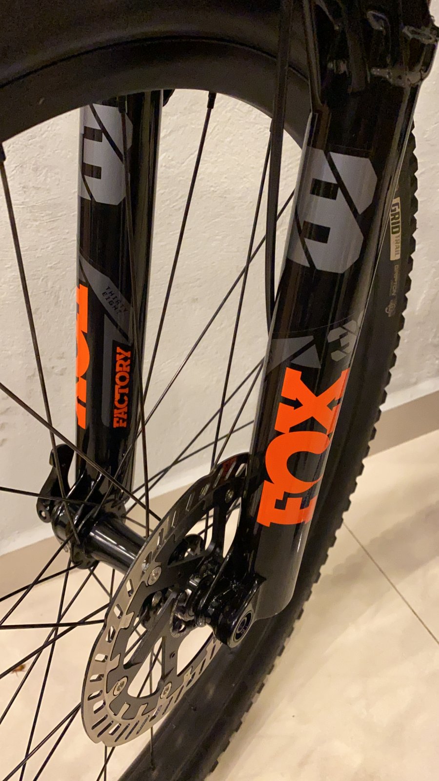

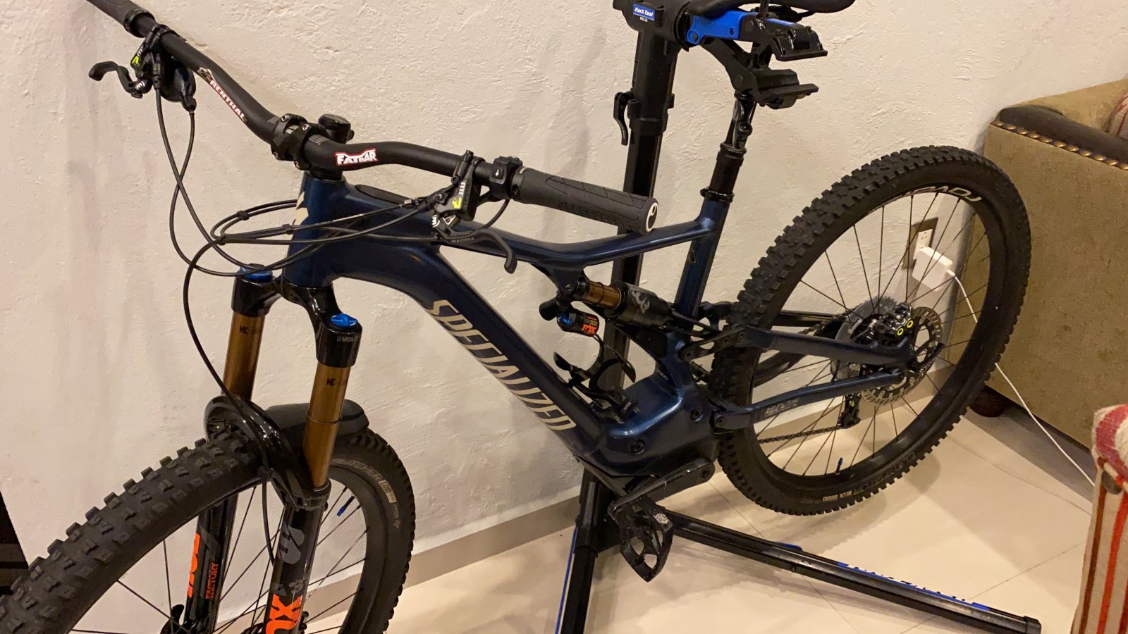

Mine was a disaster. Sent to warranty. They fixed it, but it was not good enough. Even after warranty this 35 gold is really bad.
I bought a fox38.

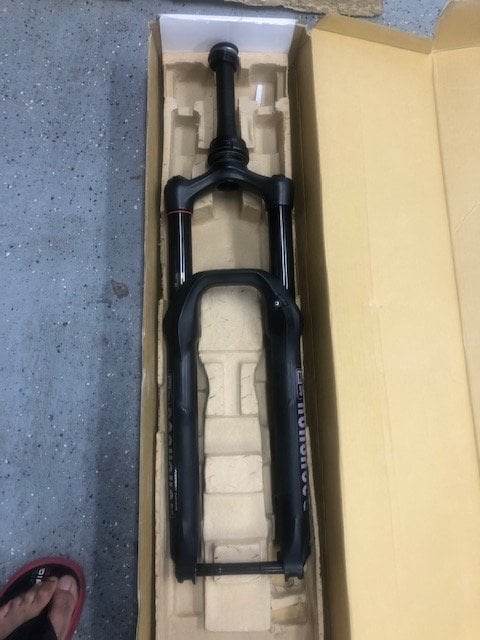

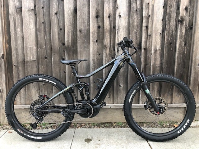

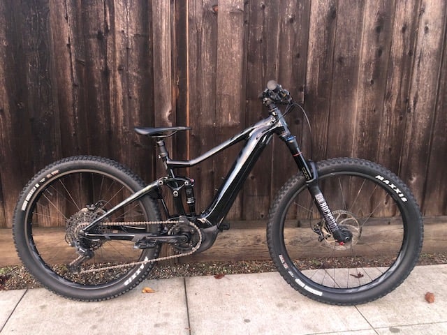

I "had" this fork on a used bike I bought. The stiction was the worst I've ever felt, considering the bike was only 8 months old with 300 miles. I tore into it and relubed the lowers per SRAM instructions and improved it significantly. However, it still had stiction at the beginning of travel (so much so that it did not extend to full travel at static). I was going to swap out the air spring and also install an RCT3 damper when I read this:
Anyway, this fork is hopeless. You can try to do the lube service, maybe even follow some of the alterations made in the damper side of the thread mentioned but personally, I suggest you switch it out.... I did (and I am NOT that sensitive to fork performance). I ended up getting a Pike RCT3 and additionally installed an Angleset. When I got this bike with that shit fork, I had serious buyer's remorse. After the Pike swap, I'm about ready to sell all my other bikes. The change was THAT good. With the Gold RL, the stiction was so bad that the front was packing after compression. With the "proper" Pike fork, I had a lot of front traction due to damper, but I was also able to lift and pre-load the front (to jump, bunny-hop, etc) that I wasn't able to do with the Gold RL.
Do yourself a favor and don't even struggle with it.
nasamorpheus
Jul 17, 2020
186
95
Ljubljana
