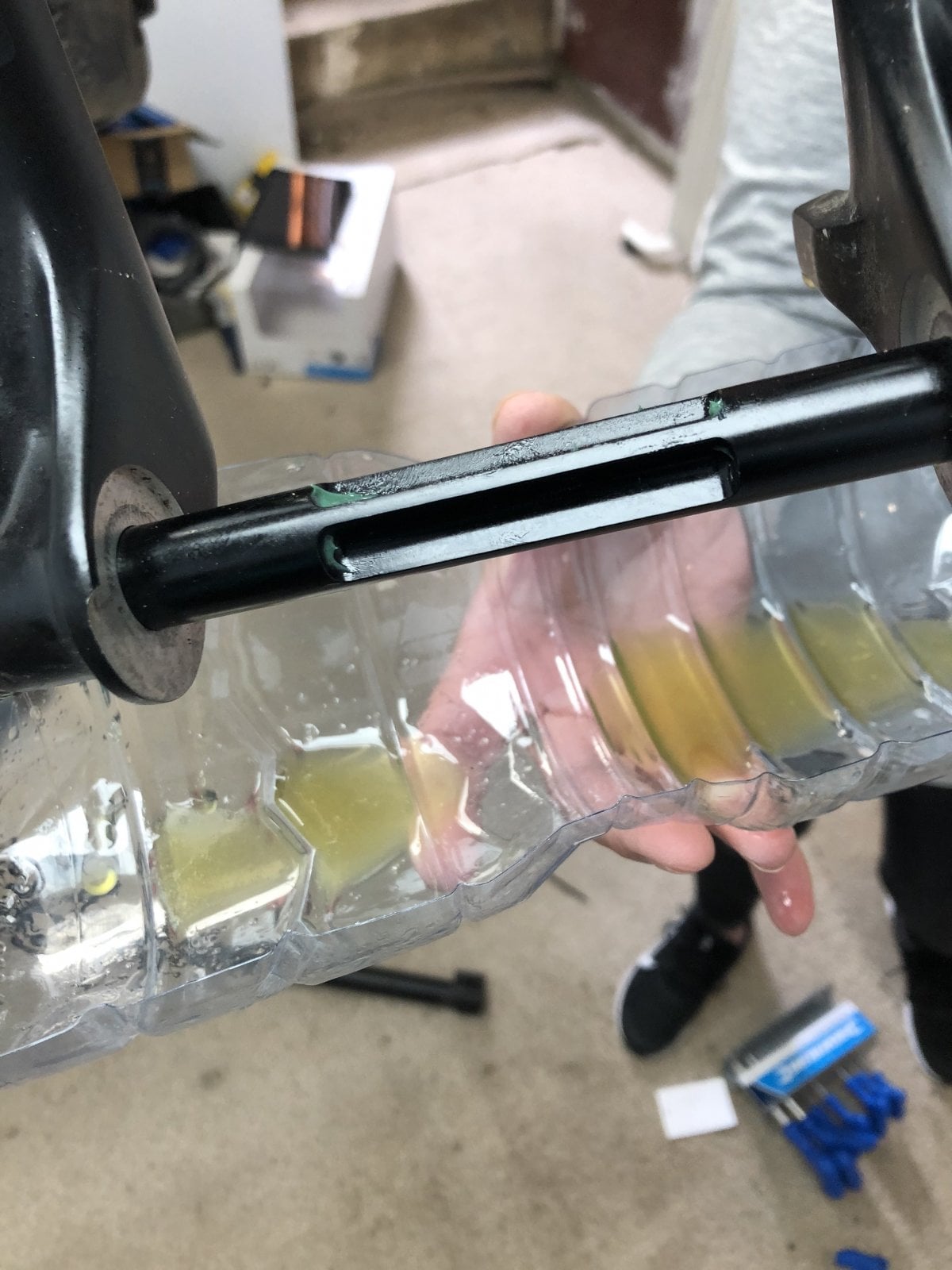

no adjustments did anything to mine, even taking the two spares out made no difference.
this is what i found...
this is the total oil from both legs

Thanks for that. Does that include the uppers? The service guide shows 4 differernt places to add oil. Both lower legs and both upper legs. Some is 5wt, some is 15!
To check the damper oil bath you need to open the top of the damper leg, pull the cap assembly and measure the distance from the leg crown to the oil. At least I think that's what it's saying. It's a complicated design for their budget offering

He said hardly any oil in the lowers. So I'd assume he didn't do anything with the damper.
As you'll have seen from the tech docs/service guide there's only meant to be a small amount of oil for lower leg lubrication which has nothing to do with the damper oil, which as you rightly state stays contained within the upper leg when the lowers are removed
it's pretty common for only a little oil to dribble out during a RS lower leg service, some is soaked up by the foam rings and slowly used up over time by the action of the fork and some is still in the lowers. RS tend to er on the stingy side from new too,
I just did a 50 hour service, it’s just lower legs....

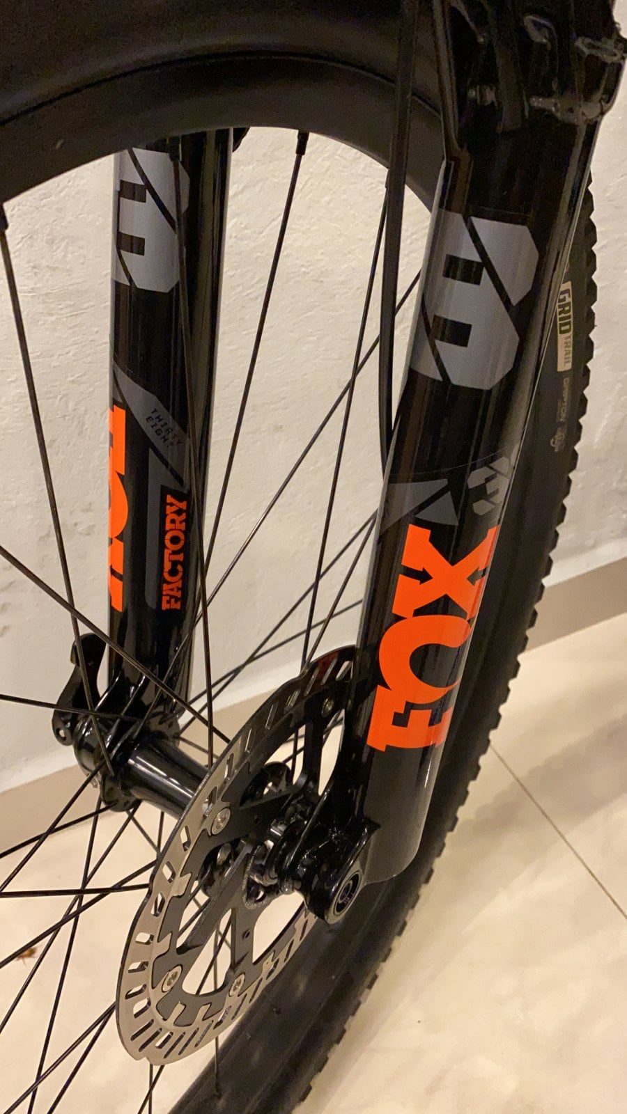

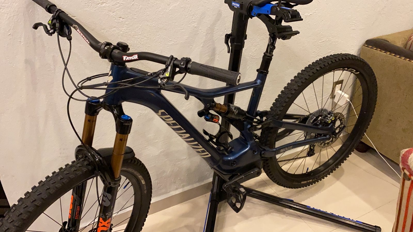

I finally fixed my RS Gold 35 fork problems....
Couldn’t be happier.
