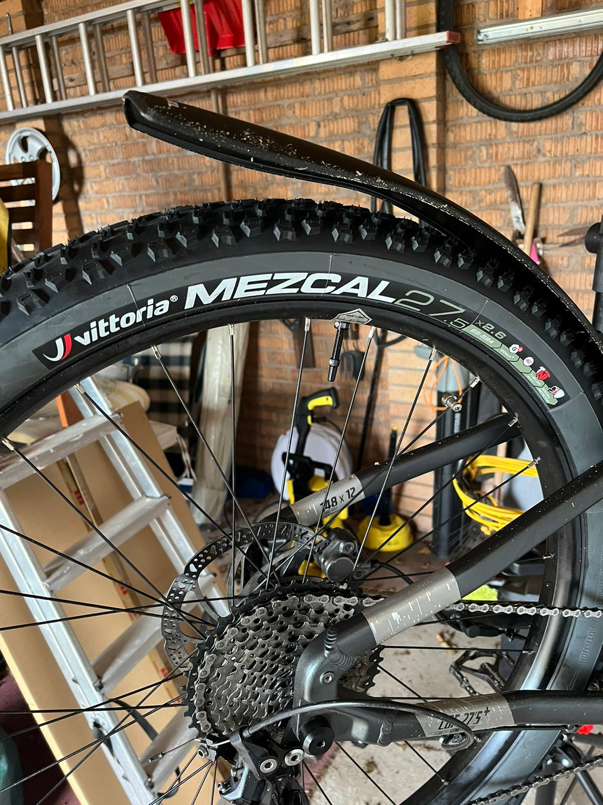

I’m riding heavy enduro Maxxis and Specialized tires, not really the best for your current riding stuff. I do like Vittoria XC tires. 2x Mezcal or Barzo front + Mezcal rear, in TNT casing. Good traction, durable and also, very important, good rolling resistance.

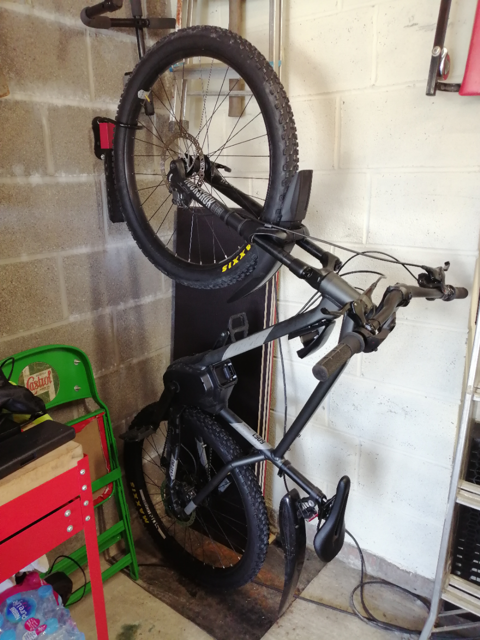

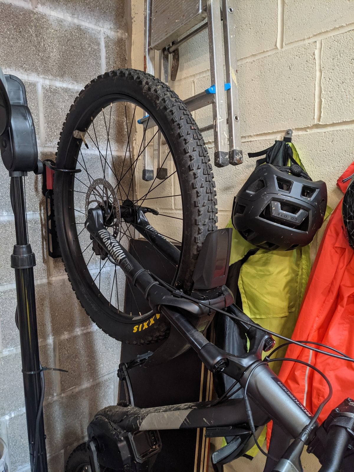

Fitted my 900 with Maxxis Ardent 27.5" x 2.40 and am more than happy with them. Best thing about them though is that my wheel now drops nicely into my wall bracket with a small flick of the handlebars. With the original tyres fitted, I had to push the wall bracket over the wheel by hand.

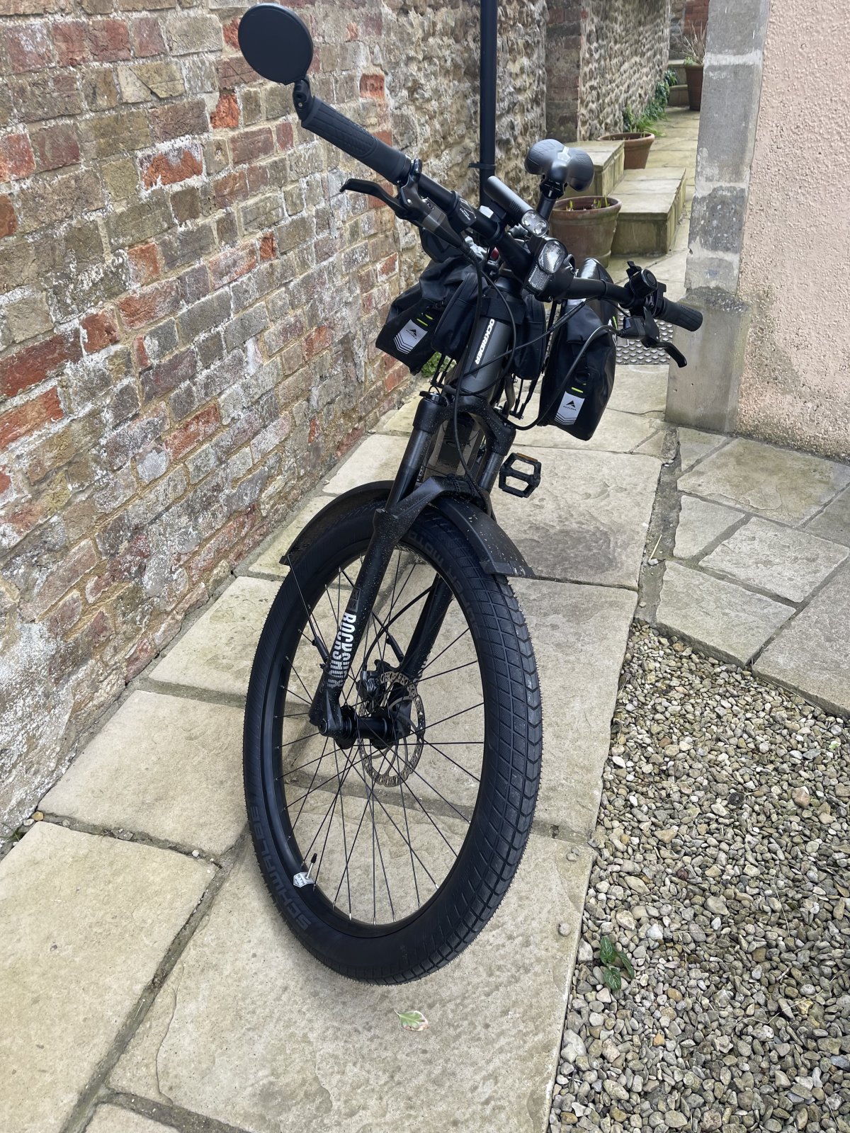

Using the bike almost all on tarmac and a bit of gravel have switched to Schwalbe Super Moto-X 2.8s, quieter, smoother rolling AND the annoying metallic noise than can from the motor are at around 25 KMH has gone completely, must have been some sort of resonance from the original tyres.

I'm running Maxxis Ardent, front and rear. Much better than the original tyres.
Rear is still tubeless, but I've now put a slime inner tube in the front. You need a high pressure pump when going tubeless, which I don't have.
Tyres are way better on mud and wet grass. Would recommend.
