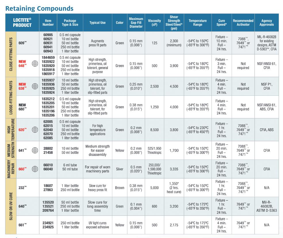

You can always run your upper linkage free of any cylindrical retaining compound. If your upper linkage does not shift on the upper pivot axle then you're good to go. If it does shift, then use the retaining compound.
I think what dictates linkage arm slippage is how hard a Rise is being pushed. If a rider tends to ride smooth flow trail, then linkage arm slippage will not be an issue. However, if the bike is being pushed hard on chunky trail, rock gardens, berms, and jumps, then the chance of the linkage arms loosening up increases substantially.
The axle spline and the splined inlet on the linkage arms, are a close tolerance fit. Every time the tolerance fit is disturbed, as an example, the linkage arm(s) begin shifting on the axle, or the arm is removed from the axle for maintenance, micro amounts of aluminum material are removed from the axle and linkage arm. The close tolerance fit becomes less close. As material is lost, the loosening up of the linkage arm will occur at a more rapid rate after each Pre-Load reset.
The question is, do you want to stop the wear before gets severe? If you do, then use a cylindrical retaining compound. It's very much your personal choice.
Do not feel compelled to try high strength Loctite 648. Loctite sells various strengths of cylindrical retaining compound. Loctite 641 is a medium strength compound that is easier to work with and to disassemble than 648. Your bike is fairly new and the wear on the splines may not be severe. 641 may work well for your situation. My Rise linkage was very worn and I was resetting pre-load once a month. Loctite 648 immediately solved the slippage issue. Just go sparingly with the 648.

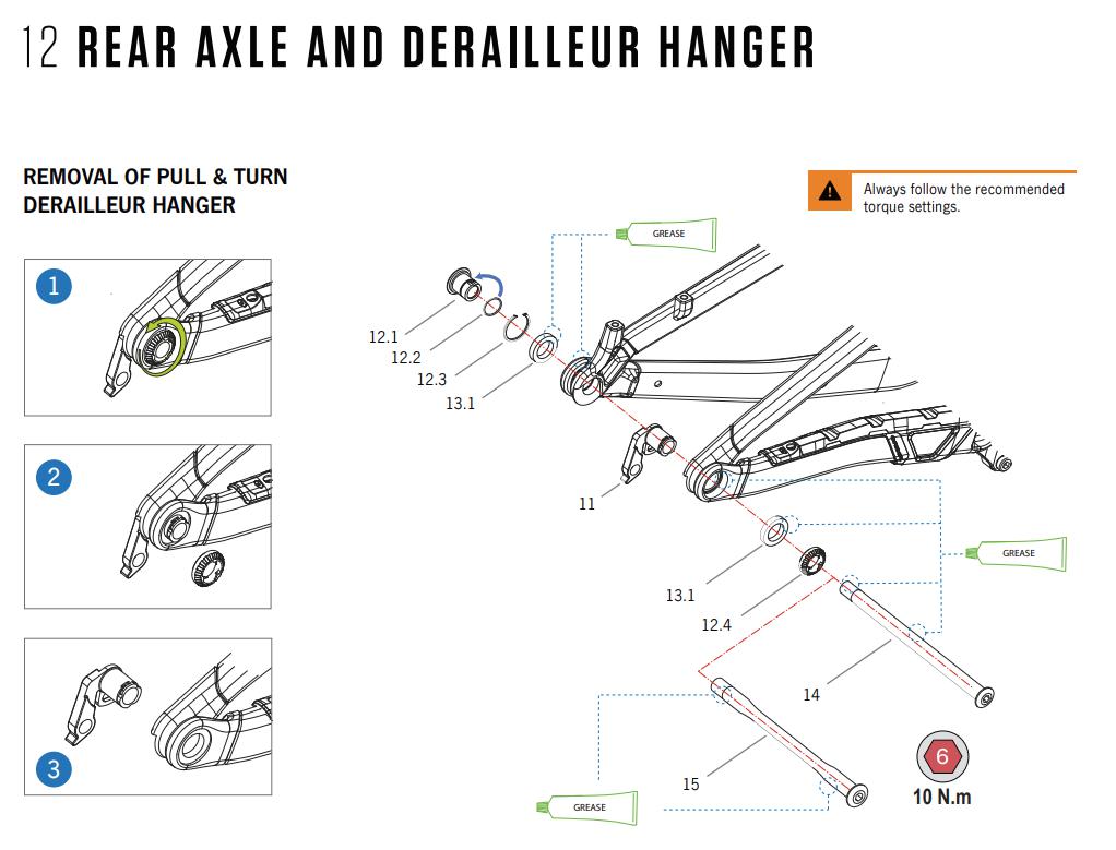

I'm trying hard to avoid the slippery slope of aftermarket mods. I did it with my 2018 Santa Cruz Tallboy.
Before working on the linkage with the Orbea today , I checked the rear axel and discovered the weird "pull and turn" derailleur hanger connector. I've only had the bike since July and never took of the rear wheel. I always carry a spare hanger but realized I'd never get that connector off without a pliers, which I don't carry.
Any thoughts?

Brother, half the fun in mountain biking is the "Slippery Slope" of aftermarket mods, just ask my wife....wahoo!!! On second thought, don't ask her...
I think the Rise is a very versatile "Trail" bike. In stock form, the bike is a capable trail bike. There are not that many eBikes out there that can match the Rise's combination of power, range and lightness. However, the Rise in stock form has shortcomings that limit the bike's capabilities, especially if a rider wishes to take the bike onto more technical terrain. I totally respect your desire to not want to mod your bike. I've been there. However, if you wish to safely take the bike onto more technical terrain, you may need to anticipate sliding down that slippery slope to the land were mods exist. Feel free to shoot me a private message if you want to discuss possible mods.

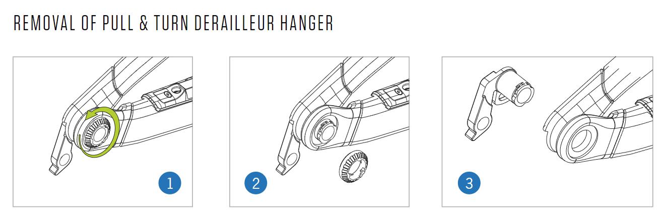

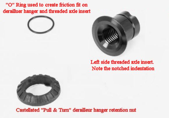

As you've mentioned, there is a black plastic Castellated "Pull and Turn" nut located on the right (Drive Side) rear drop out on the Rise. The castellated nut holds the derailleur hanger in place. The rear axle inserts into the castellated nut and threads into an insert located on the non drive side (Left) of the bike.
To remove the castellated nut, you first need to remove the rear axle and rear wheel. Next you take your fingernails or a soft pry lever and pull up slightly on the nut. Next turn the castellated nut in a counter-clockwise half turn direction. This will release the castellated nut and you can remove the derailleur hanger by pushing it out of the castellated nut. The derailleur hanger is held in place inside the castellated nut via a friction fit which is caused by a small thin "O" ring which wraps around the shoulder of the derailleur hanger. In the parts diagrams you will see "C" clips. The "C" clips retain the rear chain stay pivot bearings in their bore holes. The C clips have no function with the inserts.
Note: You do not need to remove the castellated nut to remove the rear axle and rear wheel. You must remove the rear axle to remove the castellated nut. The castellated nut is made of soft plastic that can be easily damaged if you use pliers to pull up on and turn. Sometimes the nut can be difficult to pull up on, especially if there's a lot of crusty trail build up. I like to spray a little bit of lubrication, i.e. WD-40 or something similar onto the nut and let it soak in before I try removing the nut.
IMPORTANT: The left, non-drive side chain stay has a threaded black alloy insert that fits into the chain stay. The rear axle threads into this insert. The insert is held in place on the chain stay via a friction fit which is caused by a thin "O" ring that wraps around the shoulder of alloy insert. If you examine the picture below, you will note that the left insert has a notched indentation.
There is a corresponding notched indentation that is molded into the seat stay. The indentation prevents the insert from turning when you tighten the rear axle. HOWEVER....it's very easy to dislodge the insert slightly when working on the rear. This may cause the insert indentation to fall out of alignment with the seat stay notched indentation. If you tighten the axle with the inserts out of alignment, this can damage the seat stay notch. Before tightening the axle, always make sure the insert's notched indentation and the seat stay notch are aligned.

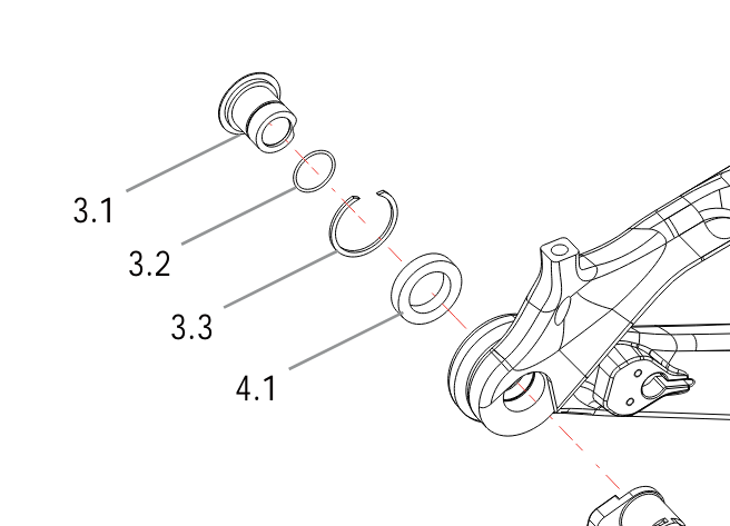

I also noticed that the non-drive side upper chainstay does not move freely. I had loose rear axle and for some reason i tightened it from the wrong side (non drive side) I think i messed up the non drive side flange due to over tightening the axle.
Does anyone know is the non drive side hardware held in place with the metal circlip shown in the photo, and how to remove the non drive side hardware?

Bnito,
The "C" clip holds the rear pivot bearing in place. The non drive side, chain stay and seat stay are held together via friction caused by a small rubber "O" ring (Part # 3.2) which is located in a machined groove on part # 3.1.
To separate the non drive side chain stay and seat stay, simply hold the chain stay with one hand and hit the seat stay with the palm of your other hand and they will separate.
Note: There is a notch machined into Part # 3.1 and a corresponding notch machined into the chain stay. The notched items prevent part # 3.1 from spinning when you tighten the rear axle. The male and female notches must be aligned when you re-assemble the components and tighten the rear axle. If the notches are not aligned, you can damage the chain stay and or part # 3.1, i.e. square peg in a round hole situation.

Thanks, got the chainstay and seatstay separated, just few taps with a rubbermallet did the job.
Everything seems to be okay, there is no damage on the non-drive side.

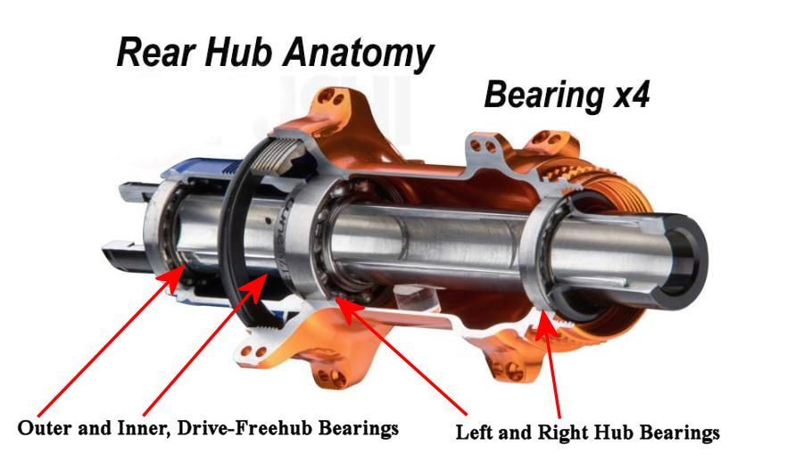

Another issue on the Rise which will cause a creaking noise while pedaling, are a worn out drive side (Right Side) hub bearing and the two freehub bearings. The noise will sound similar to a crunching noise when pedaling under a load. The noise will start out small but get progressively louder and worse as the rear hub bearings wear out.
Fortunately, the fix is relatively easy and quick. All a person need do is replace the cartridge bearings in the hub and freehub.
It's important to understand that most bicycle hubs made nowadays were designed and made to handle the pedaling loads of a traditional pedal bike. The small bearings were not specifically designed to withstand the immense torque produced by an electric motor rapidly propelling you and your eBike up a hill. All rear bike hubs have a total of four small bearings. Two bearings are located in the hub, they are the left and right rear hub bearings. Two additional bearings are are located inside the freehub-driver. The cassette attaches to the freehub-driver. The freehub-driver allows the cassette to freely spin when coasting and also drive the rear wheel forward when pedaling.
The drive side (Right Side) hub bearing and the two freehub-driver bearings take a lot of abuse. While there is no hard and fast rule for when they need replacing, you can reasonably expect to replace the rear hub and freehub bearing around 1,200-1,500 miles of hard punishing trail riding.
There are two ways to tell if your rear hub or freehub bearings are going bad. The first is to place your bike on a bike stand. Spin the pedals and let the rear wheel spin. Place your fingertip on the chain stay of the bike and feel for vibration. You should feel a silky smoothness as the wheel spins. If you feel any vibration transmitting into your fingertip, you have a rear hub and or freehub-driver bearing going bad. Another way to check for a bad rear hub bearing is to place your bike on the ground and laying on it's side. Place your foot on the rear wheel (Rim &Tire). Pull upwards on the bike with the handlebars. Listen for an creaking sound coming from the rear wheel. If you hear a noise, you have a rear wheel hub bearing going bad.
