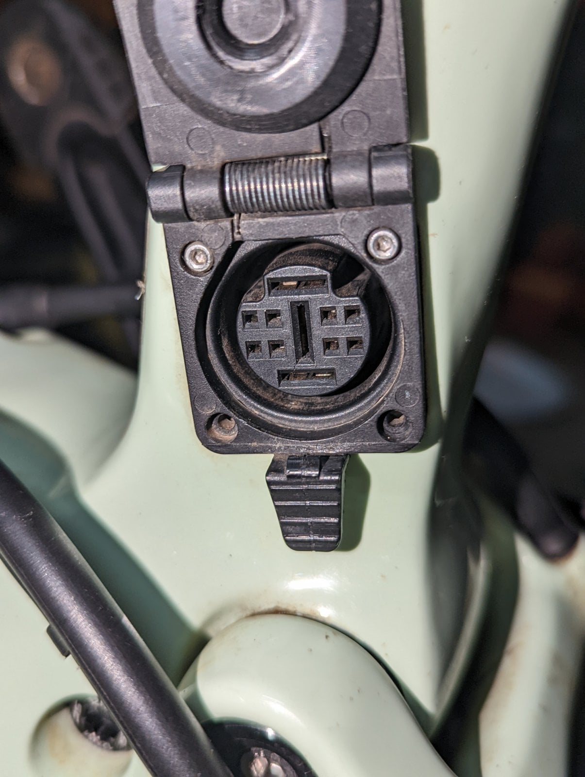

Can someone please tell me the details on our Rise's charging port screws? I recently noticed I have two missing and need to replace them. Thanks!

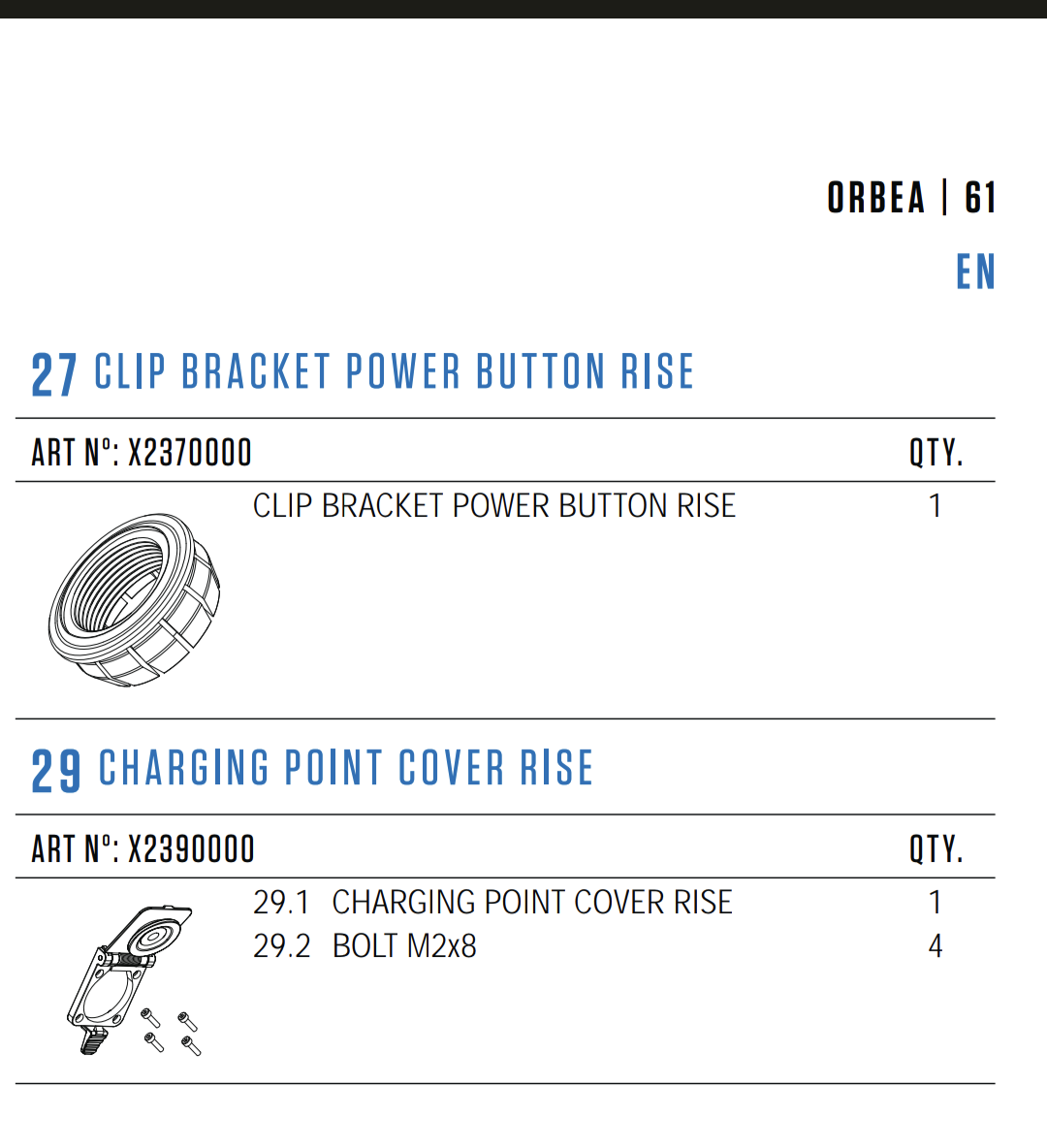

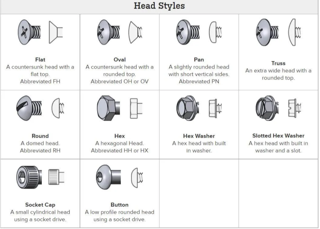

M2x8. From the picture it looks like it's a torx socket cap head and not countersunk. I would remove one of the original bolts to examine before ordering anything online.
Page 61 of the Rise Blue Book manual

Thanks guys! I used a 1.5 mm Allen key to tighten the top 2 bolts as they were loose too. I will check before I purchase but I believe they are counter sunk.

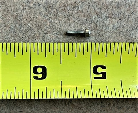

Haha, I didn't even look at the specs in the manual. I just saw the tape measure photo and thought "I could be very helpful and convert that to mm quickly". Made my post useless. Thanks. Metric measurements are soooo much better than our American way of doing it.
