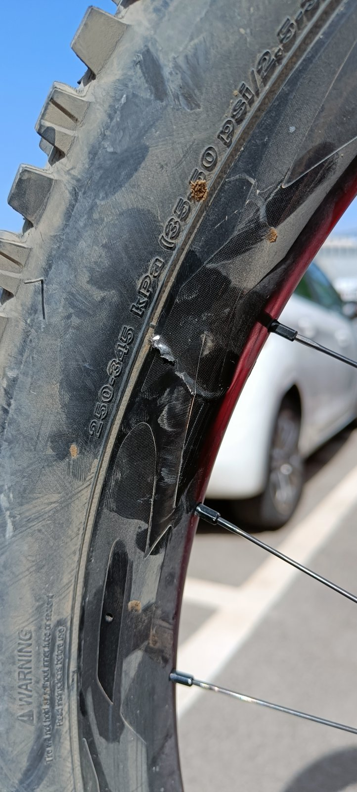

Hi guys... Do anyone has broken the eTRX carbon rim? mine is fault after 5 or 6 ride... the tyre was perfect, i hadn't any puncture and the pressure was still high. i think the side of the carbon rim is collapsed.
this is the photo. i'm still waiting Giant for the warranty
PS: do you have already tryed to use a 205x65 shock instead of hte 205x62,5?

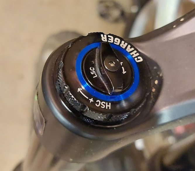

I have a reign E+ 2 and from all the specs and data I should have a ZEB Select with the RC damper which only has high speed compression. I have HSC and LSC dials on mine though. Does anyone know if this is the RC damper or have I got something else in here. Or do I need to take it apart to find out? Thanks
Well the clue is in the writing that says charger 😉 are they Zeb ultimates on the fork stickers?
Dannage
May 28, 2022
34
48
Someone messed up then as that's the charger damper
The specs say it has a "Charger RC" damper. But the Charger RC has only HSC. Was wondering if it was the Charger 2.1 RC2 as that looks like the only damper with HSC + LSC for the ZEB. Looks like I've scored. Happy days
I saw an E+1 in a shop with a Kashima shock, it's a lottery what you will get these days but generally you will get upgraded rather than downgraded. Score.
I have 65mm stroke shock, All fine on my size large
