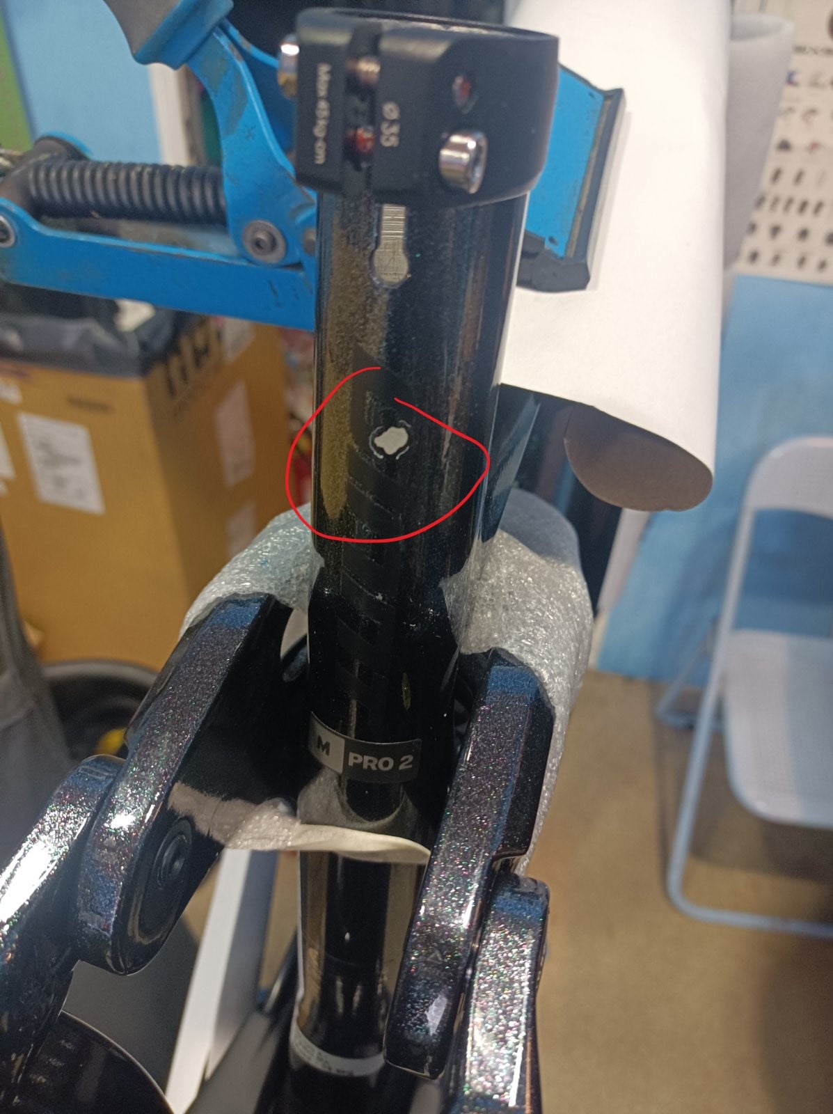

Today I was supposed to take delivery of my new Reign E+2. The LBS called to tell my the paint is scratched and off at the seat tube (see pic below).
I told them I'm not taking the bike for now, call Giant and see what they have to say.
What would you do guys if you were me?
LBS said we could fix it with some careful paint job by a pro and probably Giant will offer some small discount.
Otherwise if I do a warranty claim, and ask for a new bike, who knows for how many months I will have to wait ....
Opinions ???
Opinions ???
Aluminum frame not carbon, I would see what kind of discount they offer. We are all going to have damaged paint at one point.
Opinions ???
I'd push for a discount of £100. It would only get scratched anyway being a MTB.
Opinions ???
Touch up paint + discount sounds good 👍... if you want to ride it this season 😫
Opinions ???
I'd ask for a discount and just put paint over it or add a frame protective patch. Its going got get worse marks than that in the future!

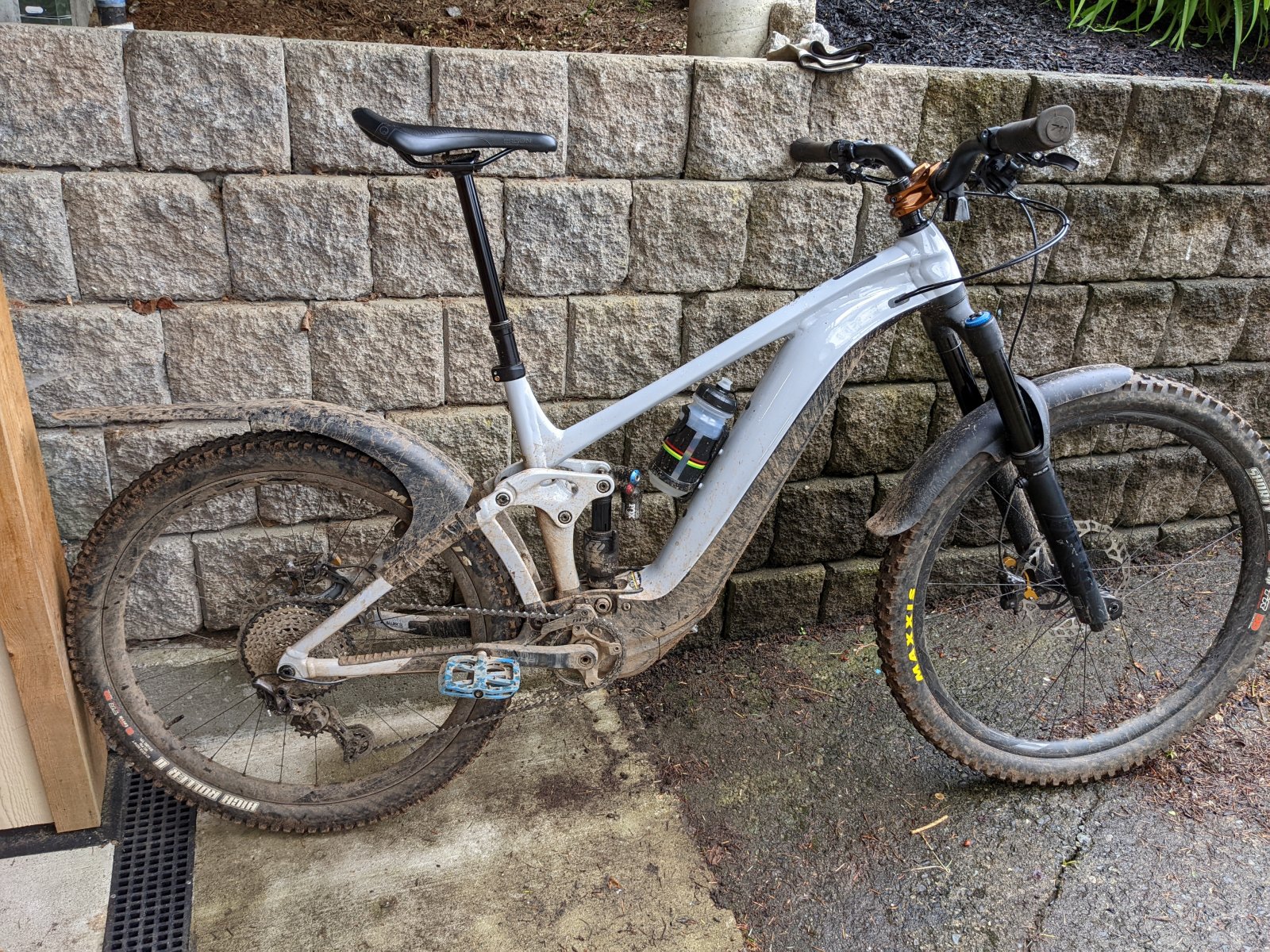

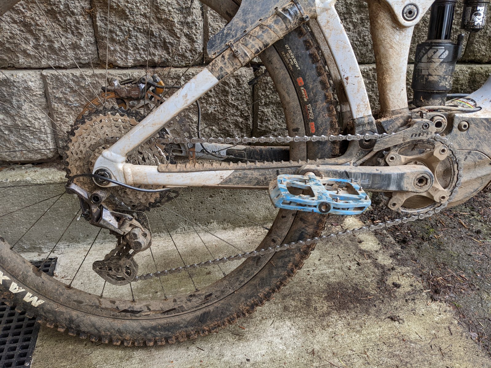

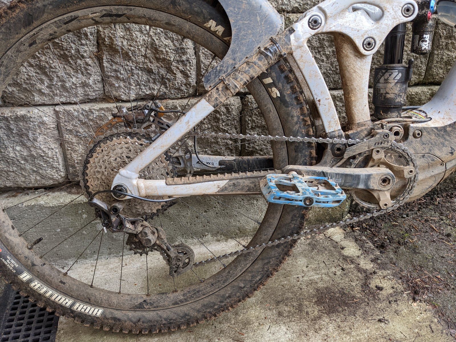

Any one here dropped Chainring size? thinking of fitting a 32T instead of a 36. I am surrounded by long climbs, and also looking to better match some mates who are,nt E-powered yet.
does it affec the software does it need any update for the power meter
. or can I swap just like a normal bike.
i put on a Praxis 32, the smallest they make and that can be fittted. however, i also swapped to a 10-45 cassette and short cage rear mech, so the gearing is essentially the same. i love it. it makes for a smaller drivetrain, and the rear mech is 30mm shorter, so on the small rear wheel it gives much more clearance. there are many steep climbs where i ride and i don't find any need for lower gearing, personally.
Please show us a picture of your setup, sounds interesting 🤓
