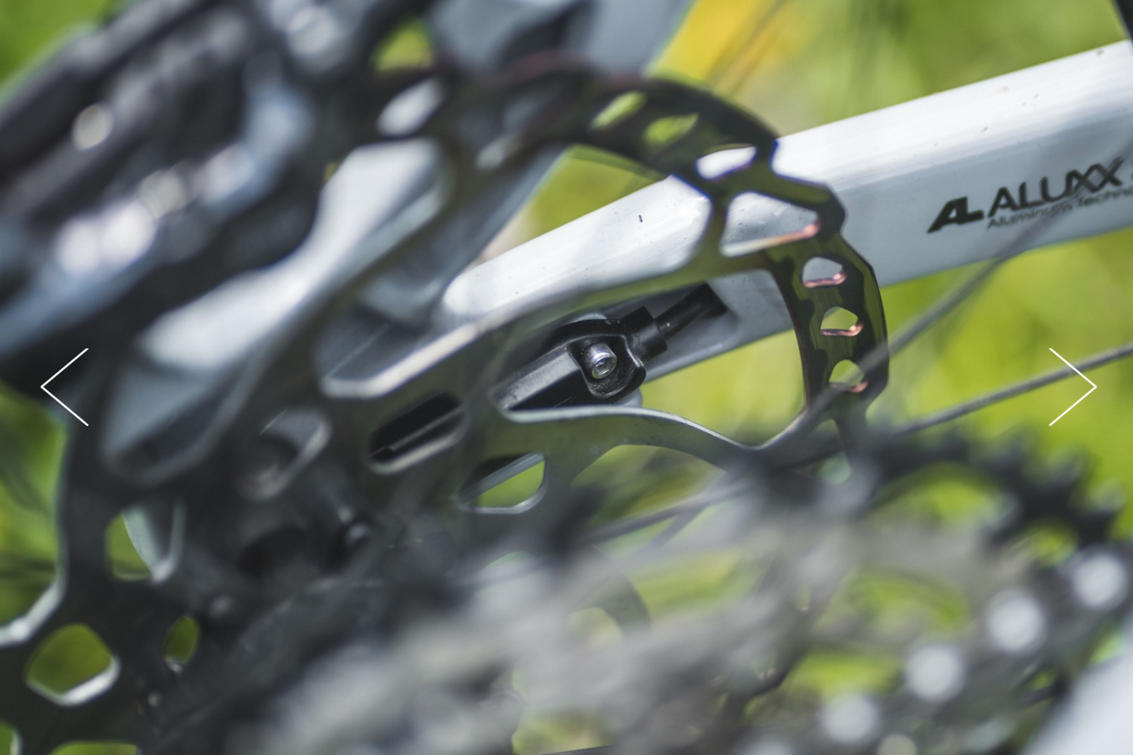

Hey can anyone with a '22 Reign 0 tell me if the cassette is 52 tooth or 50? Or if the derailleur is 52 tooth compatible ie Eagle Lunar? Can't tell in the pictures, but I do like the big bailout ratio the Lunar 52 tooth cassette provides. I have a Reign 0 on order but delivery keeps getting delayed ...
Both Reign 0 & 2 have the same Sram NX cassette that is 11-50T.
Both derailleurs on 0 & 2 are compatible with 11-52T cassettes however.

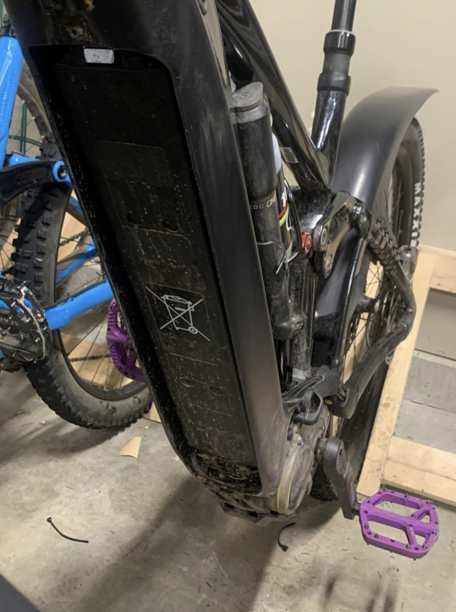

My buddy just bought the Reign E1 a couple of weeks ago had a 4 or 5 rides on it and it got muddy. Hosed it off a couple of times, and now it will shut off while climbing or descending. He bought it from a corporate store here in Vancouver. He will hopefully find out if they can fix it next week. Store does not seem to helpful. It rains a lot here so this ebike may not have been the right choice for here.
jeanmarc
Mar 2, 2021
456
440
Canada
"Hosed it off a couple of times"... 😖
I wouldn't do that to any e-bike. Remedy would be to get all parts completely dry, probably some disassembly ☹

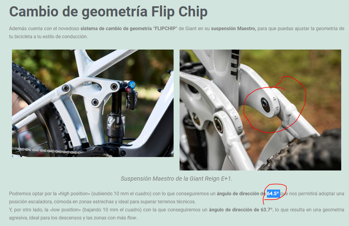

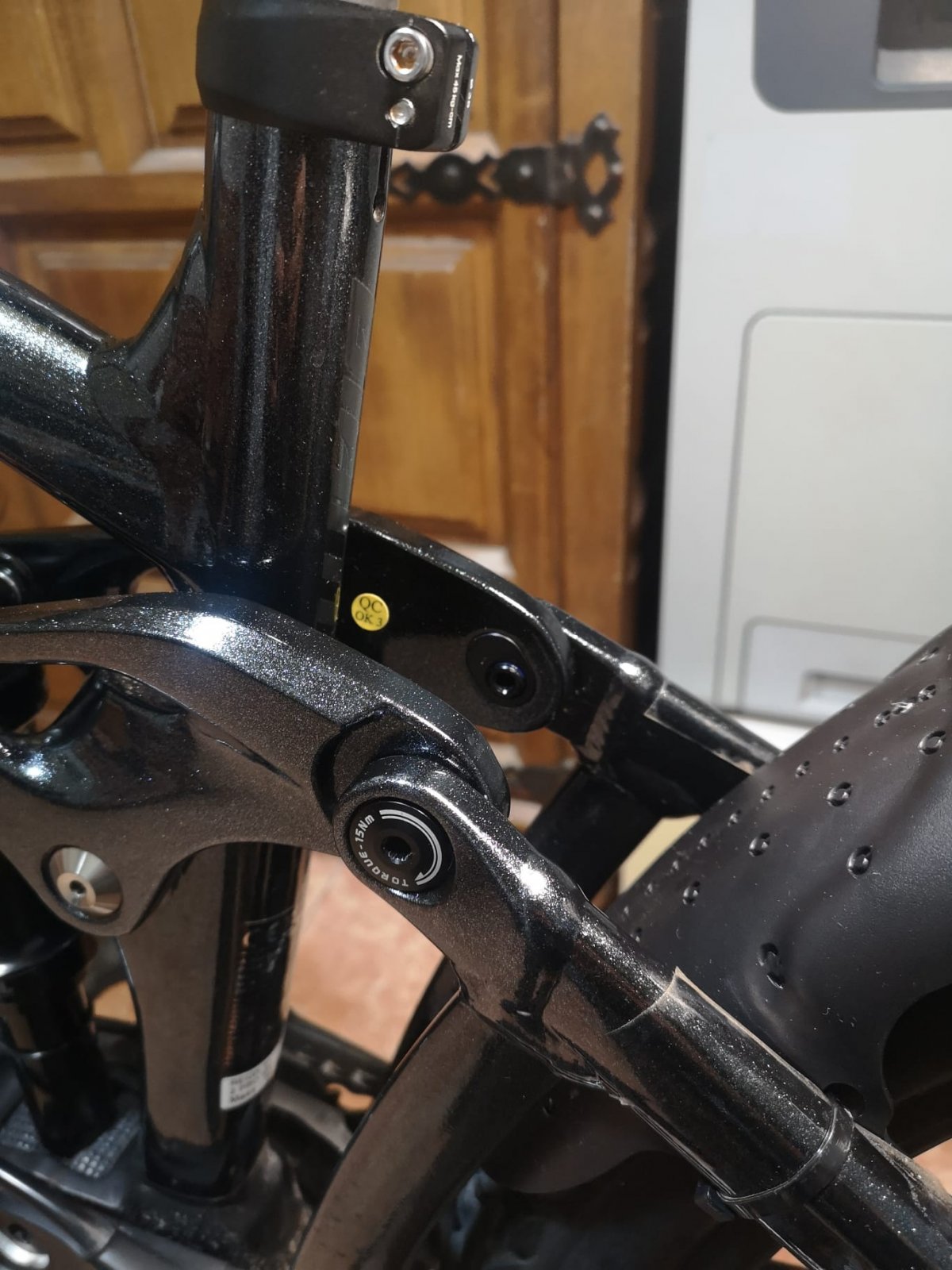

hello, someone has tried to change the "FLIPCHIP" to the hight position, the frame raises 10 mm, and the angle stays at 64.5º which is very, very good, has someone changed it and tried sensations?
