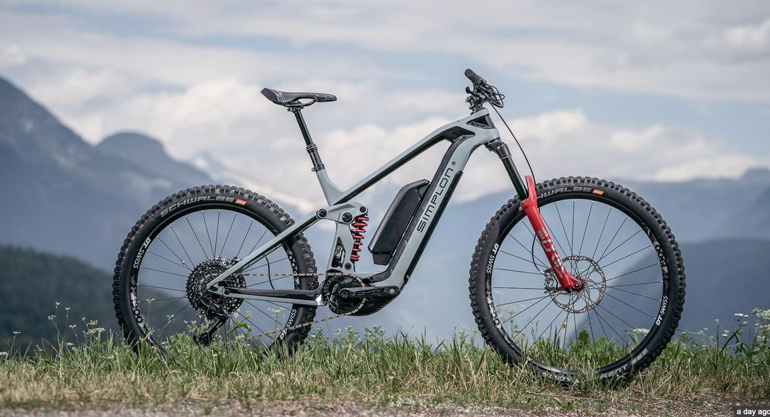

*wonders what monstrosity of a 170mm travel Emtb has a 1008wh battery*
:unsure:

Fuck me!
that actually *looks* nice!
what must it weigh though? :eek::oops::cry:
[EDIT] apparently 22.5 so not much heavier than a Kenevo with the 1125wh configuration
Wow
that's pretty amazing!
9,190
With just the internal 625 battery it weighs in at 22.5kg, which is impressive for a bike with that spec
9,190
Still weighs less with the extra battery than pretty much any of the current Bosch bikes. Lots of exciting new bikes with the new Bosch system getting announced almost daily
