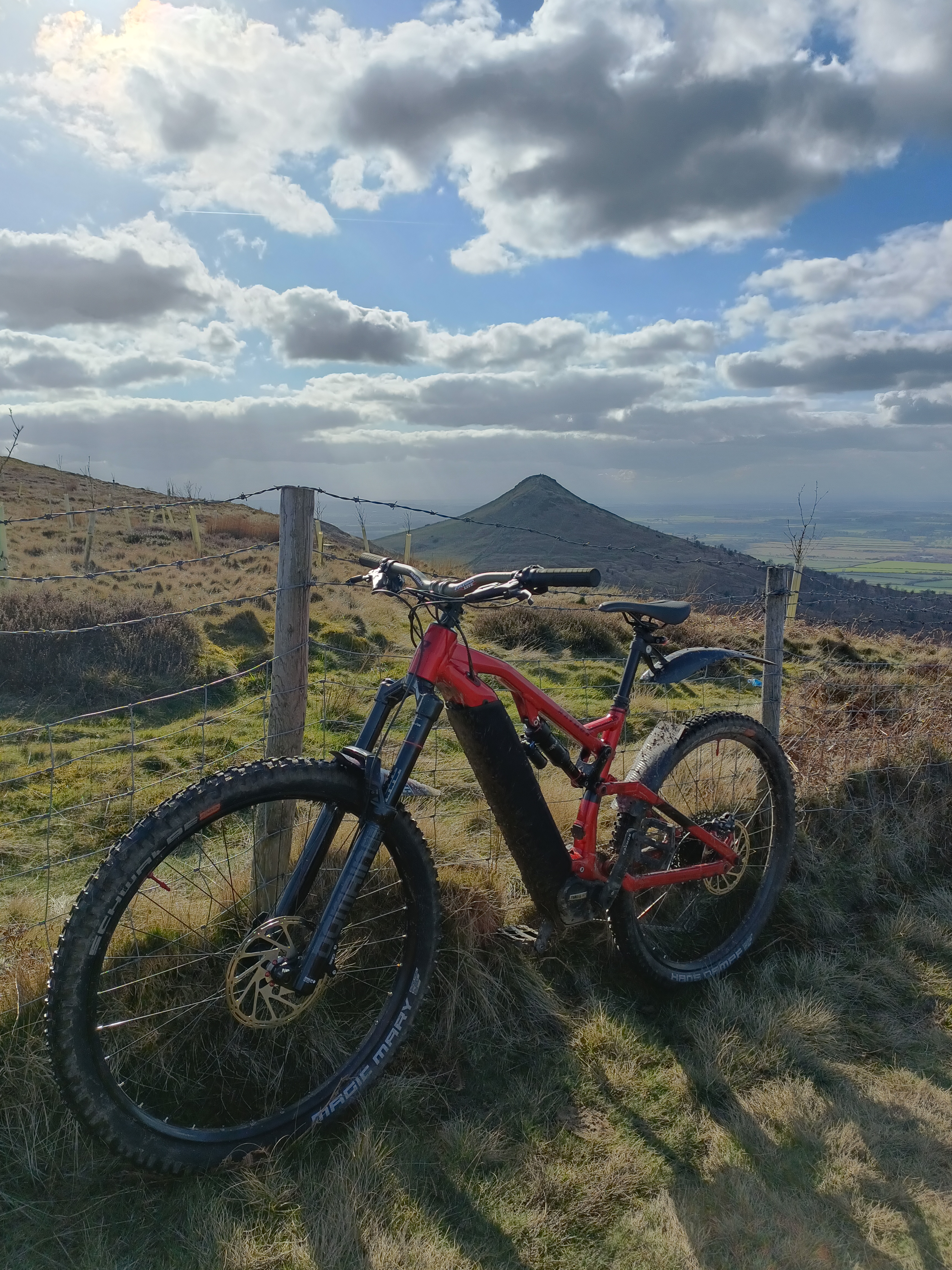

Had first proper ride across Cannock chase today, I’m defo sold on ebike ! Quickly got used to the weight as well . Disappointed however , the gears are not well indexed , will need looking at . And something rattles , not pin pointed it yet . And personal thing but not enough travel on the dropper post and I find the front end a bit low
