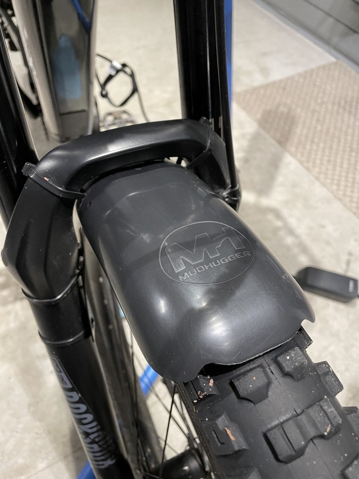

If its a Mudhugger FRX front then it DOES fit fine without cutting a bit out of it.
I've done it on my Rail 5, see my pics further up in this thread.
Your missing the point , I wanted it to integrate smoothly inside with the rear mudhugger as in the pics to stop the mud piling up on the rear pivot . On its own it would fit as yours has , but it did limit clearance a bit on muddy days
I understand, 2 different situations. I will go with front frx without the cut out. Will try to find a detachable extended seat tube gard for back protection ( like topeak xc 11) Anybody tried to attach these to base of seat post not to interfere with dropper ?
Yes they won’t work with a dropper , and it’s would be so high up it would make getting off the back the seat difficult . Plus they won’t take the rattling about on rough ground and too narrow Why not just use the proper rear mudhugger ? It’s about the only thing that works on a full suss rear end

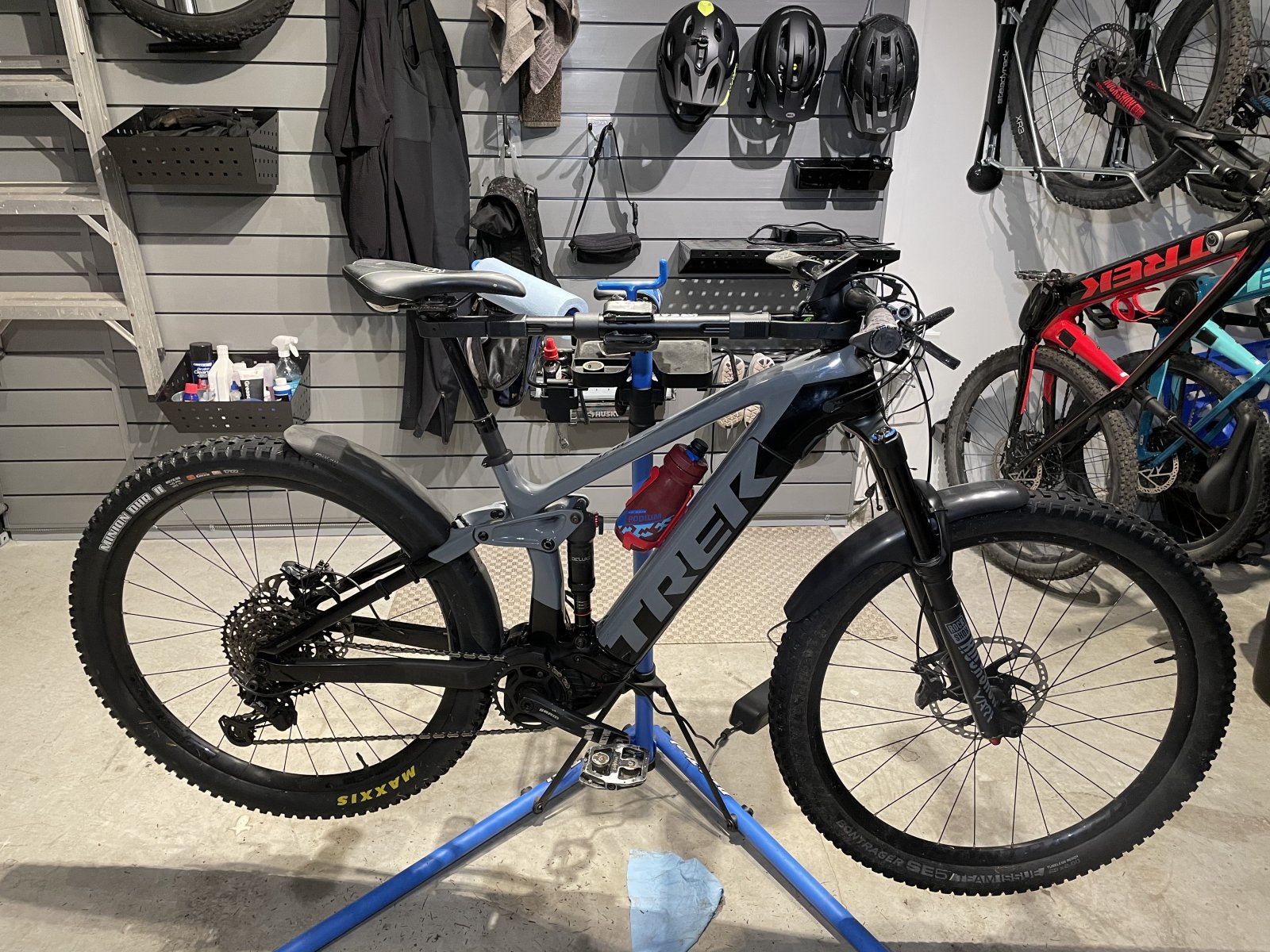

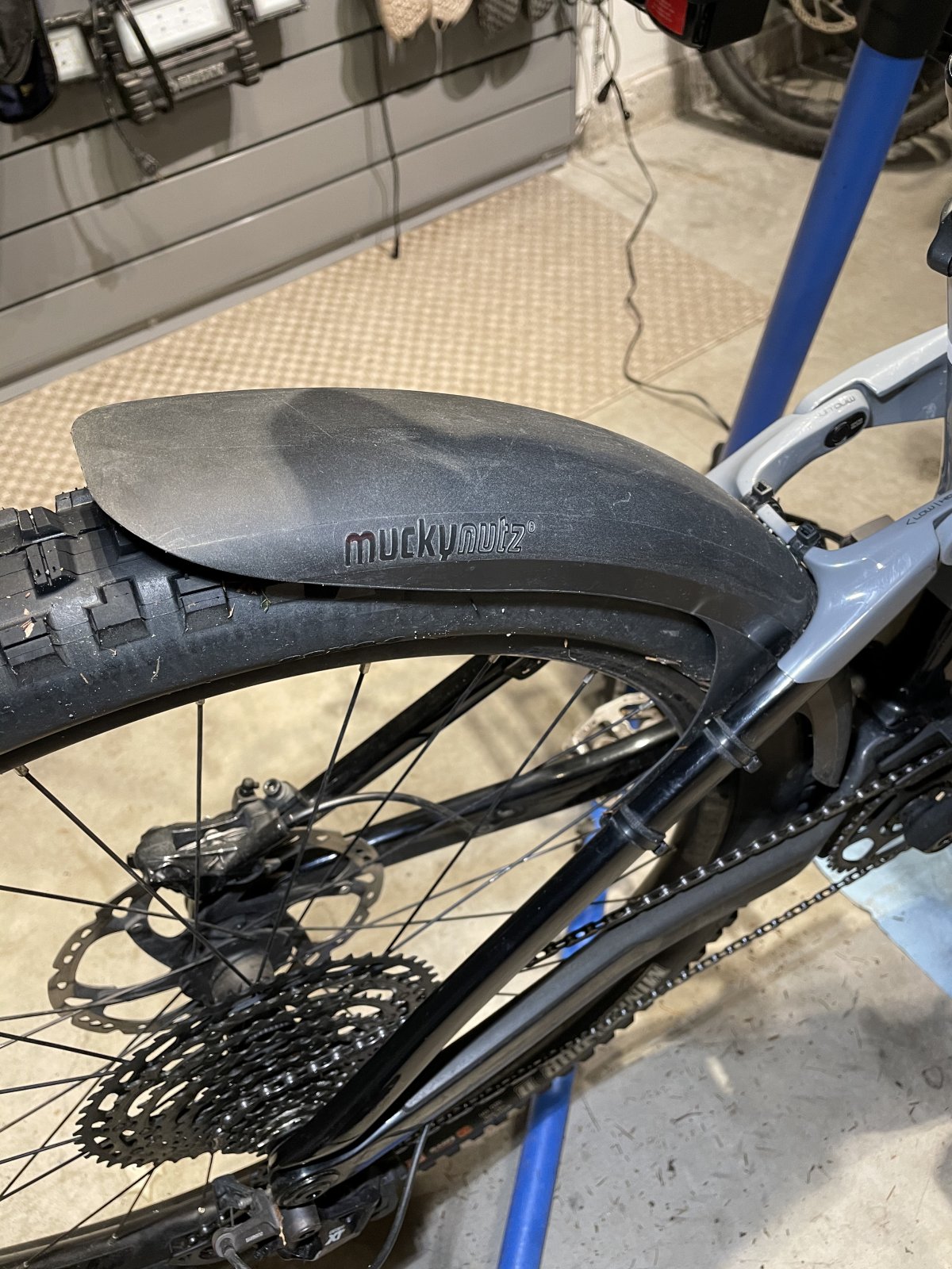

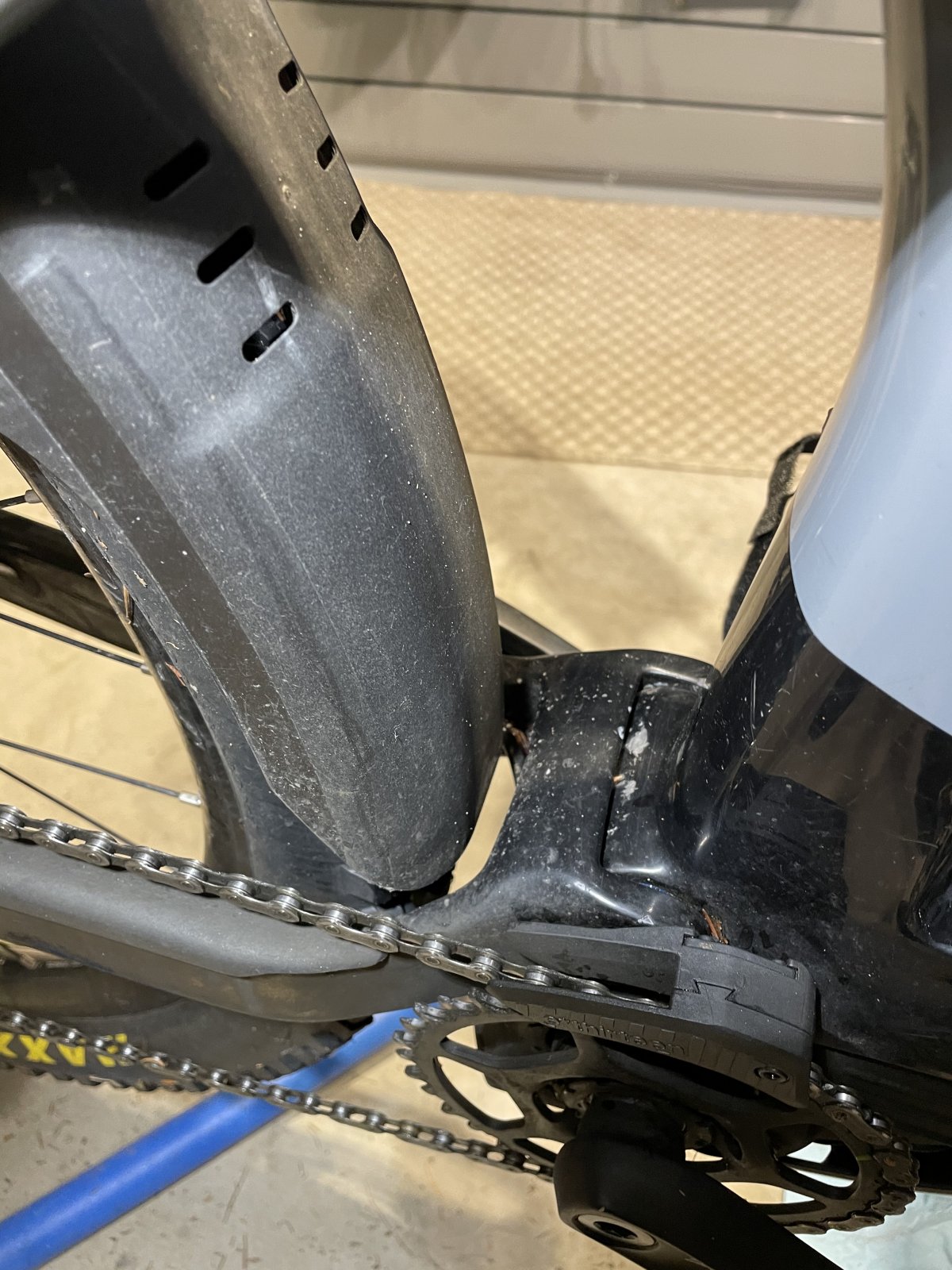

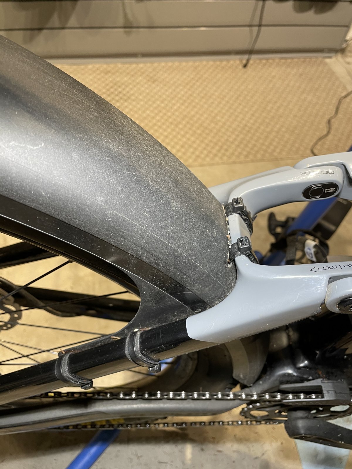

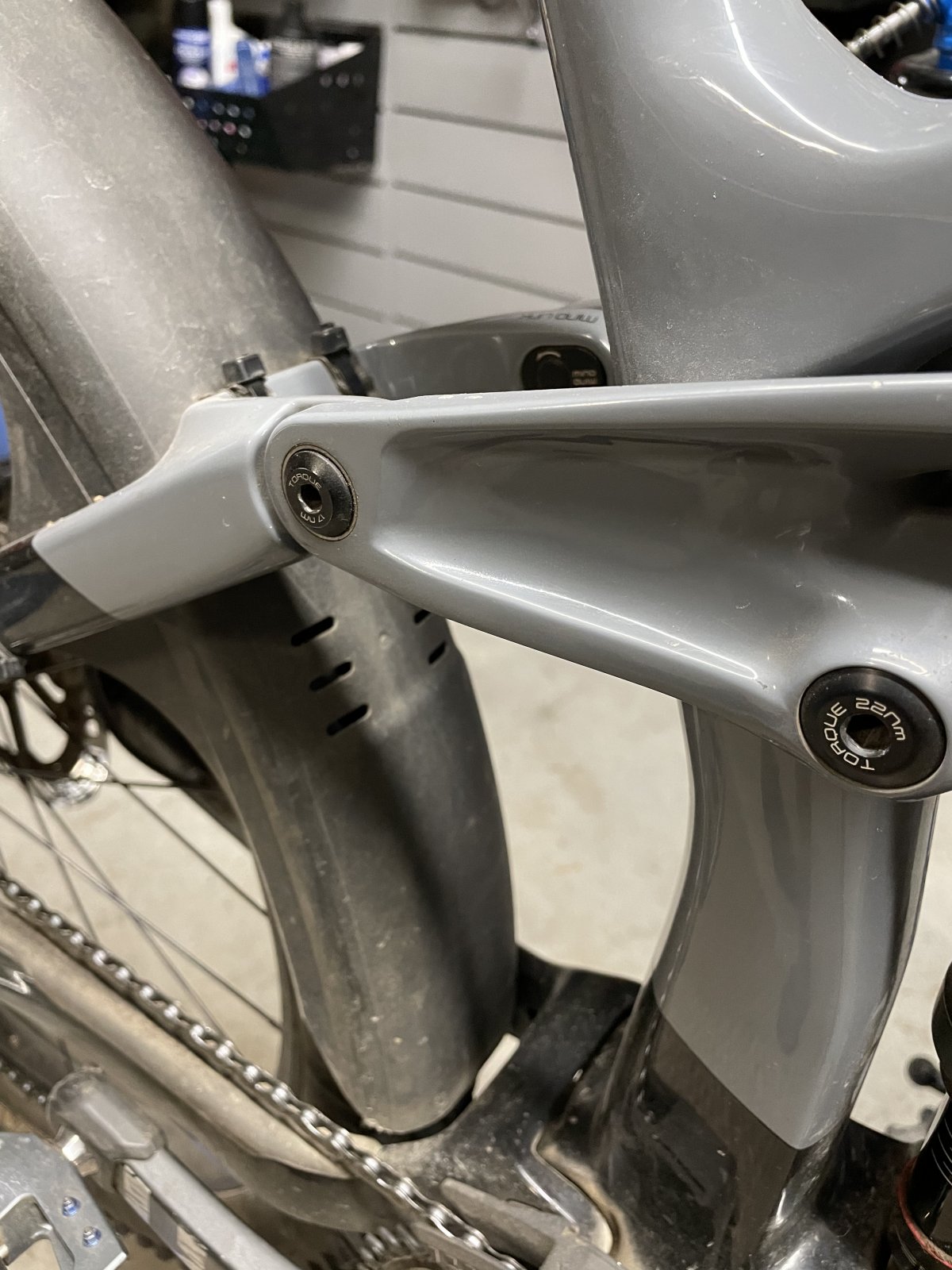

MuddHugger on the front. MuckyNuttz on the rear (slightly modified). About an inch of fender was removed near the pivot in order to fit properly. I mainly wanted to protect the lower pivot. I still get a stripe up my back and Fanny pac but the dropper is mostly clean. I like the idea of rubber mastic for frame protection.
There is a guy who is 3D printing a small pivot protector in here too. Looks interesting.

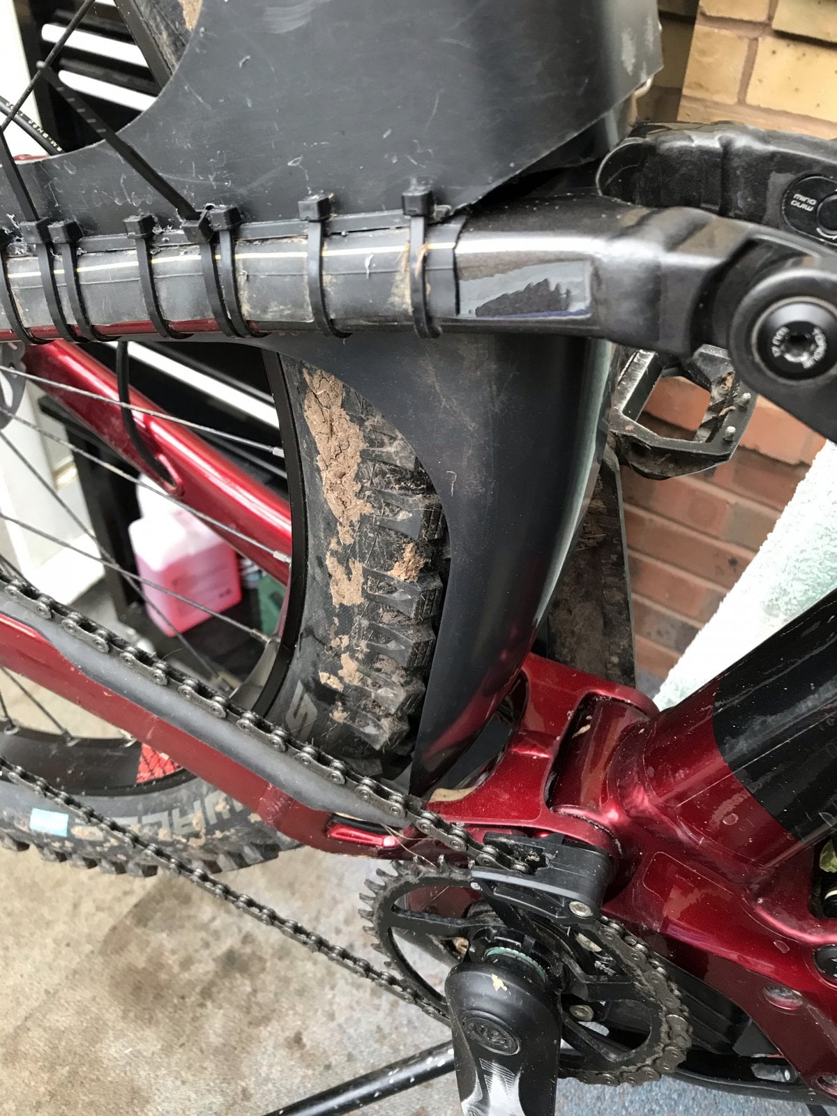

Not as muddy last weekend but you can see how the guard kept the pivot area clean. If the weather stays like this for a while I’ll be able to lose the whale tail, which is nice.

The rear fender serves a number issues for me. I’ve continued to use the modified monkey nutz rear fender to prevent some mud on my back, debris on the dropper post and a keeping perfectly sized rock out of the pivot area. So far so good. Occasionally I get a rear tire buzz (6 times since install) but I just smack it with my hand and it stops.
I have removed the front fender though for looks.
I’ve installed this exact same setup on several other Rails and the riders like this kind of protection. Modifying the fender to fit properly is key. Protecting the frame is also important.
There are a number of different fenders/pivot protection, but this method works for us.
I personally like the look now which is why I removed the front fender and kept the rear fender only. Only once I took a rock to my face from the front wheel, but I wear riding glasses.

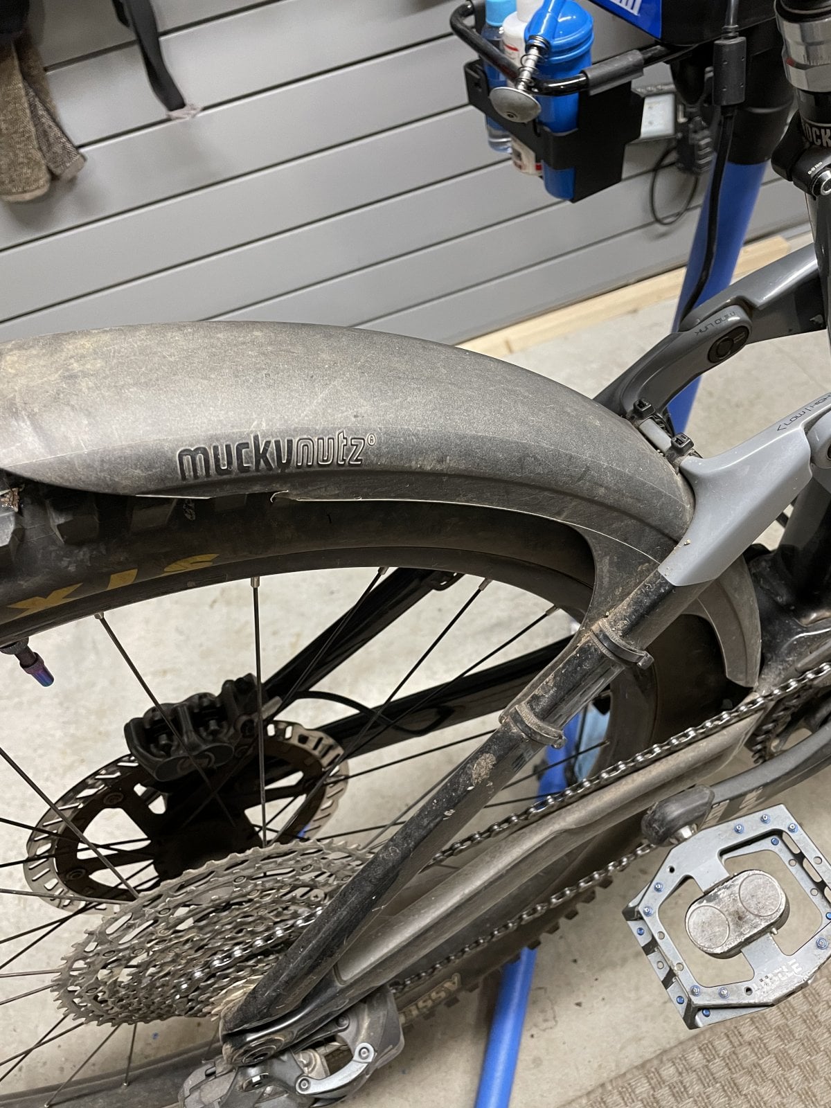

I contacted these guys last year and explained how I needed to modify the rear Mucky Nutz fender in order to fit the Rail. This design seems to be perfectly molded to fit the Rail (and now some other bikes) but I’m not sure how well it fits or preforms. Definitely check these guys out.
I bit the bullet and ordered from them. Will see how it goes.

I'd like to do the same fender setup on my Rail 7. Which muckynutz are you using for the rear?. We'll have to look around to see if mucky's are available in my area as everyone seem to carry mudhugger.
Looked at using 2 large front mudhuggers (one cut down to fit the rear) although the clearance looks minimal using the mudhugger version.
BTW, which rear tire size you running with your setup and thanks for the tips

29”.
It’s been a while but I think I used a front MuckyNuttz (modified) fender for the rear. It’s all I’ve used for the past few years. There’s a company in the UK (Simcon ? I think?) that make custom fit fenders. Those seem pretty good.

Regardless of the model, style, length, position or colour, the most important thing for me is avoiding a perfectly sized rock getting jammed or crushed in the pivot to frame area. The sound or result can be horrific to the ever moving rear suspension.
There’s been a few good design’s to protect this area and it probably comes down to personal preference or overall looks. I don’t mind the mud-juice or vegetation building up in this area because it’s less likely to cause damage. The pivot bearings have been generally designed by the builders to reduce water or debris ingress. But the constantly moving frame on a full suspension for the pivot area is not addressed …I can only speculate why. It only takes a perfectly sized rock.
I don’t mind a mud strip up my back or the occasional small rock hitting my face (I wear eye protection), but that crunching noise coming from the pivot area stops me asap. I usually clean my bike with (shower setting) water only after a ride. I haven’t used the small flap over the pivot “gap” area which is attached to the lower seat tube because I’m somewhat concerned with the cleaning process after a ride. I’ve never tried it though. If water or debris can get in this area, I want it to easily leave this area. I’m not sure if a gentle washing would do this.
