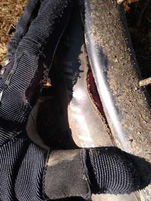

Your tyre sidewall split BECAUSE of running too low pressure
No Gary. Sidewall failed because of a manufacturing fault. Tyre was replaced under warranty. Bead separated from sidewall. I was running 22psi. Not particularly low. Point is it stayed up. I'd ran those tyres with inserts for 12 months with zero punctures.

Wrong again Gary! It was a new tyre on a different rim. The new tyre failed due to a defect. I could continue the ride because of the Tannus insert which I could not have done with tubeless. How can you possibly know the tyre pressure that is appropriate with so little information? You must be a genius. Regards Brian Age 5+1/2?

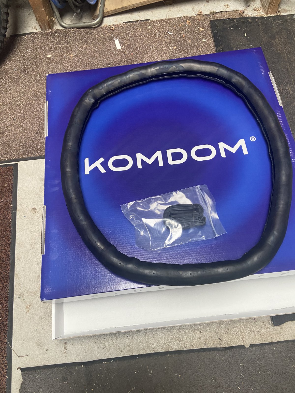

Have run tubeless with some success and some failures burping the tyre then rolling it of the bead, so progressed to Mr Wolf KOMDOMs a doddle to fit but I did serve an apprenticeship fighting with mouses on my enduro motorbike IMG_9574.jpg
