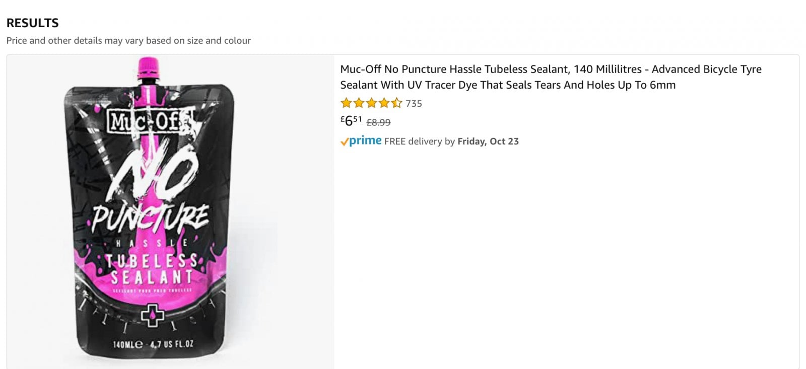

I went with these in 44mm, nice colour coding of course ;)
Just ordered these ?
Is this the sealant and if yes do I get one for each tyre.

Doug, if you haven't already ordered the messy expensive stuff, have a good long think about what you hope to achieve then decide between tubeless of tannus.
I run both in different bikes with different priorities.I advocate trying tannus before tubeless.( probably because I tried tubeless first?)
IMHO , tannus rules for puncture protection , but tubeless rules for weight / performance.
Tubeless is messy and when things go wrong it's incredibly frustrating, you run the real risk of being stranded trailside with goop pouring out of a sliced tyre and wishing you had a spare tube plus several litres of hand wash.....and you can guarantee just enough time between random flats to become a convert.....then the sneaky leaky hits
Tannus has a dead feel when riding , a bit like running too much compression dampening, and is a pita to learn to install. But the flip side is excellent puncture protection, the ability to ride with a flat tube, and even the ability to patch a flat tube / remove the tannus to get home if you decide riding on a squirmy tannus is hard work.
