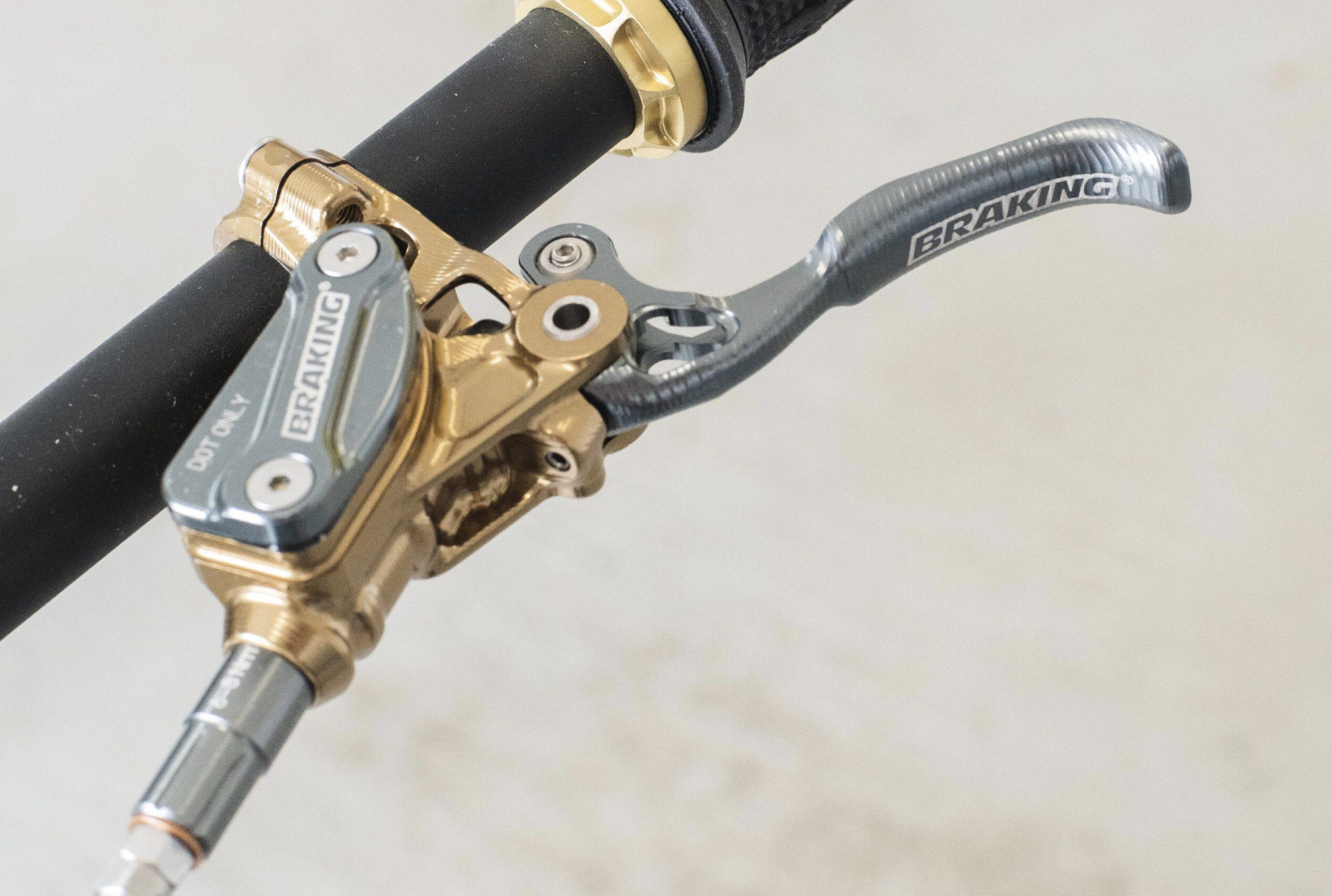

9,190
Has anyone here had any experience with Suntour Incas brakes
I did option the bike up with these and curious to get your opinion on them.
Do you mean Sunstar Braking Incas brakes?
If so Braking the company makes some of the best brakes in the Motorcycle world, and have been making MTB brakes for a while but very much under the radar, and taking a different approach to most mainstream brands. Paul Aston has a set on review at the moment
One thing they will definitely do is look the nuts on the Pole - the machining looks like it was made to match ;)
Thank you
yes thatā€™s what I was after
