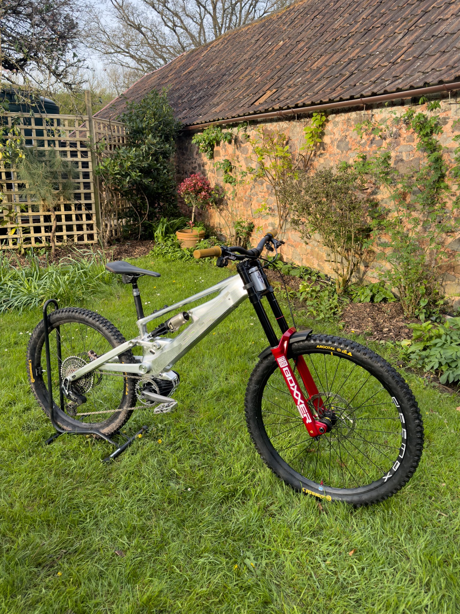

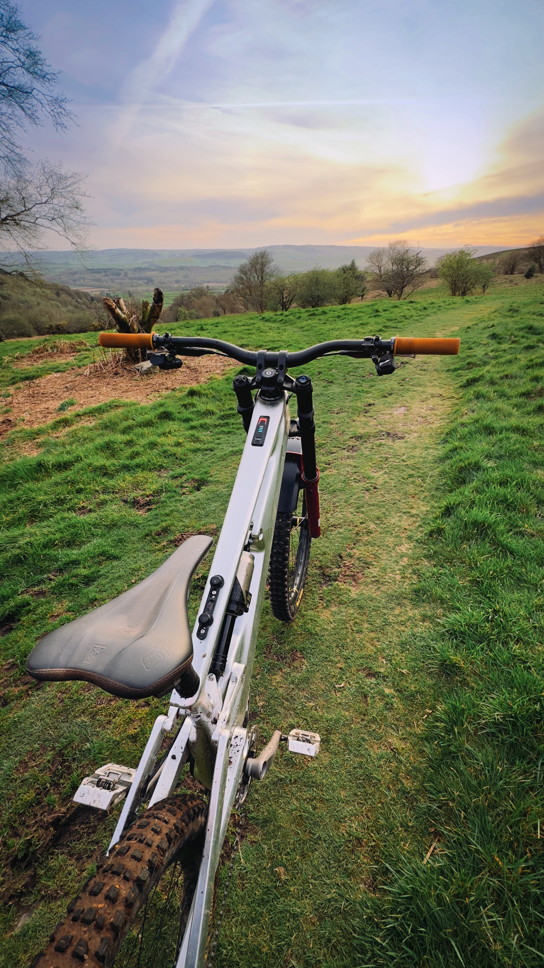

First day on Sonni. It was a great ride.
1 - Not a fan of the EXT 190mm. Maybe overwhelmed with 190mm travel on a 36mm chassis. Felt nervous. Damping was awesome, hard to use all the travel though, ultimately I took it off to directly compare it to the Boxxer
2 - Boxxer was so much better. I was much quicker on my runs, and felt so much safer out the front
3 - Bike geo is on point, and feels very different to Voima (357BB height with 200mm travel at dynamic sag point you're lower to the ground + shorter rear end)
4 - Mullet, give decent butt clearance on steeps, and probably helps with the cornering speed.
5 - EXT air shock is just "OK" - seems to get choked in the mid stroke around sag point, I expected it to feel a lot more supple. Will try a super deluxe coil next.
6 - Its way different in ride feel to Voima. feels closer to that of a 'traditional' enduro bike with massive travel (200mm / 200mm)
7 - Hayes Dominion brakes are awesome
8 - Shorter rear end and lower BB are very noticeable
9 - Still has the high anti squat, very little pedal bob when climbing
10 - the 'ballbag' disappears when riding, and at no point was I worried about getting it hit / hung up. You'd have to really be messing up to catch anything there, but time will tell.
11 - You need to add at least 30 minutes to your ride time because everyone wants to stop you and talk about the bike.

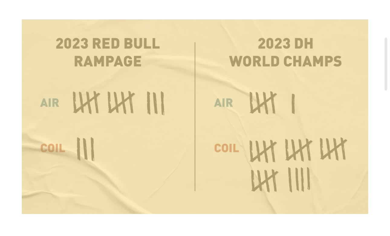

I’m pretty sure more than half of the field on WCDH are on air shocks. It’s not the travel, it’s just a preference. But air shocks are more progressive, more adjustable and easier to add or remove air than to change springs. Also a little lighter too. I prefer air shocks, but different strokes for different folks.
Here’s a breakdown from world champs 23 vs rampage.
Personally I’d take a coil over air only IF bike is suited for it. I like the sensitivity, mid stroke support and the grip levels I find are better than air on a like for like bike basis.
Well that settles it, I guess I’ll enter Rampage instead of the WC. 😂 Really though, I feel like air shocks are better for e-bikes because of extra weight of the bike and the air shock being progressive handles that better. Also because of the extra weight of e-bikes, the initial stiction of air shocks isn’t really an issue like it can be on a regular bike. But again, it boils down to rider preference. I love the X2 on mine, and since it was just replaced with a new 2024 X2, it’s even better.
Makes sense. Dh is about grip, crankworks is about pop and bottom.out
If you like more pop then airshock.
You can argue that bottom out performance is moot now with hydraulic bottom out control on coils.
Foe me, I don't have a voima for pop. I have it to charge the gnarly. If I wanted pop I'd get a different bike. So.. . Coil is the way and the light for me.
