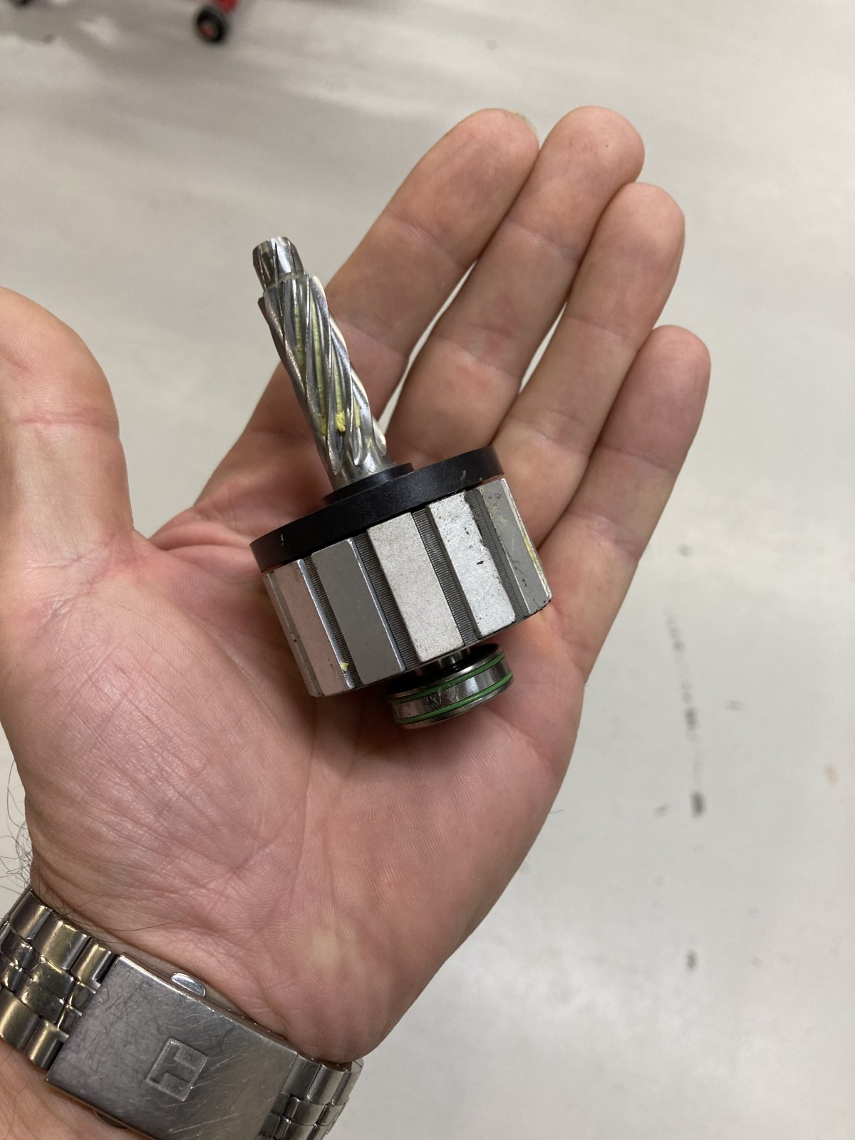

Sorry but I have to counter this. The picture below is the only thing in an ebike motor that will offer inertia. All the weight of this motor armature is very close to the shaft to allow it to spin up and stop very quickly. It weighs 300g and stops within seconds when you stop pedaling. The inertia would be infinitesimal and very short lived. Are you sure you're not confusing inertia with power?
Power is added as you add pedal force, so if you pedal less, you get less assistance but it's still there. Power is also fed in according to cadence. This comes from your battery and there is no "passive energy" it's just how mid drive motors work!
