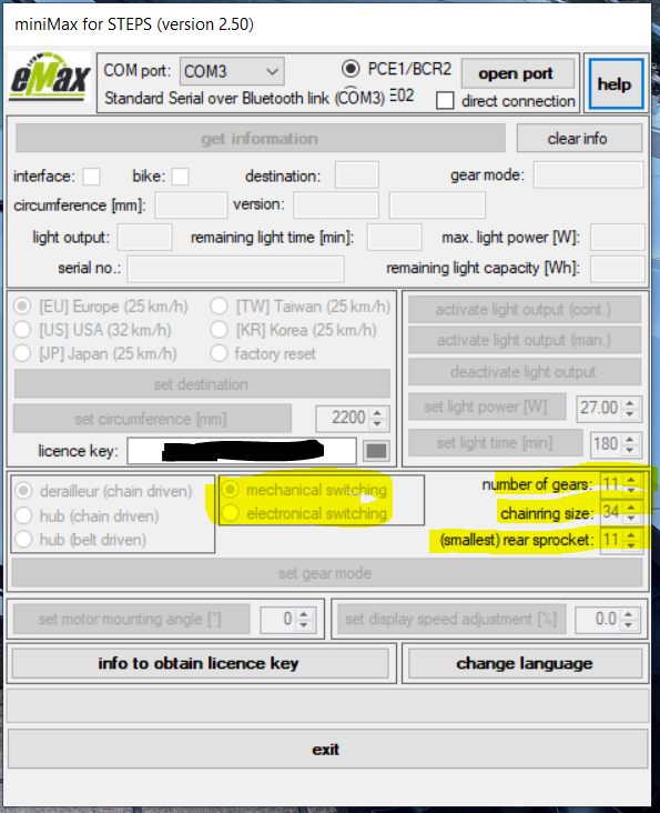

You should be able to change your shifter to electronic with current version of MiniMax 2.5. But do not attempt the derestriction till they update the firmware upgrade. About 3-4 weeks they are saying.
Below in the highlighted areas is what you need to change to set up the electronic shifting.
That is.
1) Mechanical or Electronic Shifting.
2) Number of gears
3) Chainring teeth
4) Smallest rear sproket.
You will need the programming cable. The LBS where I bought the ebike lent me the cable. I have subsequently bought the cable, as I want to stay with the latest updates.
That is.
2) Number of gears
3) Chainring teeth
Alright, I brought my bike back from the shop and was able to enable the di2 setting in 10 minutes without any issues.
Thanks for your help!

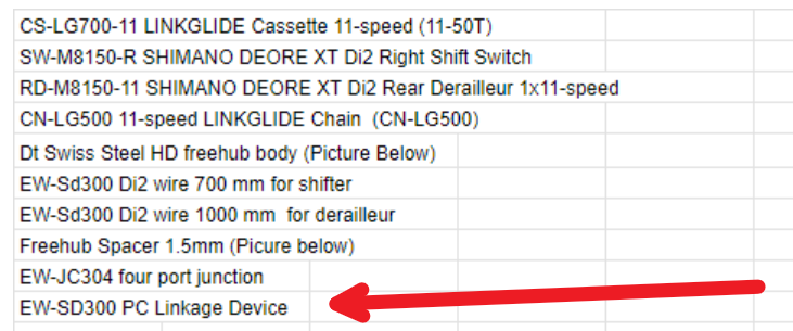

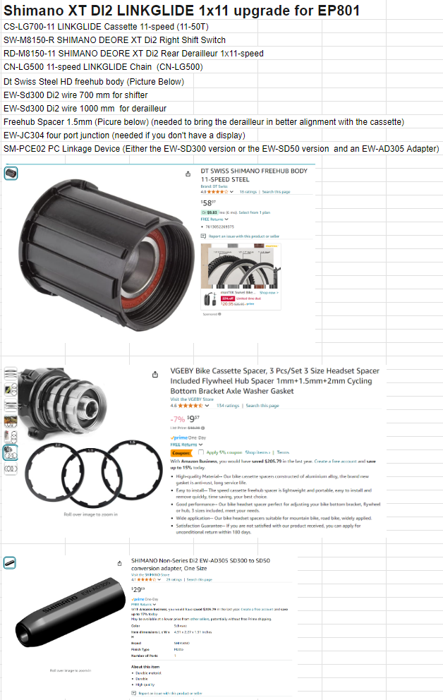

The bike I have is a 2023 Orbea Rise M10. I purchased the following bits:
Once you have all the hardware in hand Contact eMax for detailed instructions. The devil is in the details, as is said, so I wouldn't even attempt it without eMax detailed instructions. But at a high level the process includes:
- Download and install the Windows based Shimano E-Tube-Project-Professional program (necessary to be sure the correct drivers are installed before attempting to run miniMax)
- Download and install the Windows based miniMax program from eMax which is Free of charge (additional steps are described in the eMax instructions should miniMax refuse to start on your PC which is a step I had to take, and the solution works)
- connect the PCE02 interface to the 4-way connector or disconnect the wire to your electronic shifter and connect the SD300 lead to that using the same connector removed from the motor control wire during the upgrade to the electronic shifting hardware. Or connect it thru your display if you have one.
- Turn the bike on and then let it rip.
It took me a couple of hours but someone more tech. savvy could probably get it done faster.

Nice post, thanks.
However, take care, there is a major typo in your "bucketlist":
EW-SD300 is the component name of the SD300 extension cable (the ones you also have used in 700mm and 1000mm lengths), however the PC linkage device is called SM-PCE02 (not EW-SD300)!
Maybe you can change this, so there will be no misunderstanding for others.
Also there is to mention that even if the components for the electronic derailleur and accessories are quite pricey, however, the functionality to change the derailleur type is free of charge from the EMAX guys.
So there is no additional cost for the software which enables this great feature and is preventing you from going through the service nightmare with local bikes shops and Shimano. ;)
Thank you for pointing that out. The correction is made.

Yes. If you currently have a 12 speed Shimano cassette, which the 2023 ORB M20 has, it will have a Microspline Freehub, whilst the 11 speed needs a HG Freehub, and you cannot just change the freehub. You have to change the whole hub, which means re-spoking the wheel. So it's probably easier to just get a new rear wheel with a HG hub.
Don't forget you need to reprogramme the motor from Manual Shifting to Electronic Shifting, which needs the PCE02 cable. Or you can ask a local Shimano Agent to do it, but they may not want to. In which case you'll need to do it yourself, and that cable is expensive.

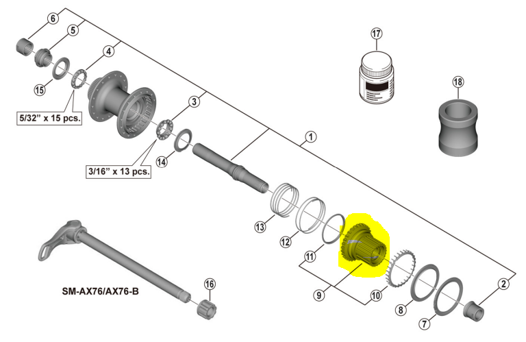

My 2023 Orbea M10 has a DT Swiss rear hub and I was able to replace the Microspline with this HD freehub. Would this work for you or do you have a different rear hub?

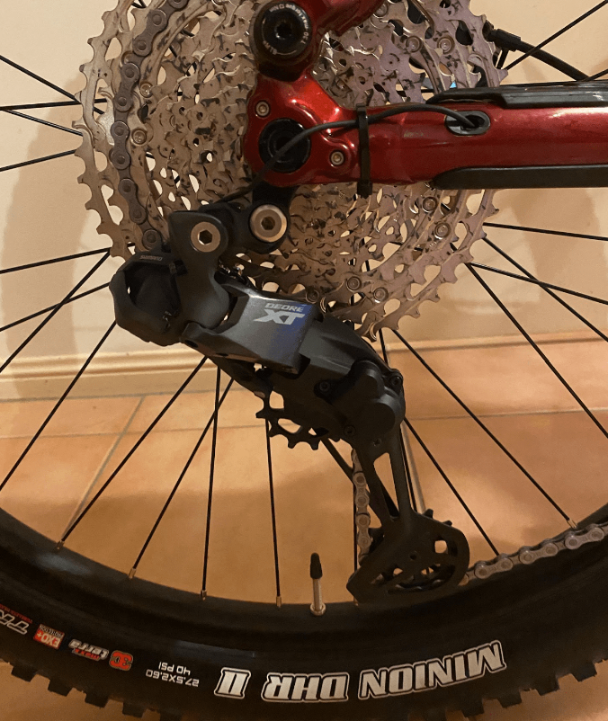

For those who have upgraded to di2 rear derailleur, any hints, gotchas, recommendations on fitting the wire?
‘23 Orbea Urrun. I will be running a 700mm sd300 cable from the motor following the route of the derailleur cable, and I’m wondering if anyone has used a rubber grommet or some such for where the cable exits the chainstay, or just leave it loose (the sd300 being a lot thinner than a cable housing).
Also best route from that exit point to the derailleur’s cable port?
Grommet and cable tie used on my Merida. No issues to date. Keep in mind. The part where the cable goes into the derailleur, is fixed. It does not move, when changing gears. There would only be movement if the derailleur was impacted, or when you adjust the B screw.
That is.
2) Number of gears
3) Chainring teeth
Question: the SC-EN600 display has three ports; currently two are in use, one to the motor, another to the SW-EN600-L. In the past I’ve used the free port to connect to the SM-PCE02.
Once I’ve got the SW-M8150 Shift Switch connected, I wont have any free ports … does it matter which component - left or right switch - is disconnected when I do the programming? In other words, should I do the programming before I connect the SW-M8150 Shift Switch? Or do I need a splitter of some sort?
Also, once connected, is it just a matter selecting the “electronical switching” radio button, then picking the correct # of gears, chainring size, and smallest sprocket?
Backflip
Nov 6, 2023
100
73
Austria
Best is to (temporarily) disconnect the right hand side SW-M8150 shifter for the gears when changing the correct gear mode setting with the miniMax - program, because this way you still have the left hand side SW-EN600-L remote to power on the bike. The shifter is not needed to program the correct electronic derailleur type to the drive unit.
And "yes", select the appropriate correct setting for “electronical switching”, the correct number of gears, chainring size, and smallest as well as largest sprocket size in miniMax and then finally press the related button to program these new settings to the bike (drive unit).
If your derailleur then does not work after power off and power on the bike like expected, you most probably have forgotten to insert the cable from the SW-M8150 shifter back to the display. :LOL:
