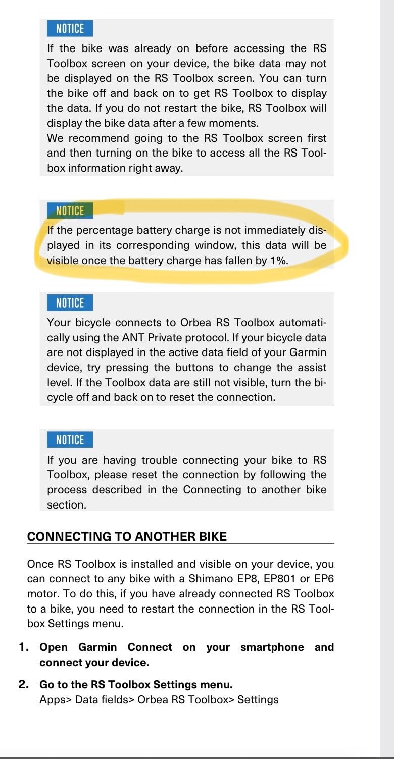

Hi there. I am Orbea Rise 2023 user. For some reason I cannot see battery percentage level. All other fields work fine. Any way to get it read on my Garmin?
anonymous.dzordz
Oct 13, 2024
16
Poland
Ok folks. Got the battery level working.
Pro tip: Read the manual 🤣
