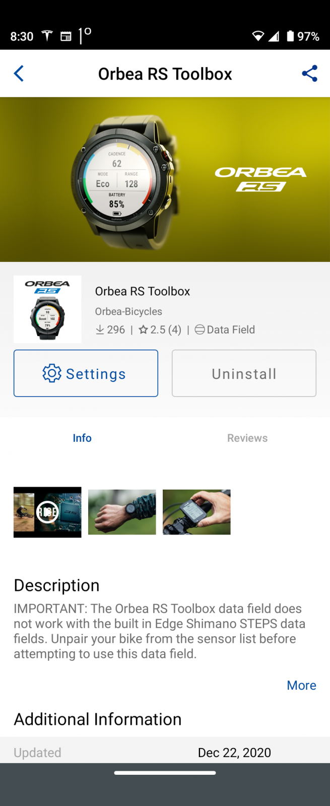

I've been having the same problem with my new Orbea Rise M10 and Garming 945. I get a message "Orbea RS trial is active" and when I try to use a toolbox data field it shows "Unlock the app at Garmin IQ". There's no option to unlock the toolbox on my Garmin IQ. Does anyone have any idea on how to solve this? My bike doesn't have a display.

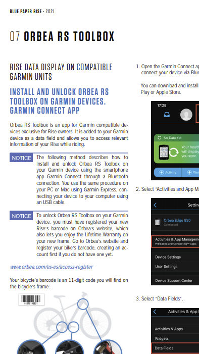

It looks like the link to the manual on the Orbea Toolbox page of the Garmin App Store no longer works :)
This one seems ok though: https://www.orbea.com/downloads/products/RISE_2021_BLUEPAPER_ES-EN.pdf
If you look at page 25 to 27 then it tells you how to unlock the app. Have you been through all that?
I had this same issue , I deleted it , cleared cache on my phone and tried again and it worked second time

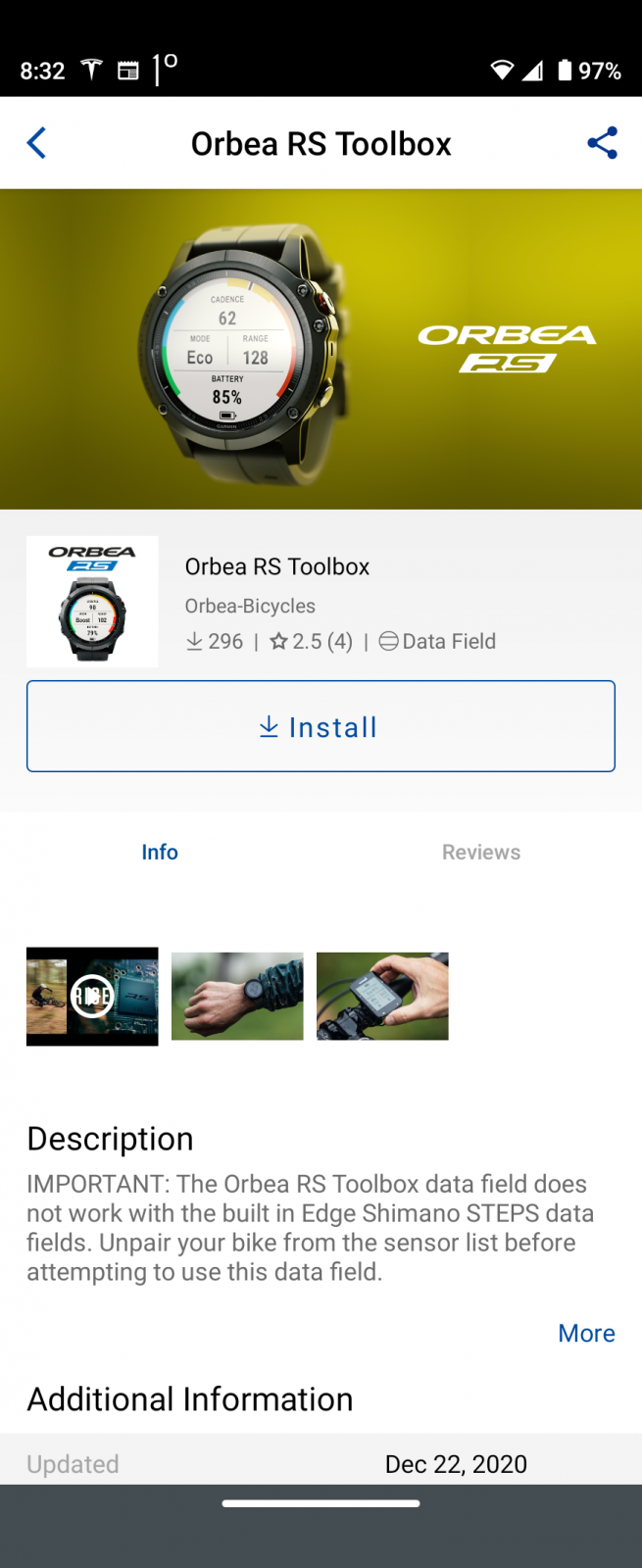

I did everything you can possibly imagine. I followed those instructions etc. My Garmin IQ app doesn't give me an "unlock" option. See pictures below:
What's is your Garmin device please? Did you have the option "unlock" on your app? Thanks

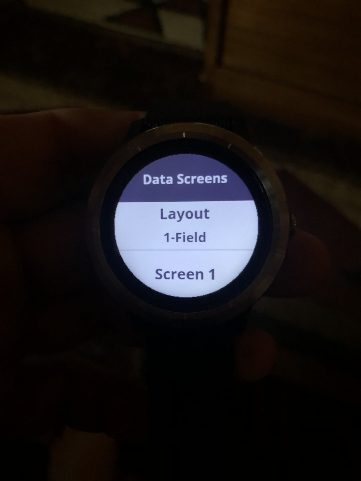

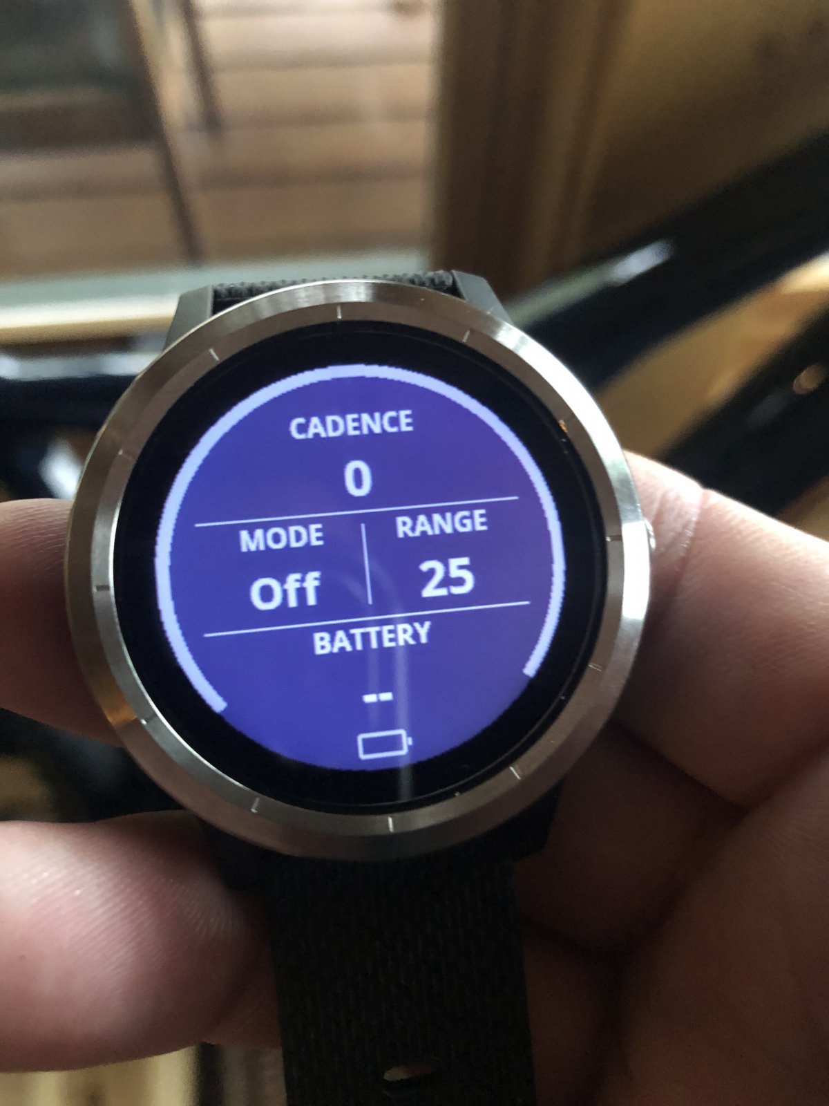

I've got the Vivoactive 3 Music watch . Initially I had same issue as your showing , I uninstalled it all and started again and got the unlock option where you sign in to Orbea website on the Garmin iq page your showing . Have to say it was a pain in the arse and took alot of messing about , it still doesn't connect everytime I switch the bike on either . If I dared deleting it all and going through it again to help you out I would , but it's working so I darent chance it lol . I'm assuming you've registered your bike warranty etc with Orbea ? Unlock takes you to the Orbea website if I remember correctly .
Thanks for the info. It's a hit and miss situation. I tried to use the IQ connect on my Ipad (instead of my Android phone). I think that fixed the problem. I was able to connect it to the bike, create the fields on the MTB activity and now is working REALLY WELL. It connects everytime I turn on the bike and show everything I need (cadence, mode, battery etc.).
Cool , glad you've sorted it ?
