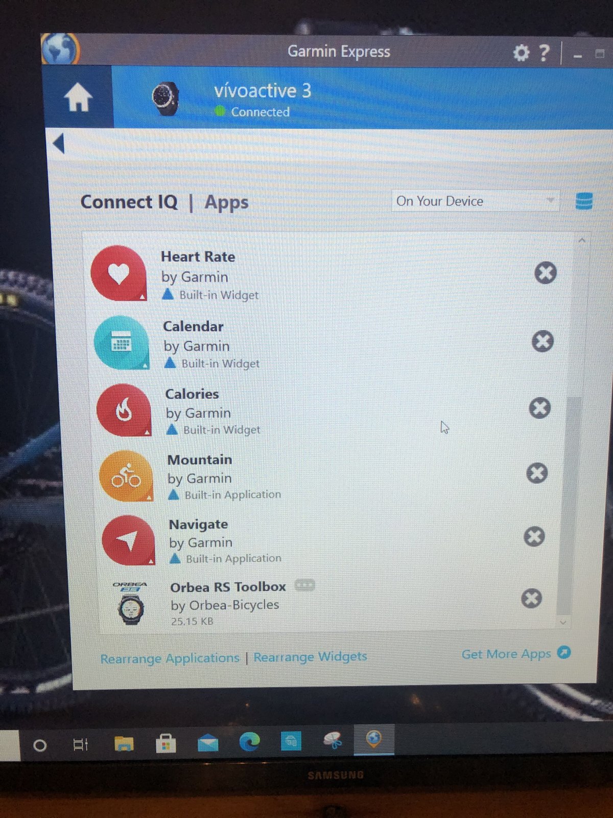

That screenshot from Garmin Express shows it is successfully installed on your watch.
In order to view the data field on your watch you need to add it to an activity, and then start that activity: can follow the instructions from page 28 of this document: RISE_2021_BLUEPAPER_EN-ES_FV.pdf (orbea.com) - it may also help to check the manual for your watch too for specific instructions for how to customize activities on that device.
Thanks for the reply, I’ve been all through the blue paper instructions, the only thing I didn’t do was ride the bike, I have no handlebars yet! I started the bike activity, but maybe since it wasn’t moving it didn’t sync? I did not see the screen they advertise with battery, range etc.

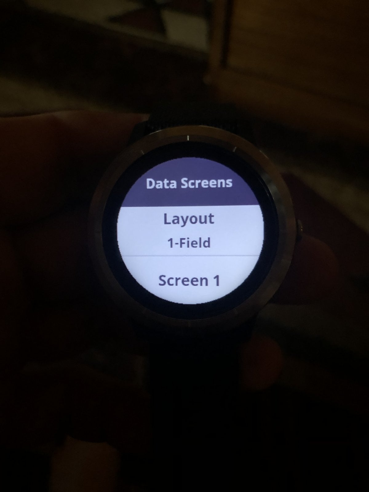

I couldnt add the data field, it wasnt anywhere on my watch. I created a "MTB" activity and was hoping it picked it up. I will say the whole deal is zero user friendly.
Yep very little is automatic with Garmin, so "hope" doesn't work unfortunately :) They aren't user friendly at all as their main focus is on battery efficiency and plenty of stats for athletes etc.
I just tried adding the Orbea one to my watch (Fenix 5X+) and it worked ok, but it's a technical process and tricky if you're not familiar with doing it regularly. These are the steps you should be looking to go through:
  • Choose the activity you want to add the data field to (or create a new activity)
  • Open the settings for the activity (for me it is hold left middle button while the activity is selected)
  • Go to the "data screens" section of the settings
  • Add a new data screen (last option in the list) - only gets created once you go through all the next stages (so don't back out). You can always edit it again later too.
  • Choose Custom Data
  • Choose the layout to only have one data field on the data screen
  • Choose the Orbea RS data field as the one you want to use (it will be listed under ConnectIQ fields)
  • Move the data screen up or down in the list (or leave it where it is ... this step is just confusing ... press select button top right and should be added finally)
For me after doing this, that activity then says "Orbea RS Trial Is Active" and going to the correct data screen it says "Unlock in Garmin IQ Store" - but it will hopefully work for you :)

Awesome help right there. So where my watch falters is when I go into Data Screens, I am only offered, 4 screen faces, I don’t see custom. I’ll unpackaged and try one more time. Thanks for the great write up, I’m sure this post will help many in the future. Happy New Year!

Mark, I think I got the SOB! Thanks again for your help. Check it out, my Garmin IQ mobile app still saying in Q for download, while it’s on my watch already. It was searching for my Rise and when I turned it on it was all there.
Cool ? Hope it works now!
It looks like you have a touchscreen watch display? So the menus and navigation may well be different from mine as I just have buttons.
