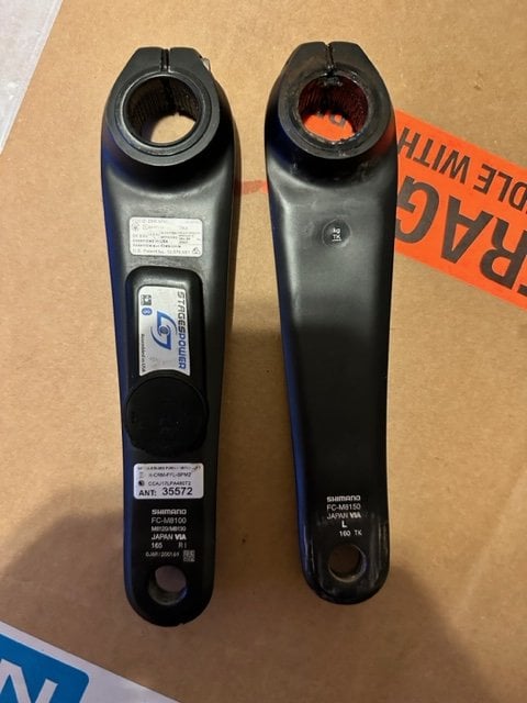

FYI I was able to install my Stages m8100 left power crankarm on my Rise H15 w/ a FC-m8150 rightside crank arm. Pictured are my 165mm Stages Arm w/ a m8150 Ep8 arm. They were so similar I purchased a matching 8150 right arm off Amazon to match the Stages power meter.

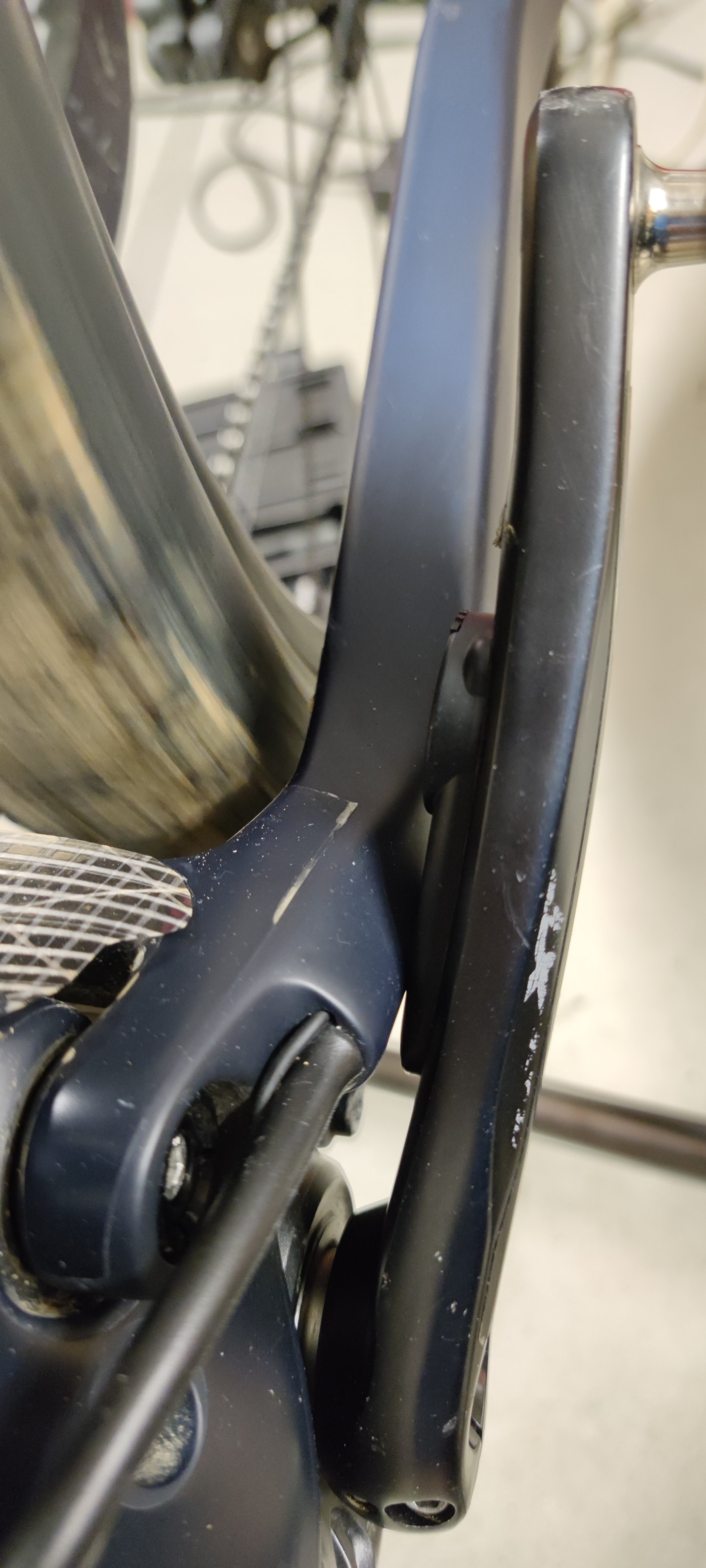

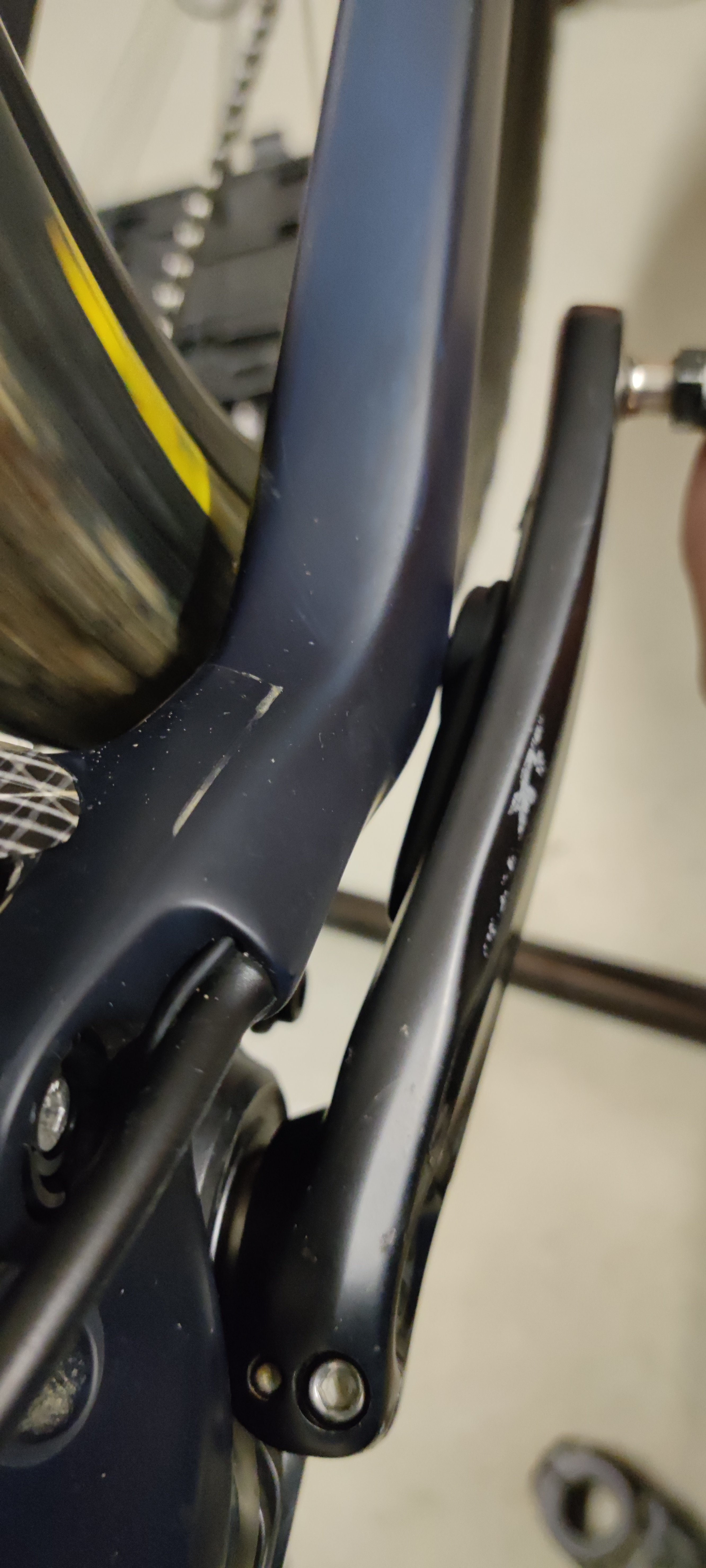

Hi,
after reading this, I bought a used fc-m8100/8120 crankarm with stages powermeter. And it doesn't fit. My Rise is a M10 XL and my crankarms are 170mm. But by the looks of it, I cannot imagine 165mm would make any difference. The flatter part of the stages-housing touches the first part of the chainstay where the cables come out and the thicker part, where the stages-battery sits, has no clearance of the chainstay at all. I estimate it's to thick by 5-8mm.
BiGJZ74 Can you post a picture, how it fits your bike?​

Hi,
View attachment 103403 View attachment 103404
I had a 5mm gap on a Rise H15. I wonder if the carbon frames are a touch wider in that area? before trying... check this Power Meter Compatibility

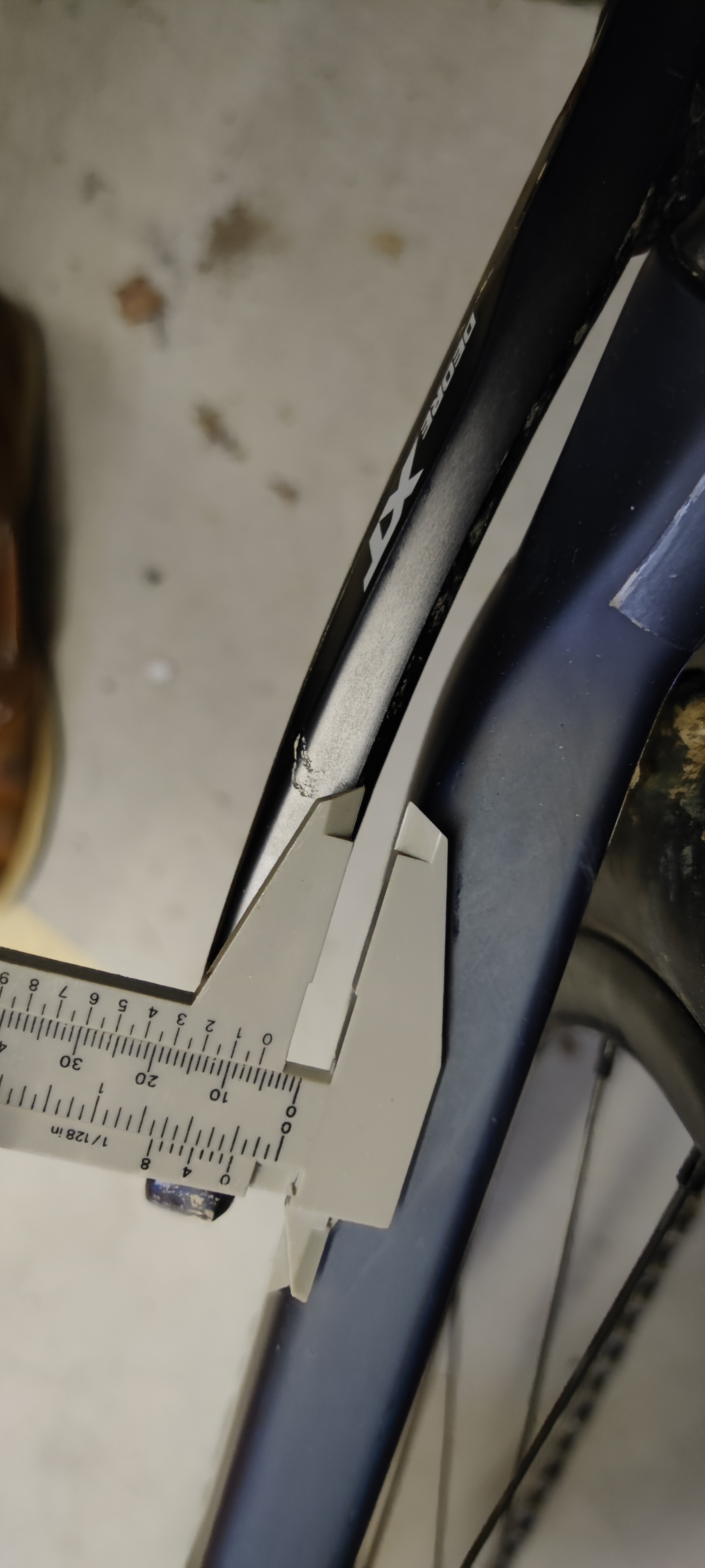

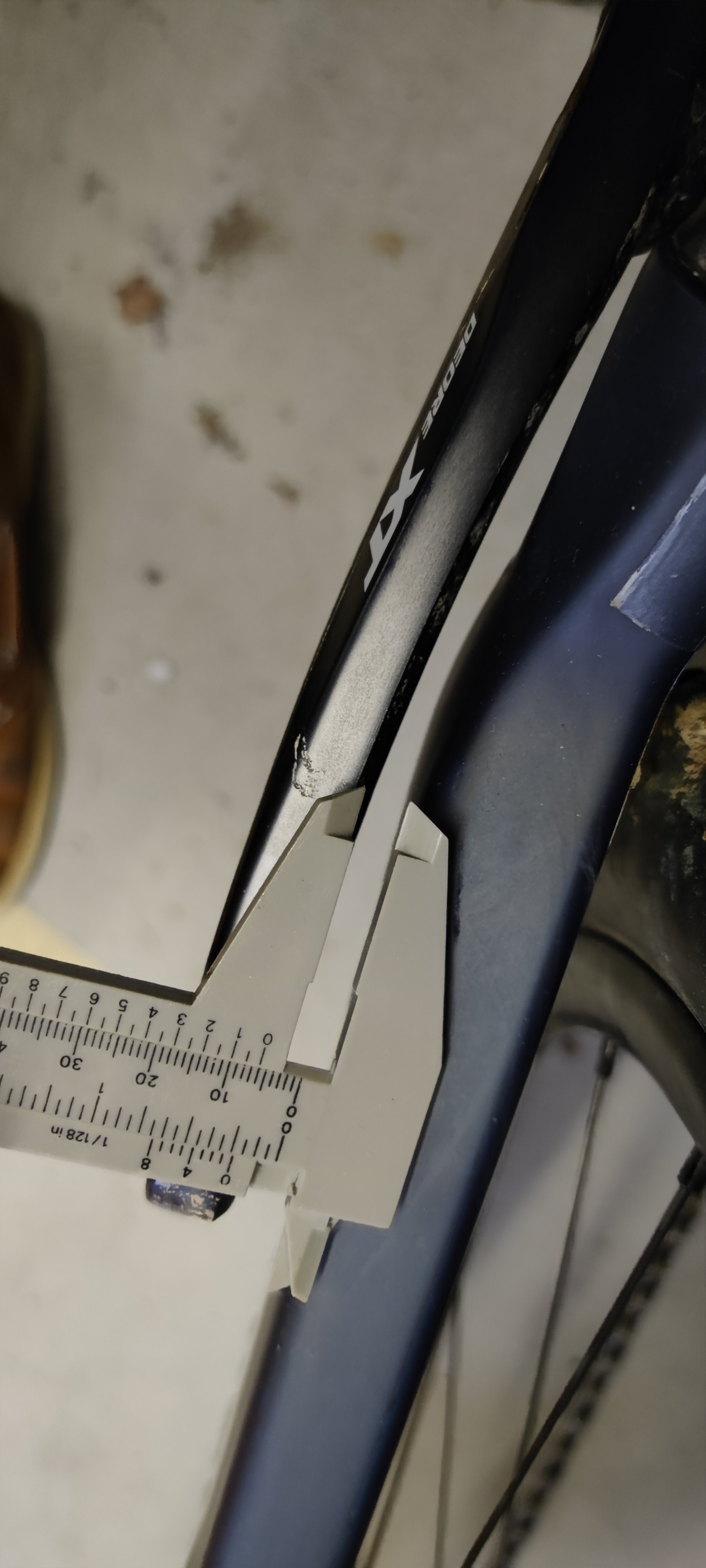

Thanks for answering. Seems like carbon is different in this area, maybe it's just chainstay diameter.
Here's a picture of my bike without the powermeter crankarm. I have only something like 6mm clearance (opposed to the 10mm recommendation from stages).
But I tried to come up with an uncoventional solution :) I tried fitting the stages powermeter crankarm to the drive side and put the driveside crankarm on the left side. The powermeter crankarm fits with some clearance on the drive side. So I took the bike for a quite spin around the block. But the powermeter wouldn't work on the wrong side, it simply showed 0 watt and 0 cadence. And as expected the pedals got loose after a while. (to doublecheck if the powermeter is working at all I even fitted it to my analog bike - this time on the correct side - where it worked flawlessly)
bottom line: lesson learnt
