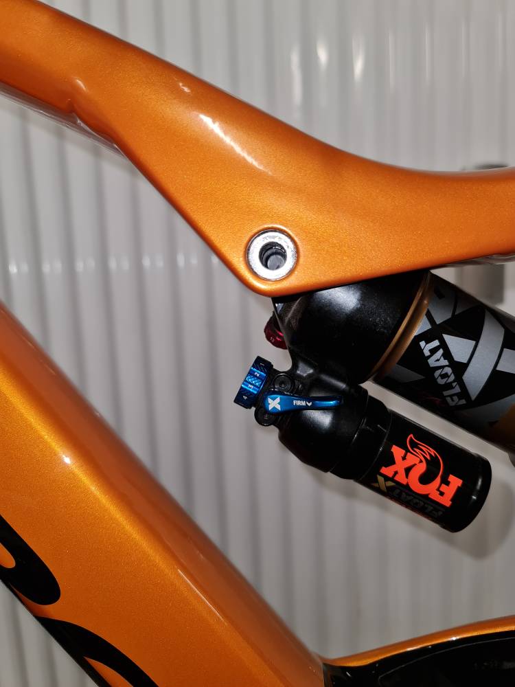

This has just happened to my Orbea Occam. The bolt just snapped on landing a 1m drop. The problem now is getting the remaining (theaded end) out (it does not go all the way through but bolts into the top tube).
Any suggestions on how to do that?
Thanks View attachment 120289

............. The problem now is getting the remaining (theaded end) out (it does not go all the way through but bolts into the top tube).
There are extraction tools that look very much like a drill bit that spirals the wrong way. You also need a drill that has a reverse gear.
First thing is to drill a small pilot hole with a conventional drill bit. That will give the extraction tool something to bit on quickly, rather than skittering about on the fractured surface (you might have that problem with your pilot drill, so try a centre punch first to make a start).
I know you said the bolt does not go all the way through, but can you actually see the other end of it? If so, you may be lucky. Just drill through from the other end with a conventional drill bit and the drill set in the normal clock wise direction. If you are lucky, the torque from the drill will unwind the broken bolt.
Thanks. I do have an extraction tool actually.
I can only see as much is shown in the photo, from the one side. I'll give that a go
Agreed but there is something you could try first. Remove the bottom shock fixing so that any pressure on the remains of the bolt is alleviated. As you move the shock now through the available amount of travel does the bolt stub remain still or does it rotate with the shock.
Whilst severe bottom out may shear the bolt it appears to me that more often the reason for breakage is that the bolt has come loose maybe because it is seized on the bushing. When unscrewed slightly the weakest part of the bolt........the beginning of the threaded section.......is then taking the strain.
With the back end of the shock unbolted you may find that the stub is in fact loose/ partially unscrewed. If that is the case you may even be a ble to lever the shock to one side a little and unscrew the remains of the bolt by putting some pressure on it with a punch or similar when moveing the shock clockwise and removing that pressure when moving the shock anticlockwise.....................or by glueing another bolt to the stub with araldite or super glue ( not hugely strong so only worth trying if the stub is in fact loose.

Thanks for the suggestion. Good to know possible causes. I just bought the bike used, in good condition, rode it just once before. It is a possibility that the bolt had become loose, but I did bottom out when it snapped, most likely that is the cause. Will need to adjust the travel.
