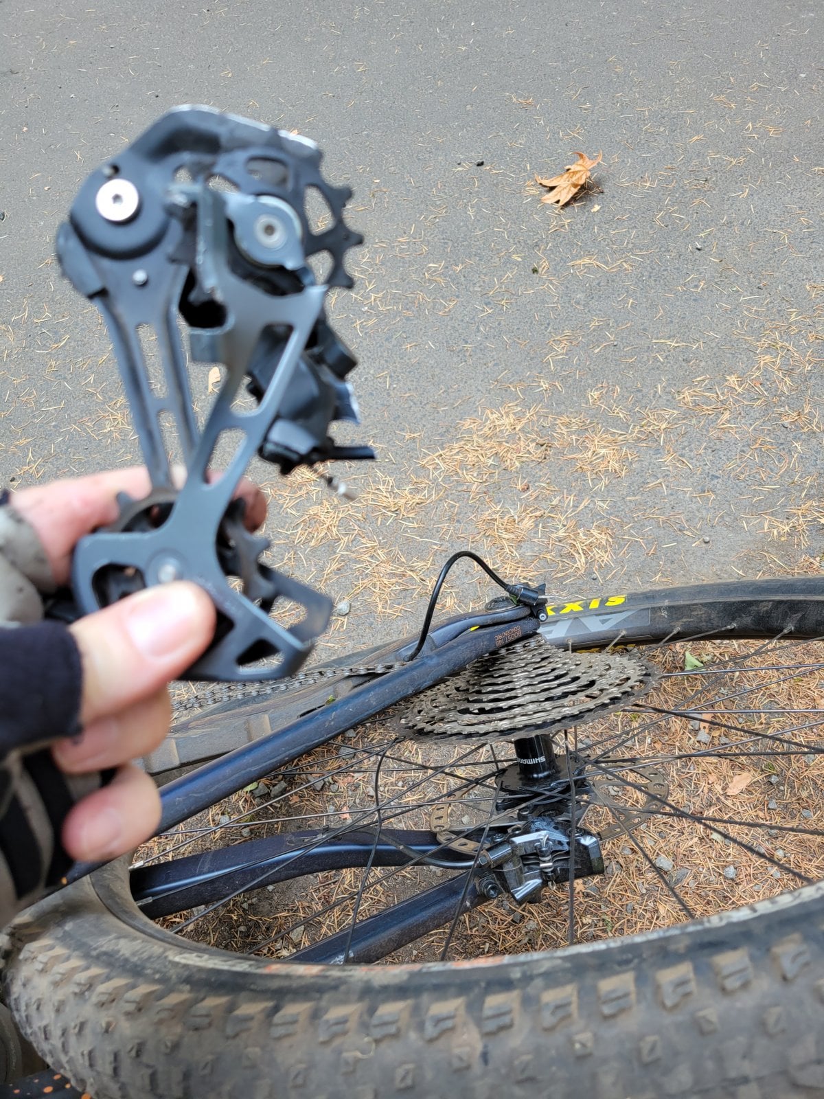

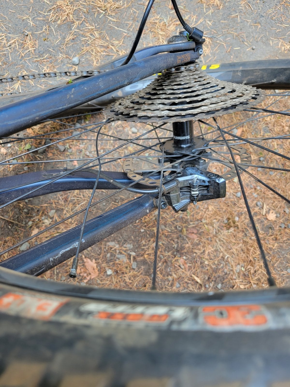

Well crap..bike is 2 months old. I was riding down walking path heading to the trail when I have massive component failure....the damn derailleur came completely off the bike, pulling out spokes and cracking the frame....damn my luck.
I really don't think I hit anything and the bike was shifting perfectly right before....wish I knew what happened.

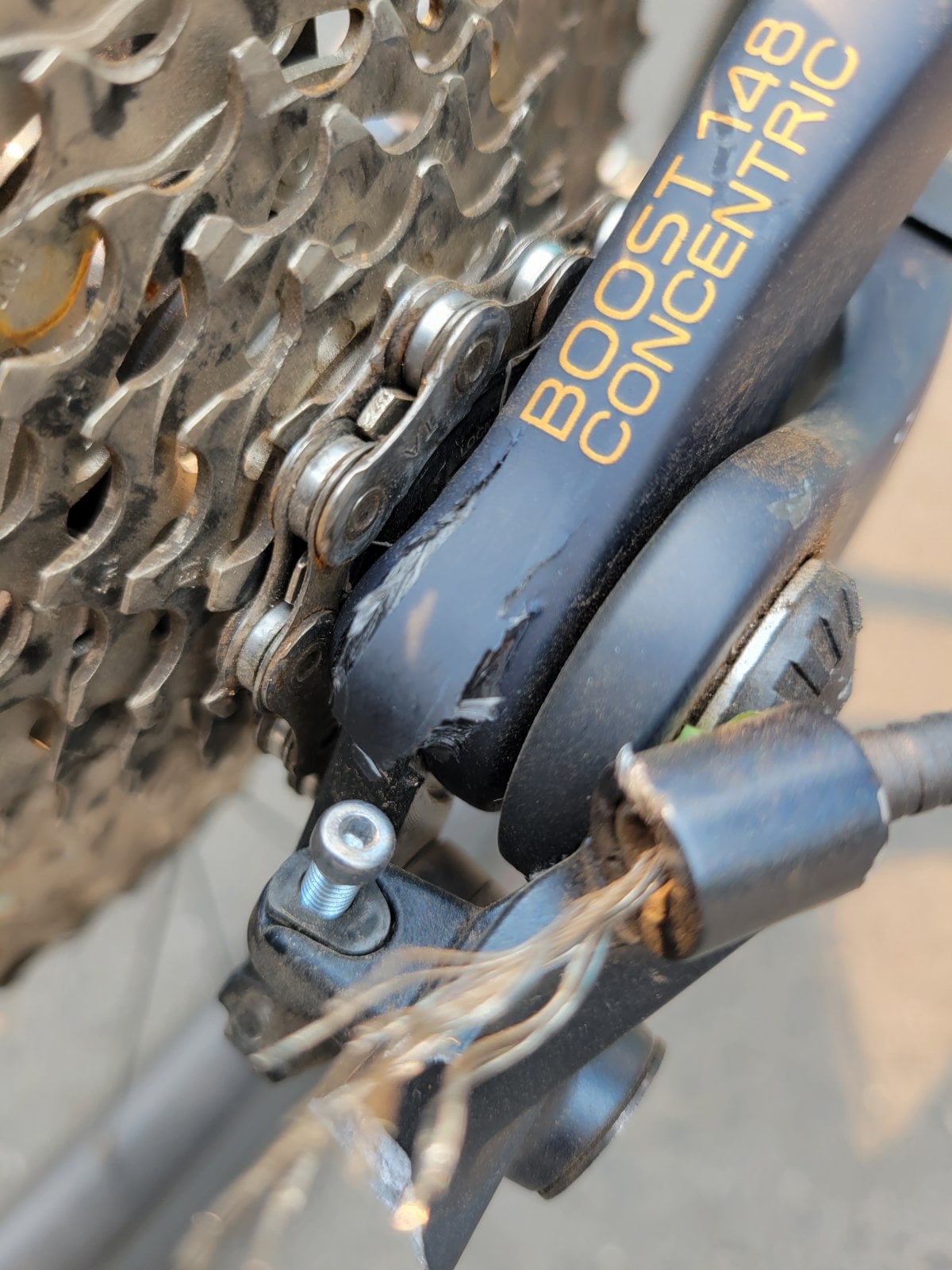

Did the derrailuer hanger not come off? They are designed to fail in a bad enough impact so as to avoid damaging the frame.
Cant see how that would have happened without some sort of impact, but would definitely take to dealer as from the pics (which aren that clear of the hanger) it seems odd it didn't fail as designed.

That is very, very odd. Are you sure that nothing got caught in the chain and sucked into the derailleur, like a small branch that got kicked up or something? Hangers are designed to bend laterally (if the derailleur gets hit), but in this case it looks like the hanger rotated axially around the axle, as if something caused the derailleur to lock up while pedaling at high speed.

Had you made any adjustments to the B-screw on the derailleur? Also, your drivetrain is pretty clean, but I do notice a little rust/corrosion on the cassette and chain; is there any chance the jockey wheel bearings had ingested some water and seized or were not running smoothly? When in the smallest cog, there is not much clearance between the cog, the upper jockey wheel, and the chain running below the upper jockey wheel. It would not take much movement to result in interference there. Anyway, it looks to me like the derailleur got sucked into the cassette and spun back. How hard were you pedaling at the time?

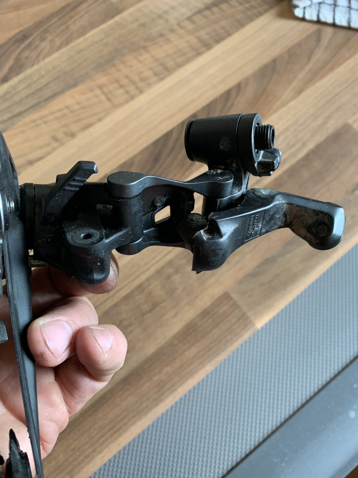

That's really unlucky. One of the big issues with e-bikes (in my experience) is that if a stick goes into the mech you either don't feel it in the way you do on an unpowered bike, or even if you and stop pedalling immediately then the motor overrun means you can still easily destroy the mech. I've seen it happen repeatedly. I was really lucky with mine and it badly bent the hanger but left all else ok. Your hanger still looks straight (but I'd guess there must have been a load of bending force to damage the frame like that)
Yours is odd in that it's not even the place those XT mechs normally snap (when I've seen it the cage bends out of shape before any links snap, and there did seem to be a batch where the main front link plate failed). That seat stay is ****** though - I reckon you're hoping for a goodwill contribution/crash replacement from Orbea. Really unlucky.

The big issue will be the seat stay, will they sell one or make you buy a full rear triangle? The wheel just needs new spokes right?
