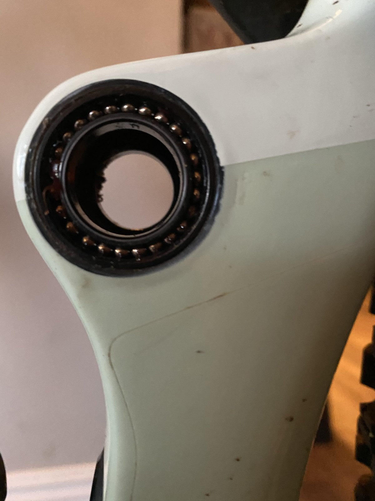

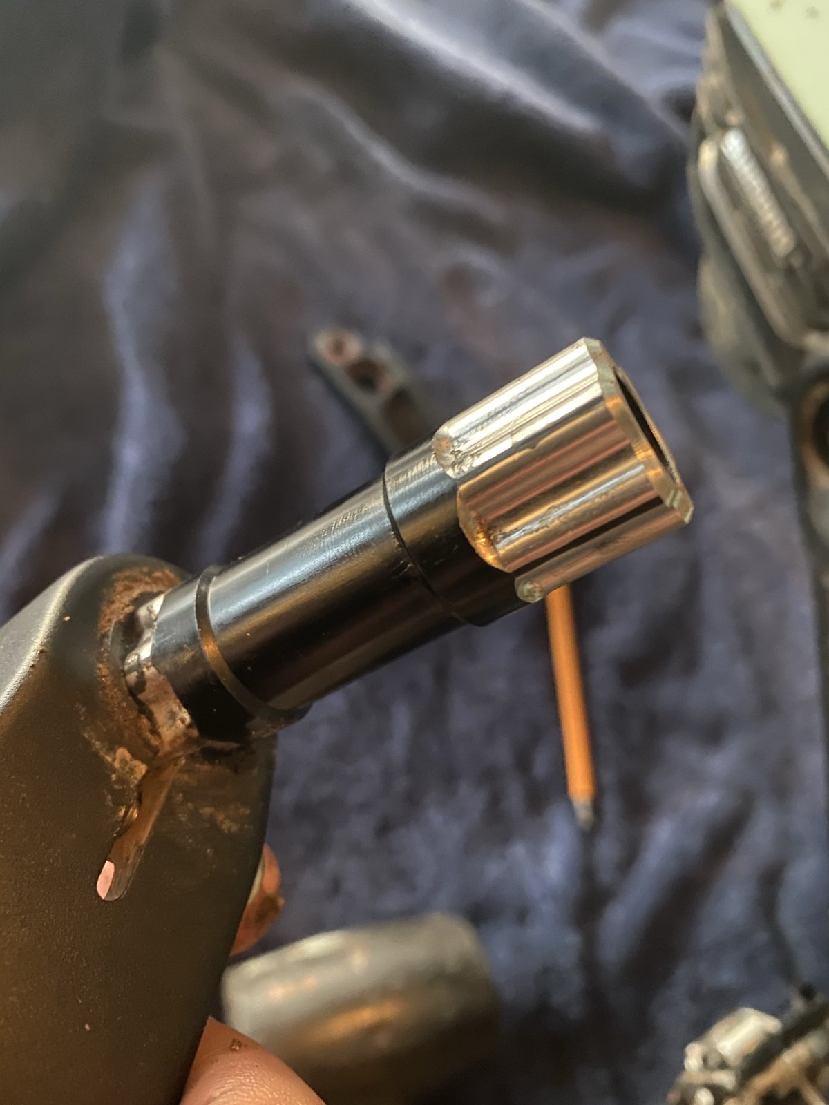

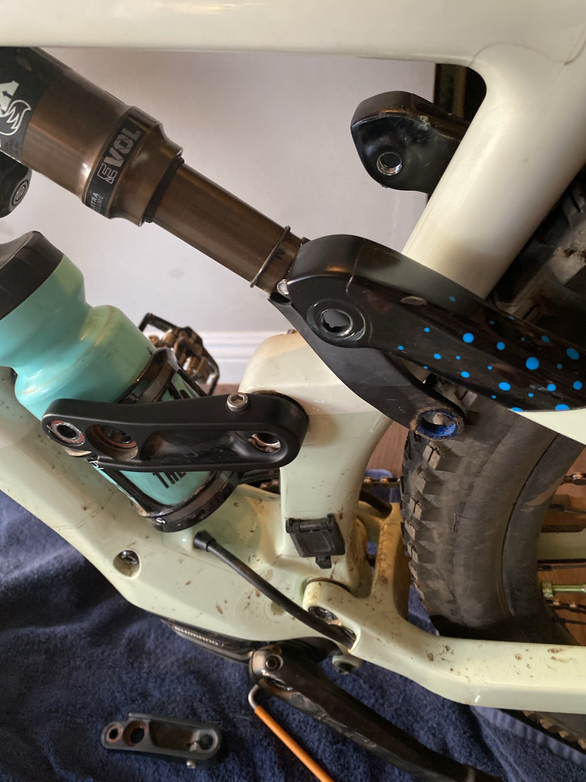

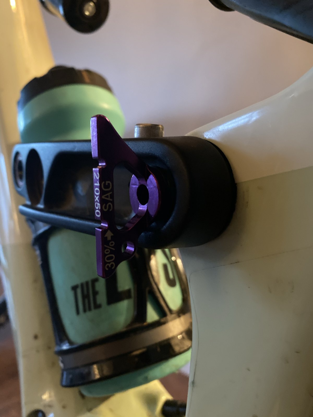

As a matter of interest how did you clear the creaky axle ? Mine is very creaky indeed !

Pulled apart the whole linkage and greased everything. Also pulled seals off bearings and stuffed with marine grease. Don’t forget to use that purple tool to set preload on the axle.
Random pics of the job in no particular order...
