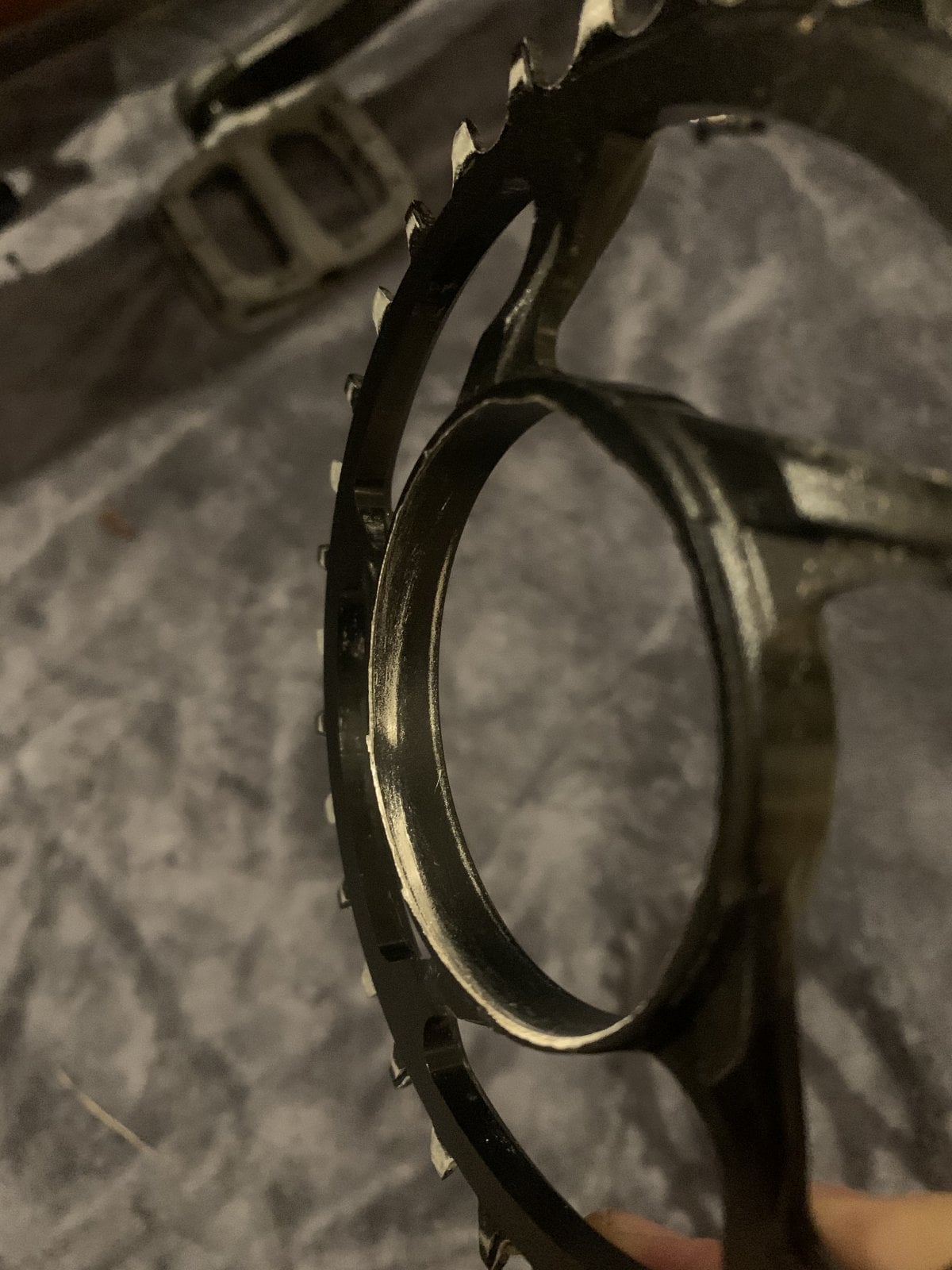

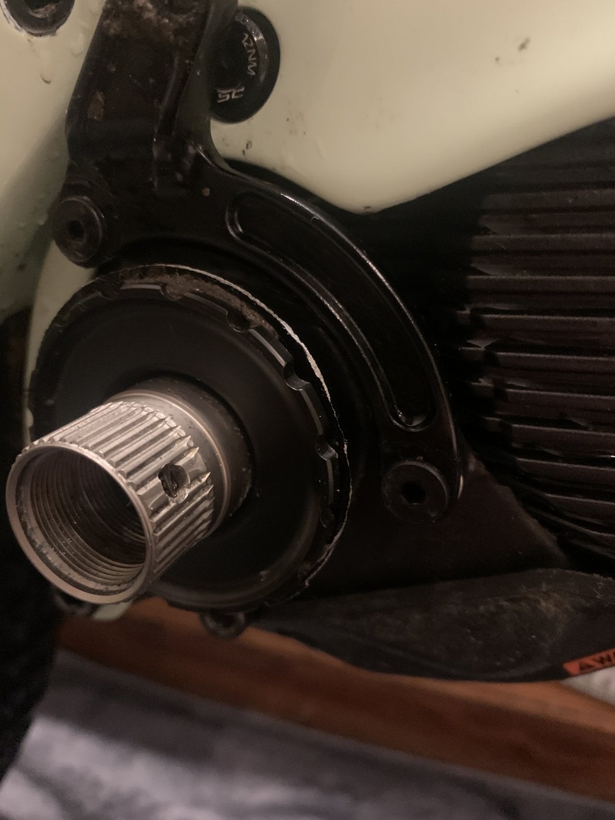

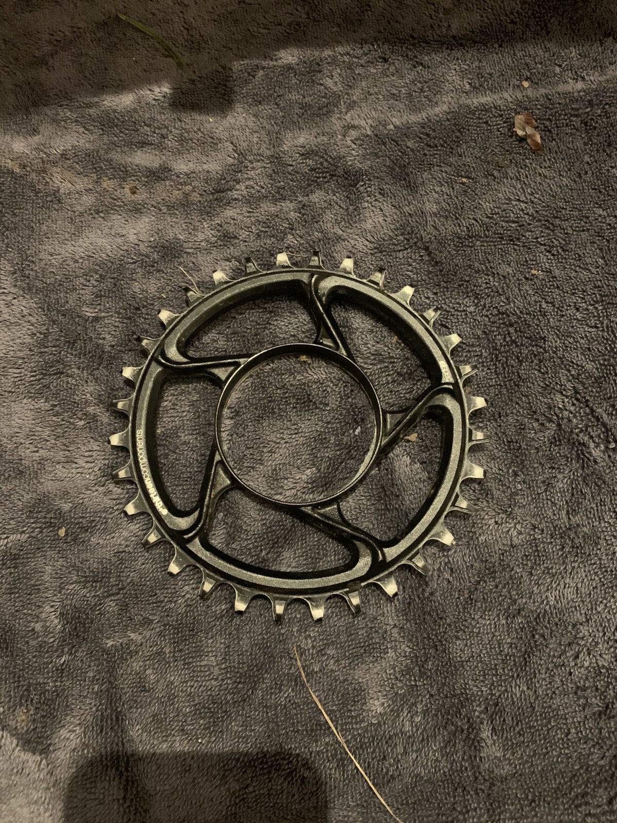

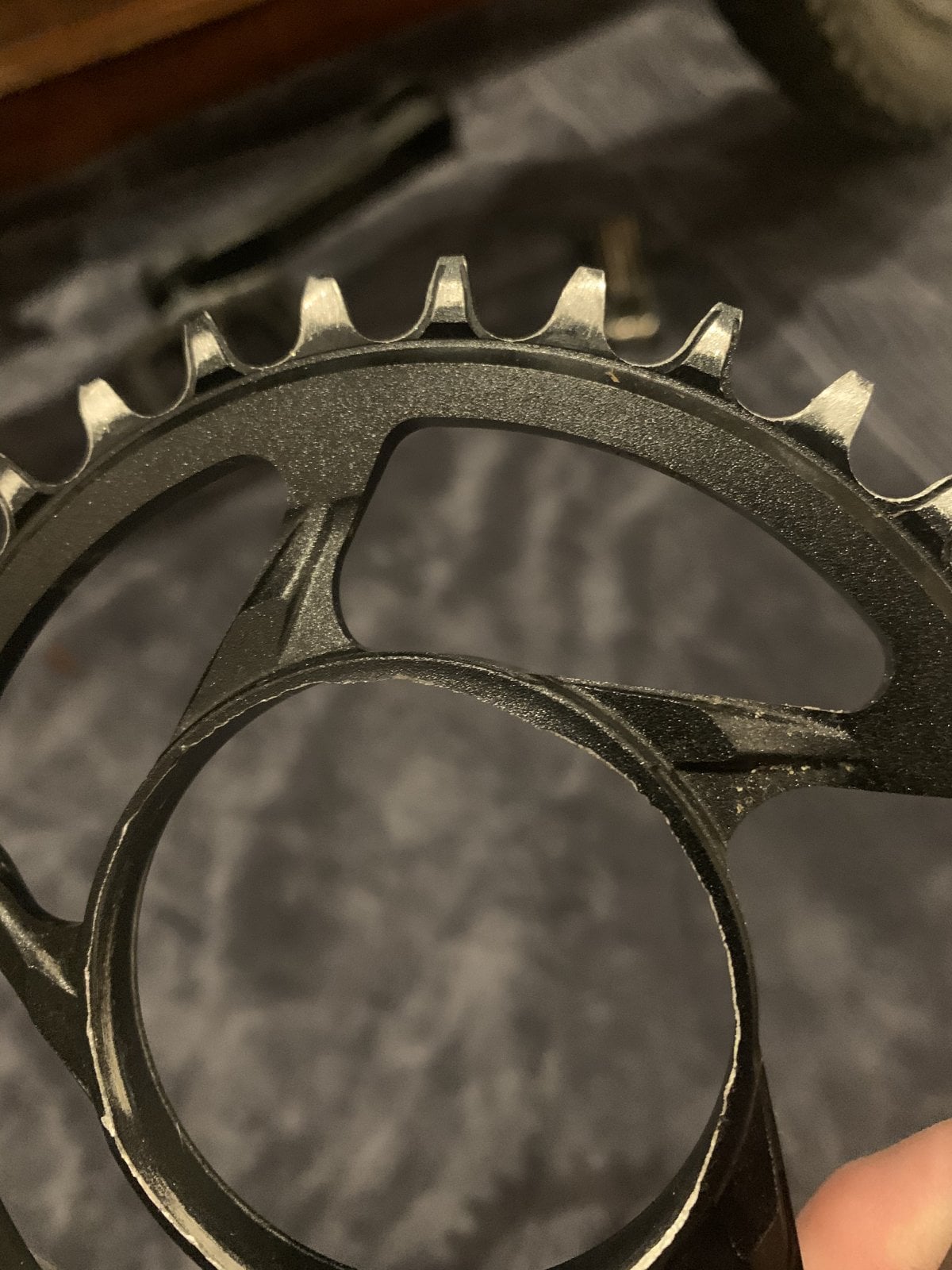

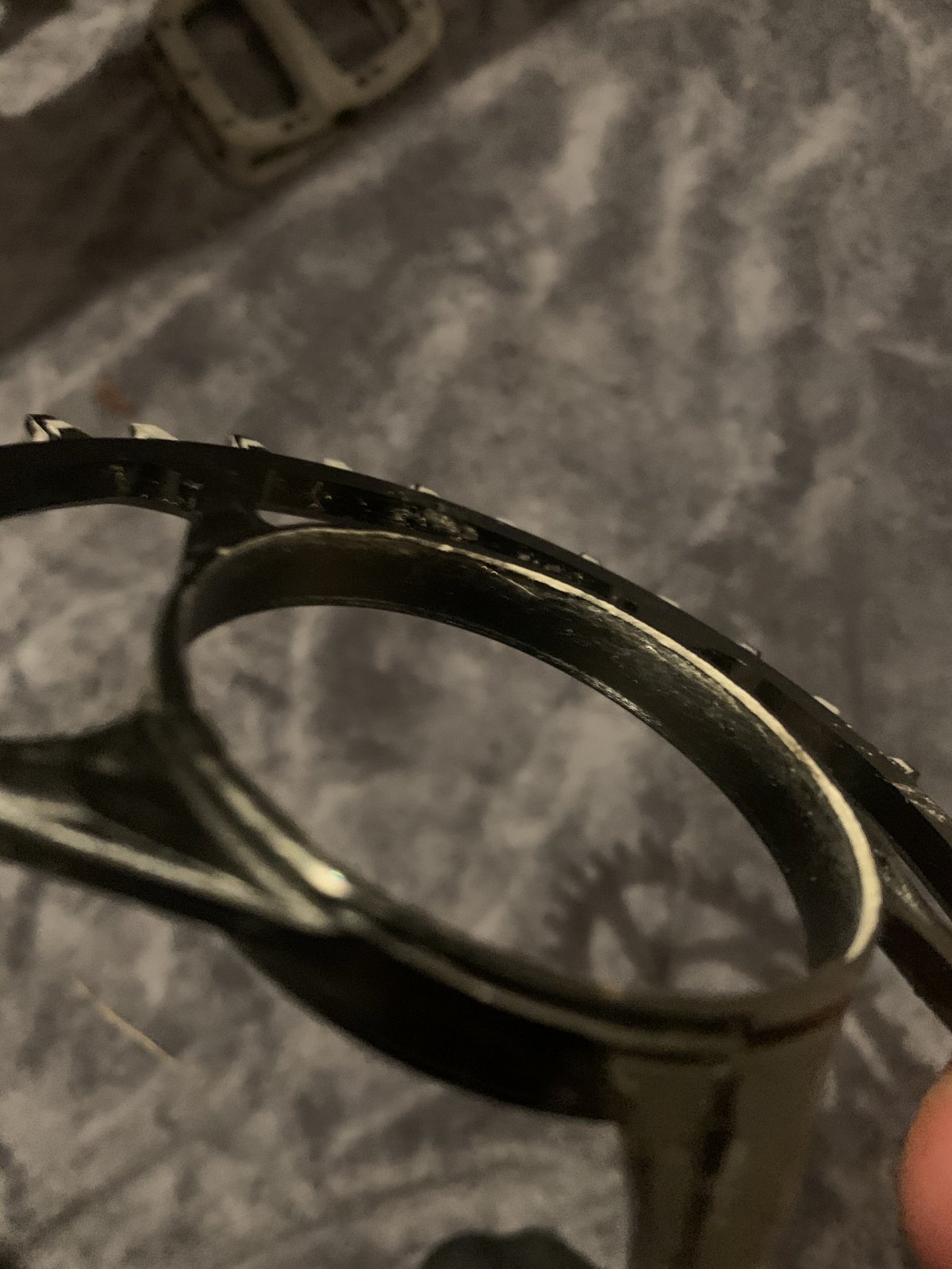

Hi all,
Ive had a Rise for less than a week, amazing bikes, lots of fun.
Issue is, the chain ring has snapped, so the fun has stopped.
its completley come off the crank, the inner part is still there, mounted to the crank and is still attached, and the whole outta peice has come off.
anyone else had this issue?
i wasnt pedalling particularly the mud, flat ground, and POP, the things just snaps striaght off.
im worried that as this is a new bike, and the chainring (from what i read) was especailly made for the bike, its might be a design fault, or if its just a manufactoring fault, its may take some time to get a replacement.
Contemplating taking the bike back.
Dont spend near enough 7k on a bike to have issue like this. Fully unridebale and not an easily accessible part. So far bike shop said they would get back to me today, and now they are saying they will get back to me tomorrow.
Fingers crossed they can get a replacement soon. Very frustating as its costs a small fortune, plus its was a 4hr walk home. Could have been a whole lot worse.
Ive asked for two more so i can have a backup if it happens again, and if it does, i can replace it on the trial then replace the bike when im home.
if anyone has any ideas, of has had this issue, please get in touch.
Thanks all!

Now that definitely shouldn't be happening! The E13 chainring is new to the market, previously pretty much all Steps motors came with the OEM Shimano spider and chainrings, over the last year we have seen some other brands start to make direct mount chainrings for the motor - I believe that E13 one is also what comes on the new Commencals.
Got to be a manufacturing fault, but on a personal level I am not a fan of E13 components, and I cant see why brands are using them over the Shimano OEM chainrings unless they are massively cheaper.

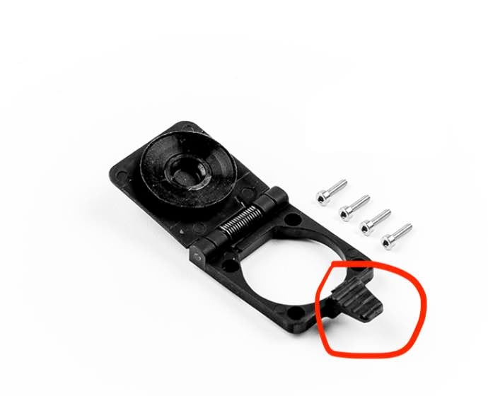

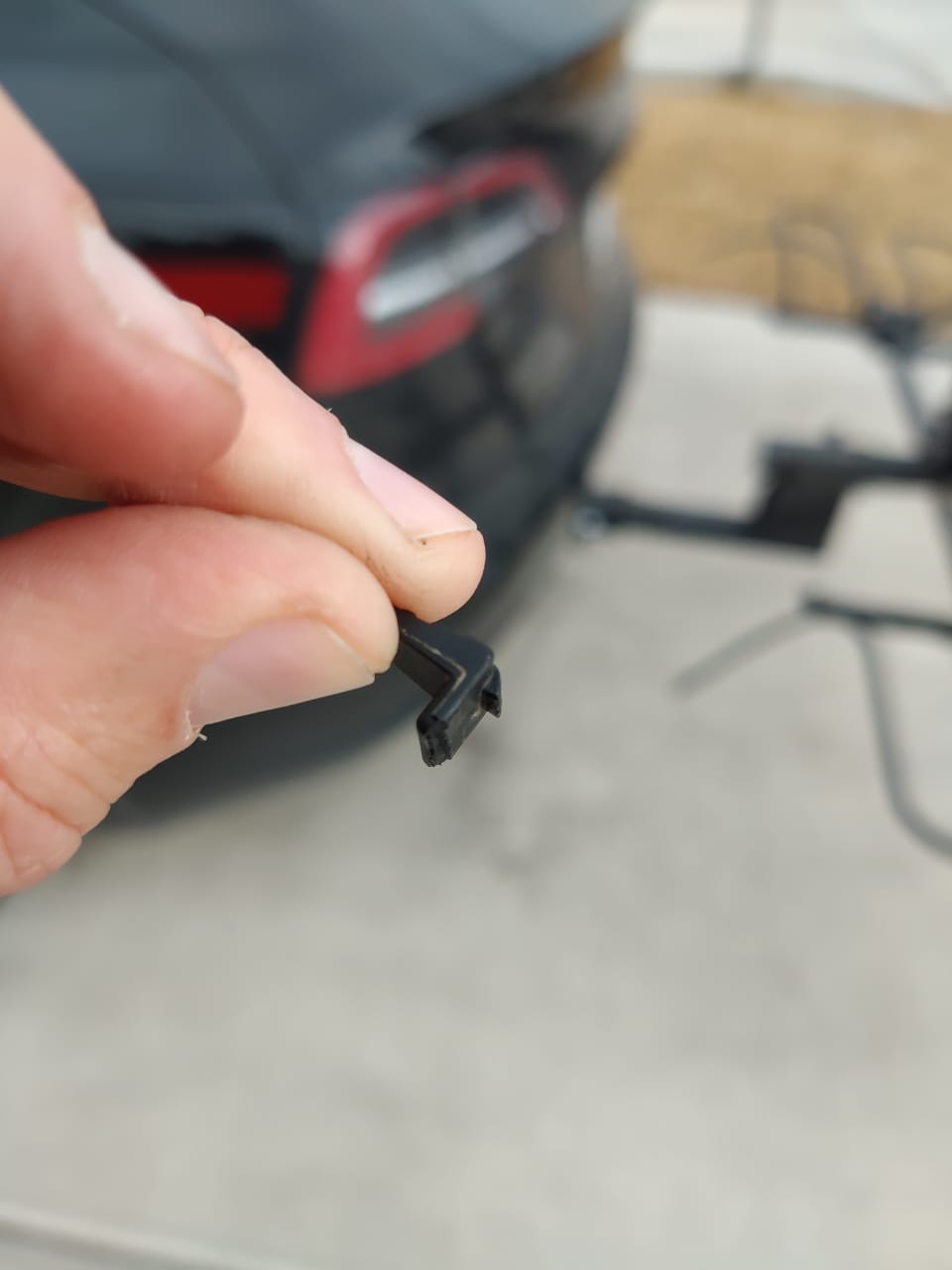

I haven't had that problem... yet. I've been putting my bike thru a lot of stress and so far everything is going Ok but the charge port cover. That part is absolute garbage and bad designed. Worst of all, Orbea is giving me a hard time to get a replacement.
I agree with you the bike is amazing and there's nothing close in the market. But Orbea customer service in the USA hasn't been shining...
I agree, I like the location, but the kettle tab thing is not going to last long. Gonna have to order a back up. Has yours broke?
Yes, it did break after 2 days. It's a piece of junk and I'm having a lot of problems with my dealer and Orbea to get that part. Orbea says I have to talk to the dealer and the dealer says Orbea is hard to talk. What a joke.

Sorry to see the trouble with the ring. I can say this is the first of that failure type of our shimano espec ring which Ive seen. Would you mind filling out a warranty request on our website and we will get you taken care of? Here is the link: ethirteen support
Thanks,
Chris

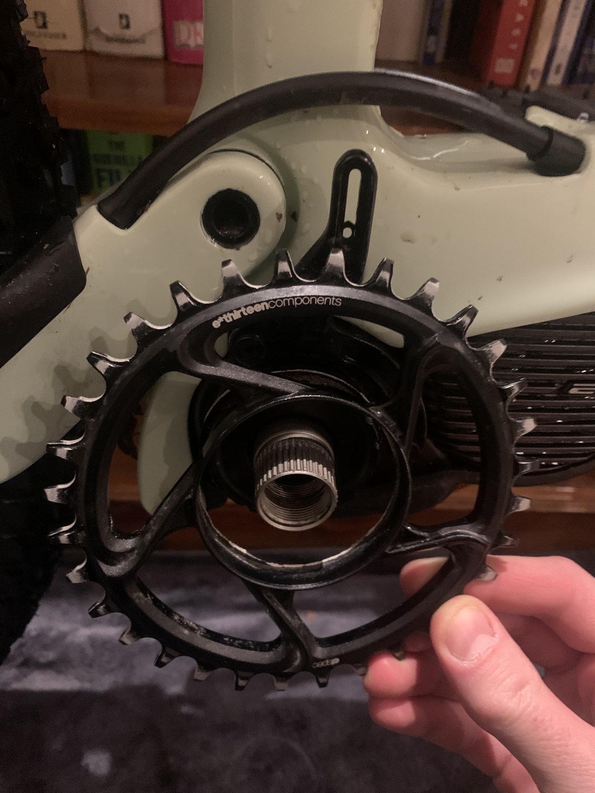

Nice to see e*thirteen on the forum. Any chance you know what the part number of the tools needed to remove the chainring. I already emailed e*thirteen support and they didn’t know and referred me to Shimano.
The reason I am asking is without being able to remove the chainring you cannot get access to the motor if there are any issues.

Wouldn’t you normally remove the chainring nut from the inside after the crank arm has already been removed?
On this motor the cranks are separate from the chainrings. Once you remove the drive side crankarm the chainring is attached to the motor and spindle.
Got it, thanks for clarifying. Your posted pics also make more sense where the broken cassette piece was left attached.

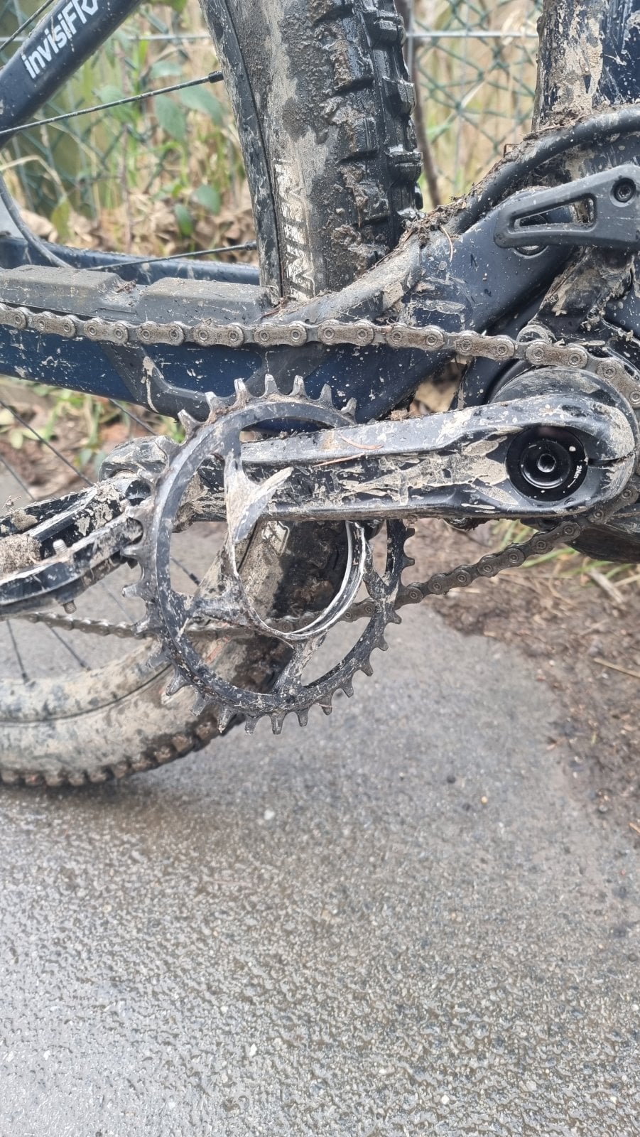

Hey Guys - This customer was sorted and sent a replacement. We are getting the ring back for engineering to look at. To date, this is the only failure of this type we have seen on this model ring.
