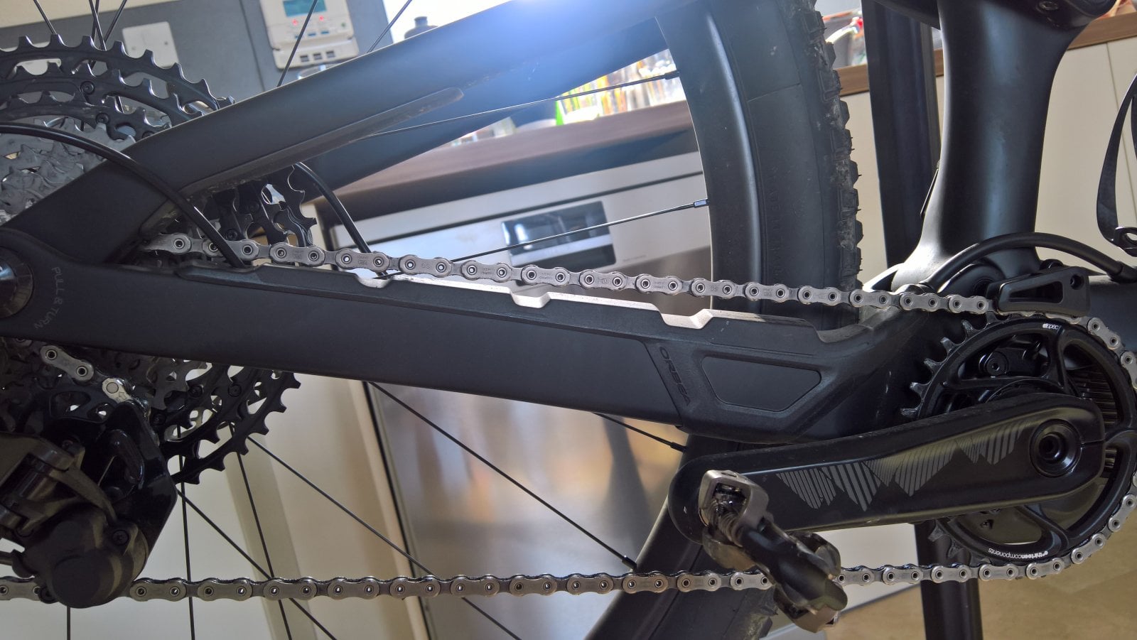

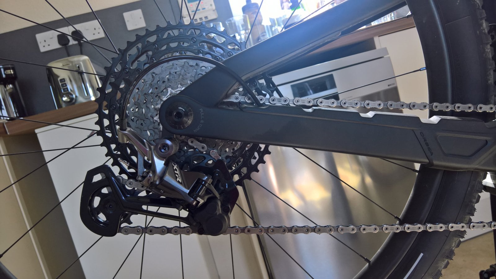

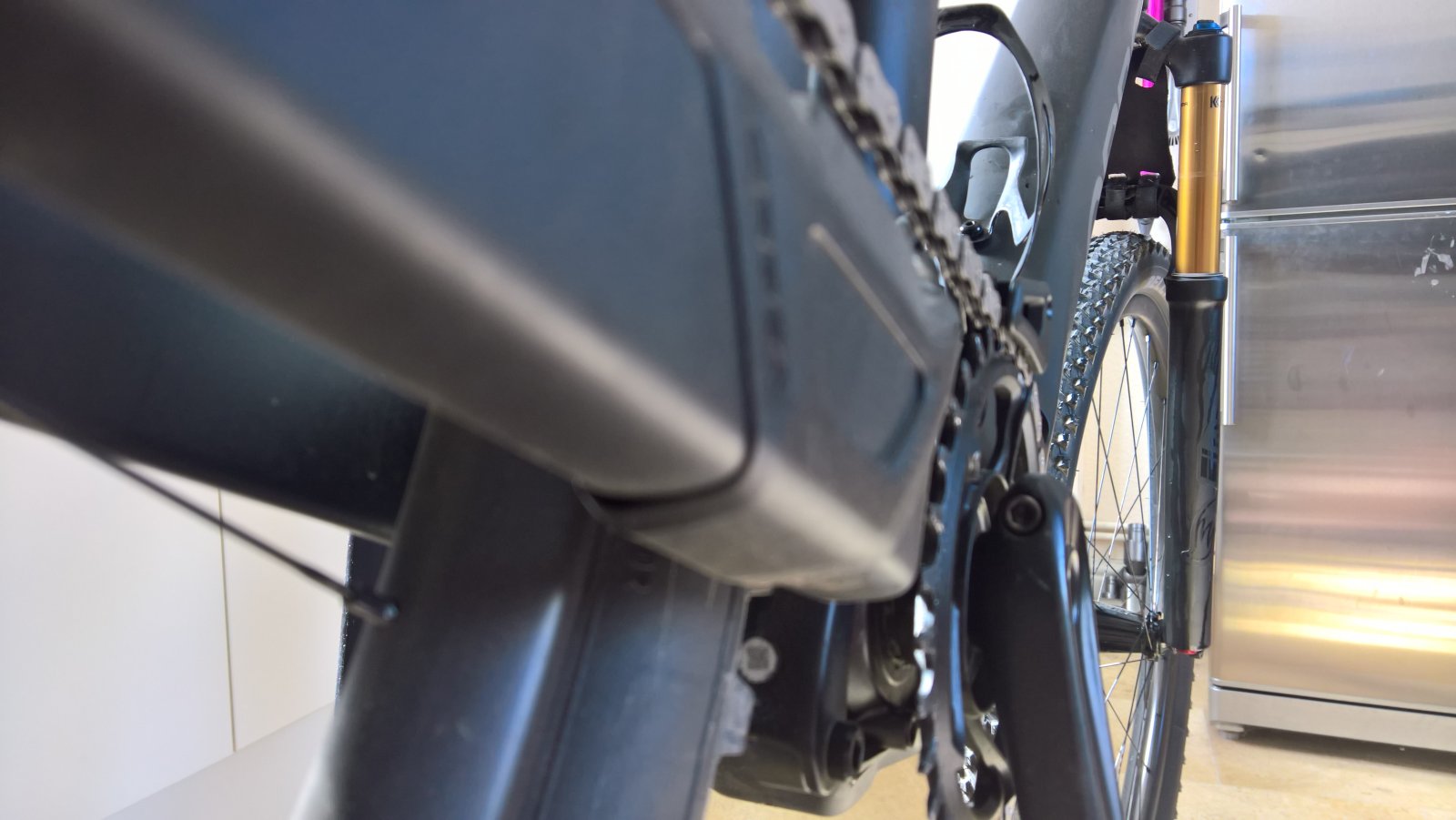

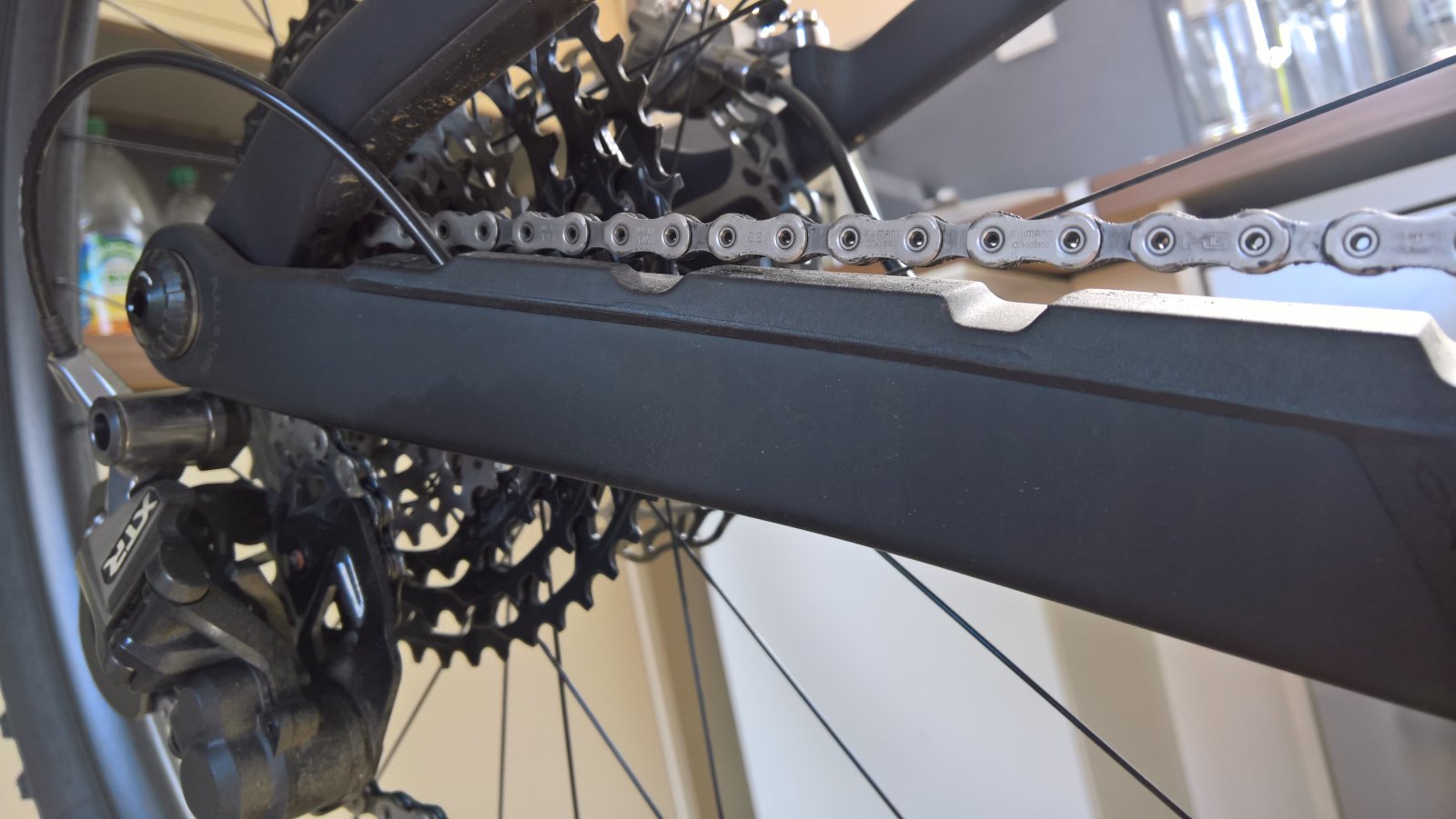

For my XL frame the chain at rest doesn't touch anywhere along the rubber guard, but there are 3-5mm gaps at either end, where it is close.
Here are some pics (click to expand hopefully ...)
WP_20210405_14_48_58_Pro.jpg WP_20210405_14_50_11_Pro.jpg WP_20210405_14_50_28_Pro.jpg WP_20210405_14_51_00_Pro.jpg
