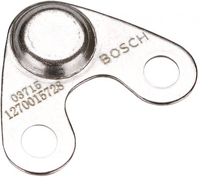

This is the route im going too. I've a pair of new pair of pro4's to fit, and after looking about found out this is the magnet you use. I've not tried it yet so im still a bit apprehensive.
I dont know if theres different versions, so mine is a scott so i specified scott, yours is orbea, so type in o"orbea bosch magnet etc", though for all that it might not matter and the sensor is exactly the same.
I got mine on ebay.
Its rotor on first, and two of the holes you fit the sensor.

How about this ?

How about this ?
perfect thanks
I also emailed Orbea and asked the same question, they have confirmed that the X240000 is the correct type to use on the Rise with 6 bolt rotors 👊🏼

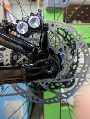

Howdy. I use a 10x2mm neodymium magnets. They are small and very powerful. I had some carbon wheels I wanted to use on my Rise and could not find a rotor with the sensor. I now run a 6 bolt rotor with a magnet placed where the sensor would be. I live in Lake Tahoe, great riding with lots of boulders. The magnet is still in place!
Good luck.

I also used a rare earth magnet (10mm diameter, 2mm thick) that I used araldite (epoxy) on my Magura centrelock rotors. You can see it at the 2 o'clock position in the photo. Much cheaper than other brand options.
So long as the magnet triggers the sensor you are OK, as it is just measuring a full revolution (and not an exact distance) that corresponds to the general outside diameter of a 29" tyre.

Tubby,
Here is the part link to Orbea's UK website for the magnet adapter mentioned in the above posts.

Thanks Rod. Orbea sent me that link via email too and it turns out it is exactly the same Bosch magnet as mentioned in the first reply (#2) in this thread
It typically takes about two to three weeks to get Rise parts from Orbea in Spain. Maybe source the Bosch magnet locally so you don't have to wait?
