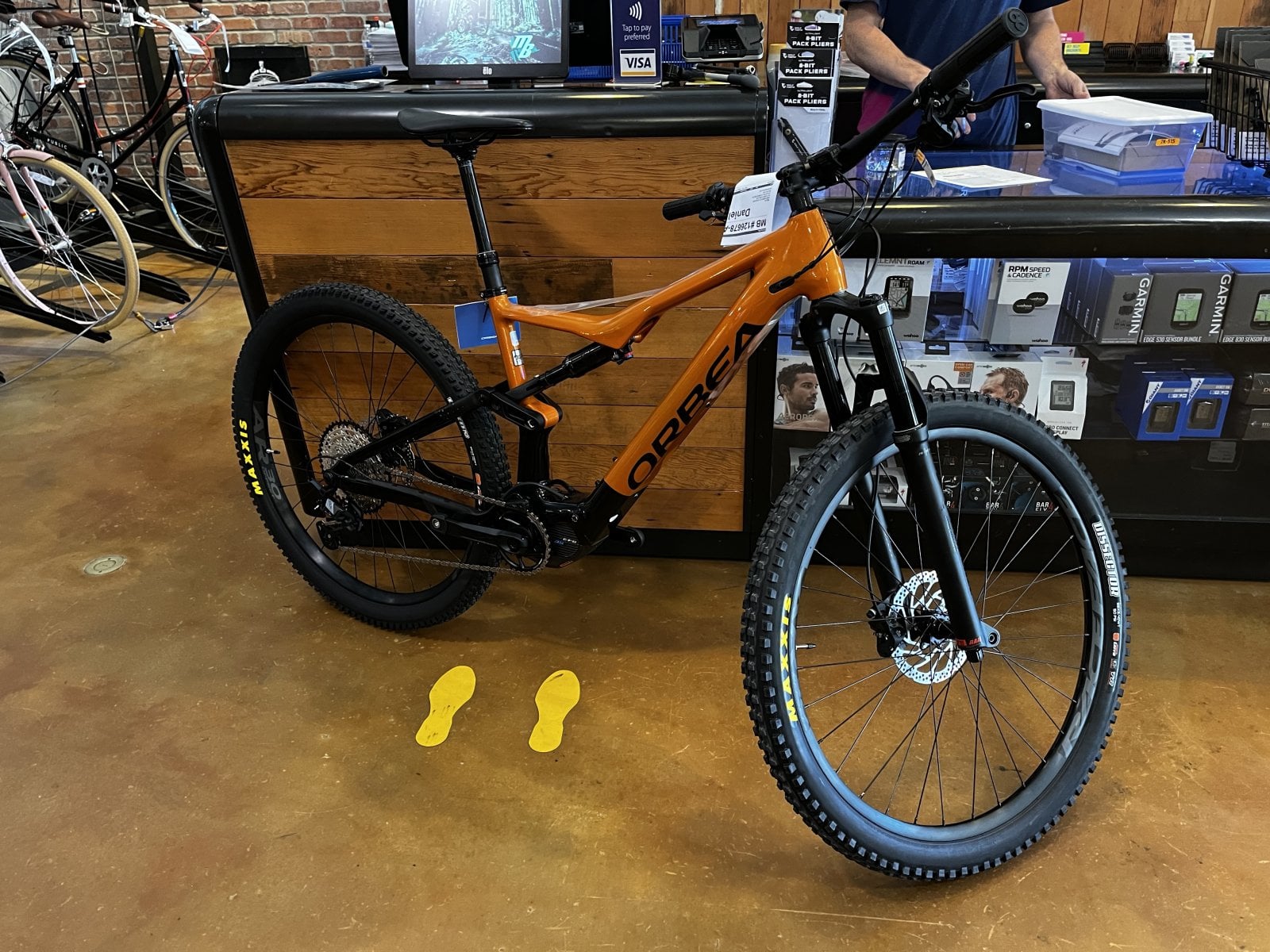

Picked up my H30 this afternoon and got started on the first of the mods, moved the Dissector to the back and put a DHF up front, tubeless, SWAT cage, saddle and tool wrap. Will take it for a range test/shakedown tomorrow then drop it off for major surgery, new cockpit, Fox factory 36 160, XT 4 pistons with a 203 up front, Float X2 etc. Reserve 29's when they come back around. Size large was 45.3 lbs without pedals and can confirm the Shimano display as standard.

Ummm, wow....What a great bike! Yes there are some immediate upgrades ( brakes ) that will only make it better but right out the box the H30 is a blast. My first experience with the Shimano rattle and yeah it is less than desirable but it only happens on the downhills and it can be ignored. First ride was 18 miles and 3700 feet of climbing, mostly trail with a decent amount of Boost in the second half of the ride. Super solid.

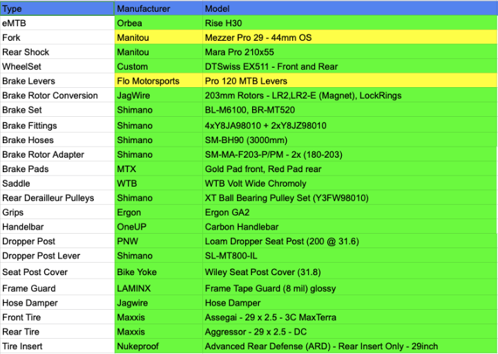

Some of us bought the H30 because we weigh 225 lbs kitted up and need a more robust suspension setup (which in turn will be more reliable going forward). Most riders weigh around 160->180 lbs kitted up, so we are basically carrying a whole extra bike H30 (45 lbs +) in our body - lol.
For example, I'll be replacing the front fork with a Mezzer Pro as well, and the rear shock with a Mara Pro. Both of which I use on my other bikes and I have experience with.
The DPS is really a POS shock for someone a bit heavier, you need to pump that shock up to almost 300 psi to get the sag in the baseline (25-30% sag) - compared to 160 psi on the Mara Pro.
By the time I'll have my H30 upgraded to my liking, it'll cost slightly more than a H10 after selling the stock parts being replaced.
Thanks to share your configuration
if I’m not wrong, you keep only the frame and the battery from the original bike 🙃

Most of the weight I saved was on wheels. XMC 1200 are only 1500 grams, so quite light. I put on a lighter dropper, lighter cassette and lighter cockpit but heavier fork, shock and brakes so in total it's just a little bit lighter but much better performance.
