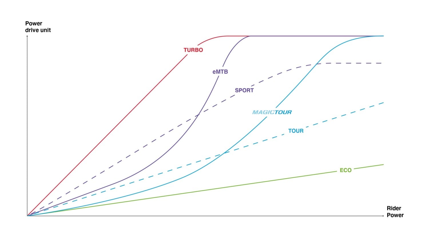

This graph from ebike-mtb here:
describes perfectly what I‘ve found about the assist levels of my gen4.
I find them in general too strong particularly at the lower end. I used eco yesterday on a massive steep climb in Wareham forest. Sure, I was puffing a bit when I got to the top but much less than on an mtb. Most of the time on the forest tracks I was in “off”. You slow down a bit, but I’m out for a ride on a bike not on a dash to get into work.
How long until magic eco appears?
That "Magic Tour" curve looks very much like what I originally imagined eMTB mode would be. It would have been nice if I could have asked my dealer to just drop that curve into the eMTB slot.

Good find! Going to call Bosch for more info.
Edit: Short version - it replaces eMTB mode with a mode that runs very low assist at the low end (roughly similar to ECO) and goes up from there and is intended for "fitter riders" who want more range. Sounds good to me as in practice I never find much use for eMTB mode.
