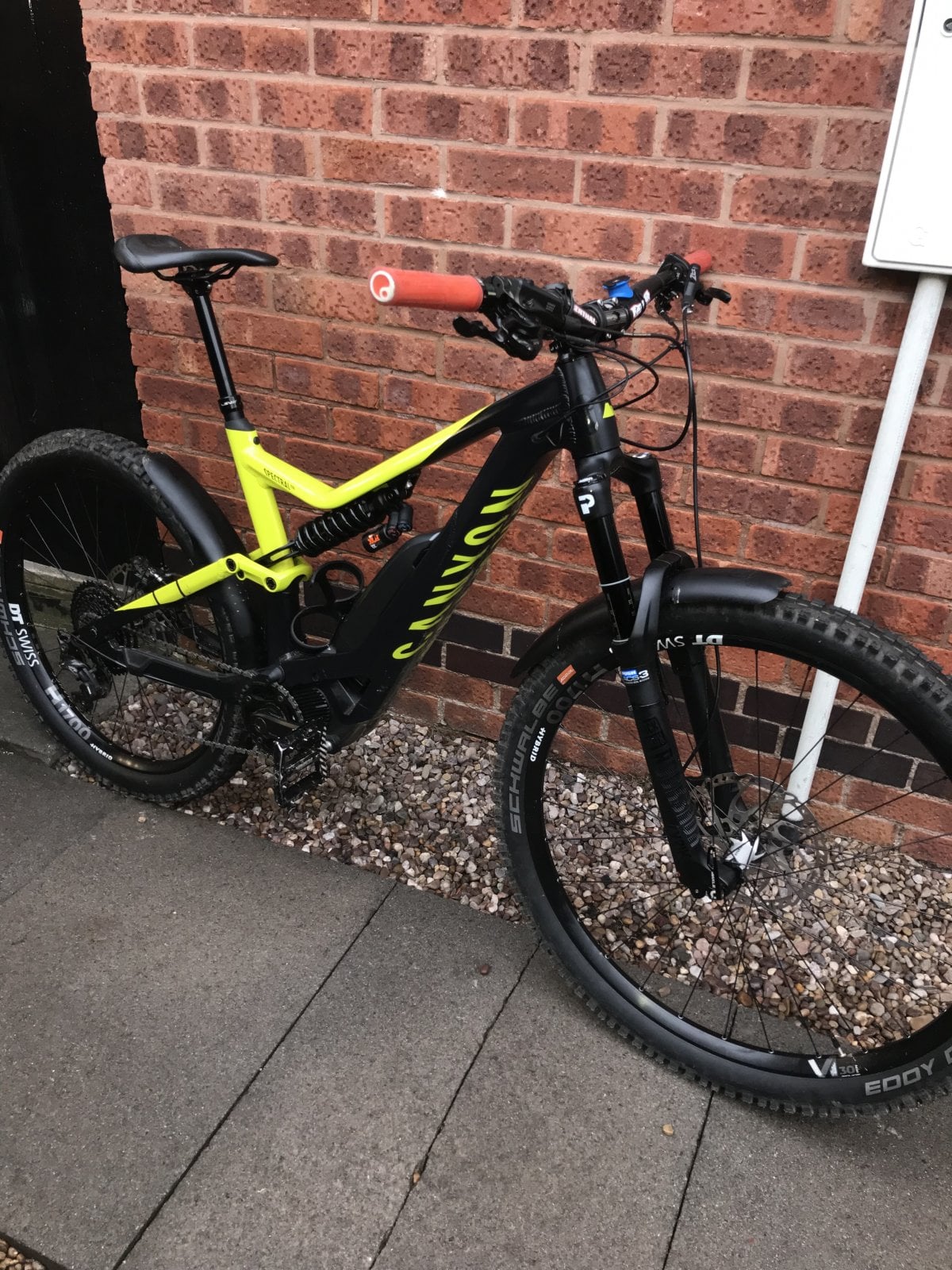

Just swapping a few of my parts on to my new spectral On 7, cant ride yet as 6 weeks into recovery of broken wrist.
Can’t believe how heavy the stock wheels are. 3.6KG for the rear wheel!!!! I’ve just swapped it out for my carbon E13 wheelset, GX eagle cassette, same rotor and a Minion DHR2 3C 2.6 tubeless and it weighs 2.8KG. Looks like I’ll take about 2-2.5 LB off the bike weight just swapping wheels out ?
