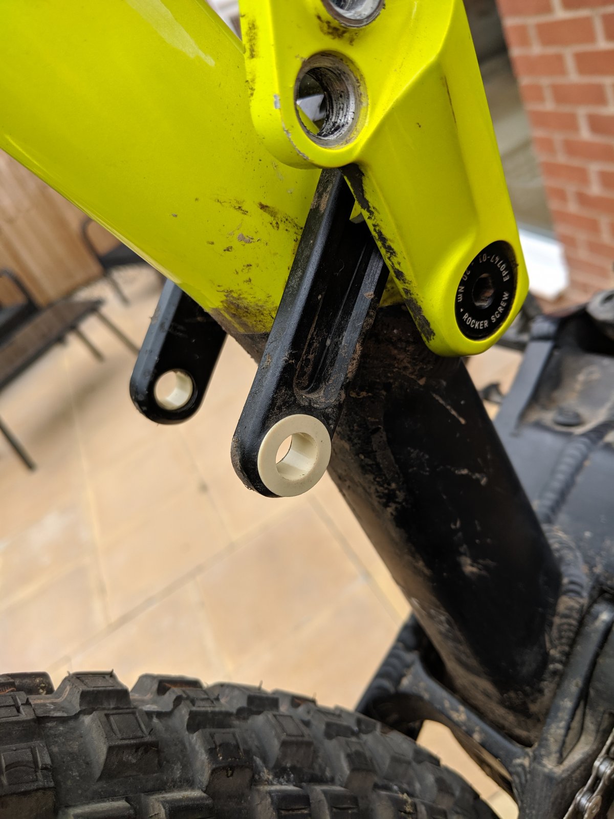

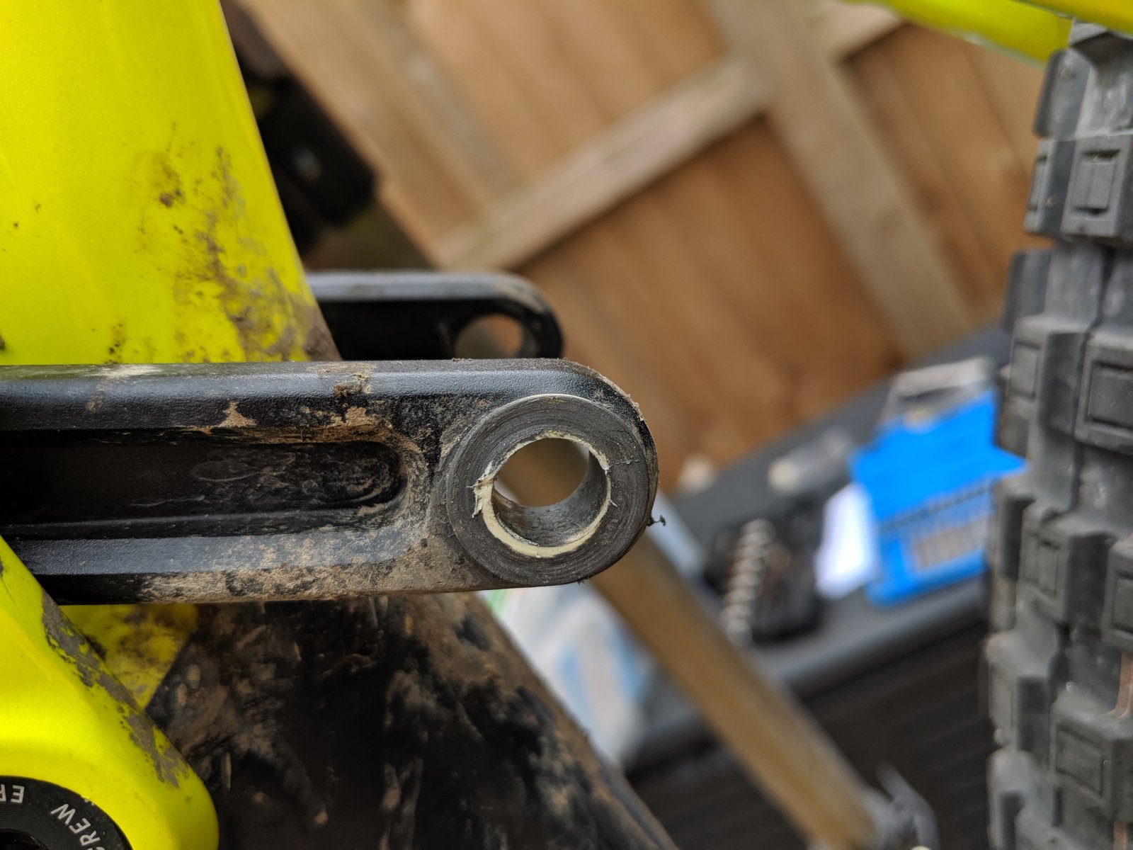

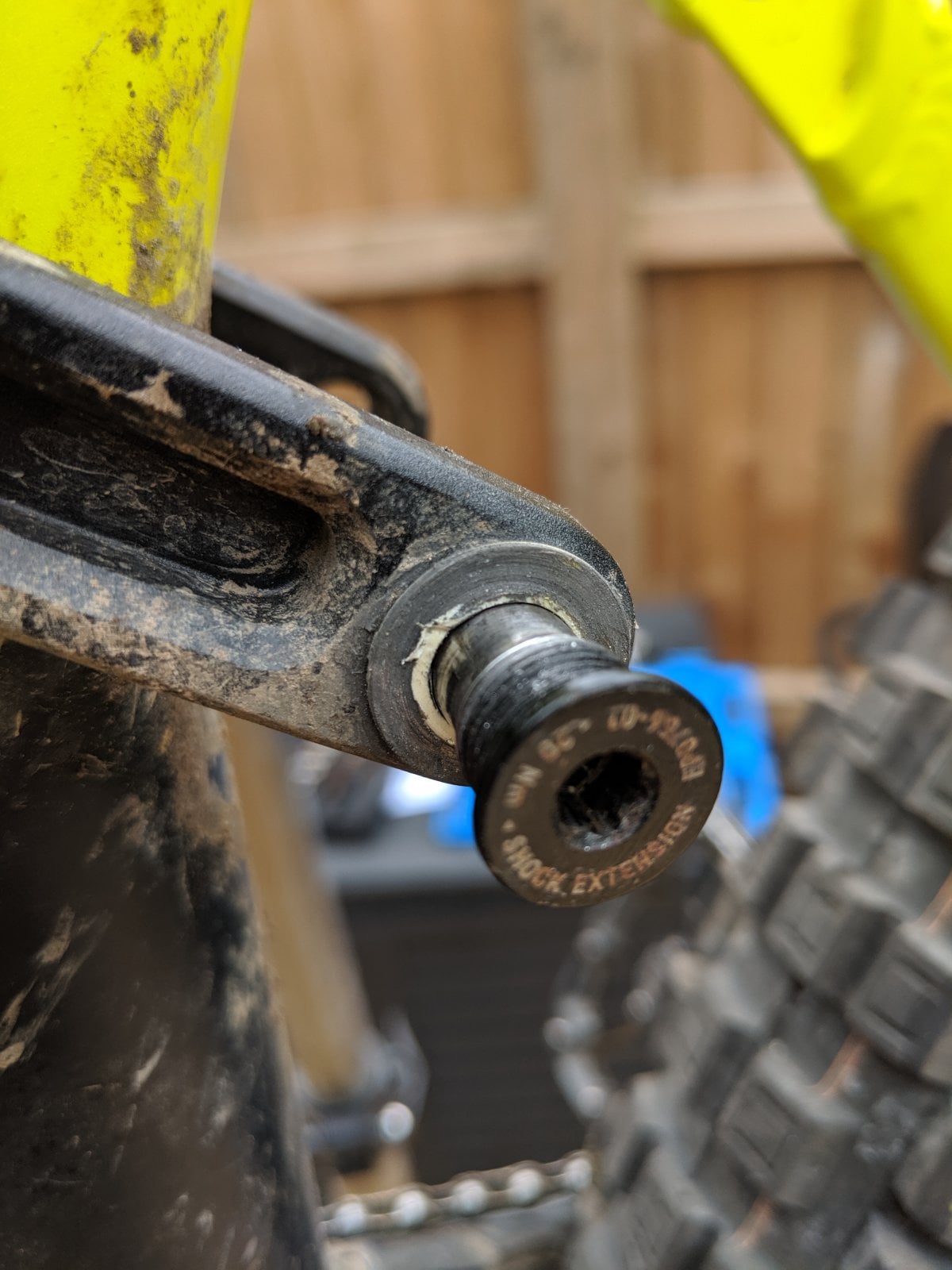

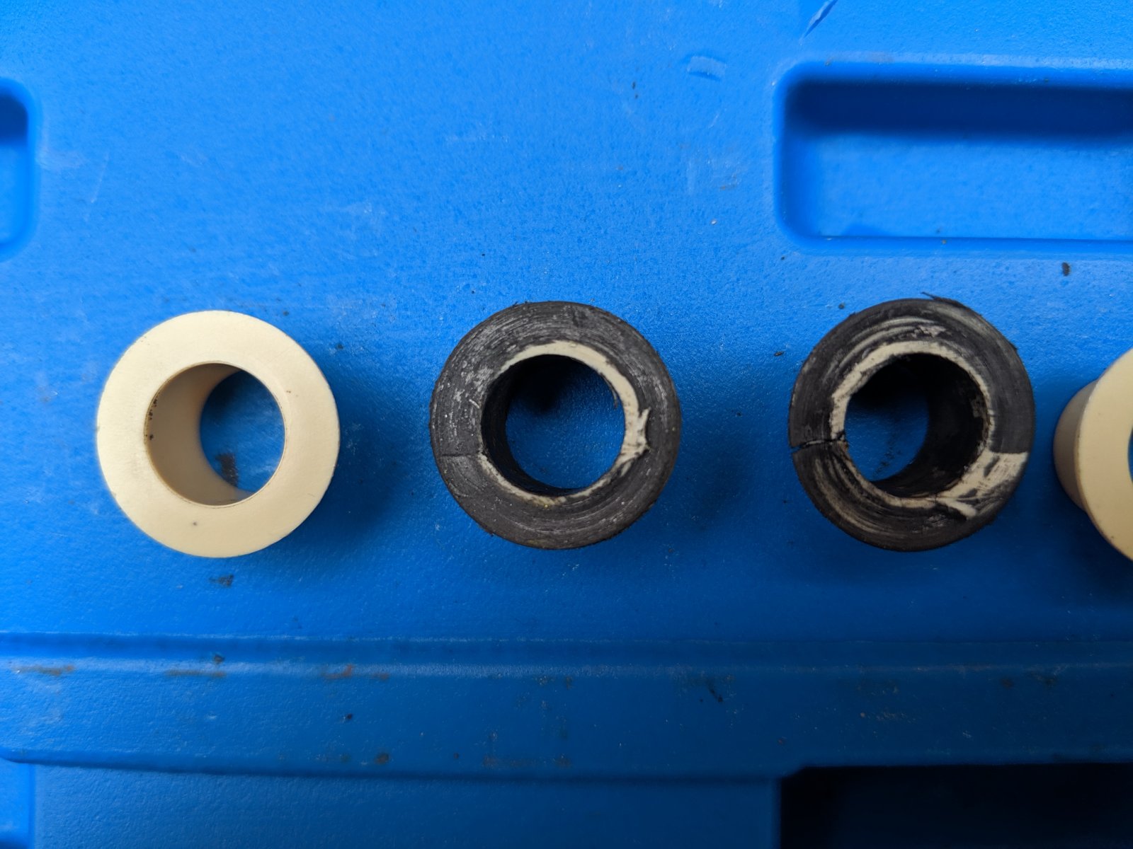

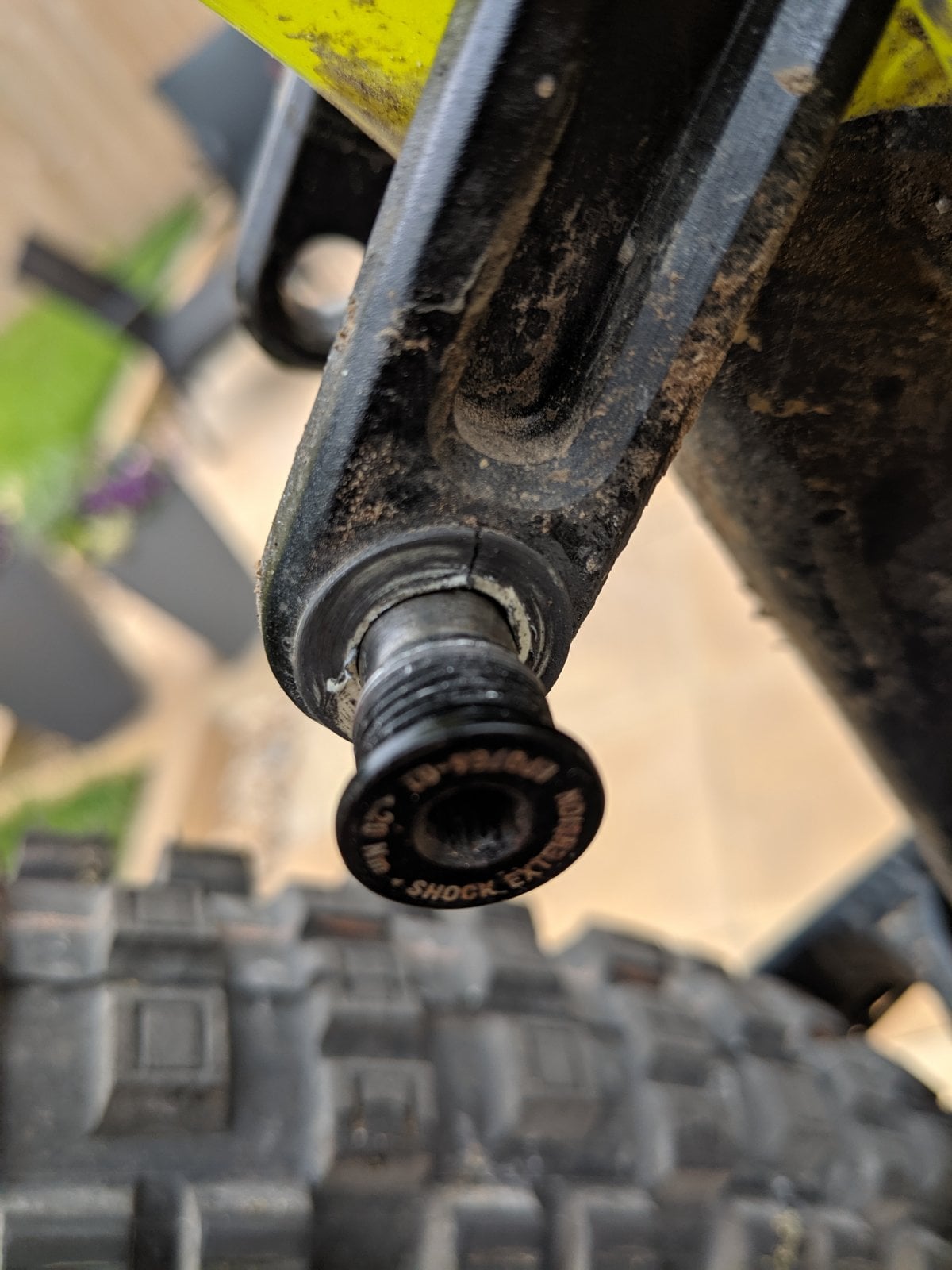

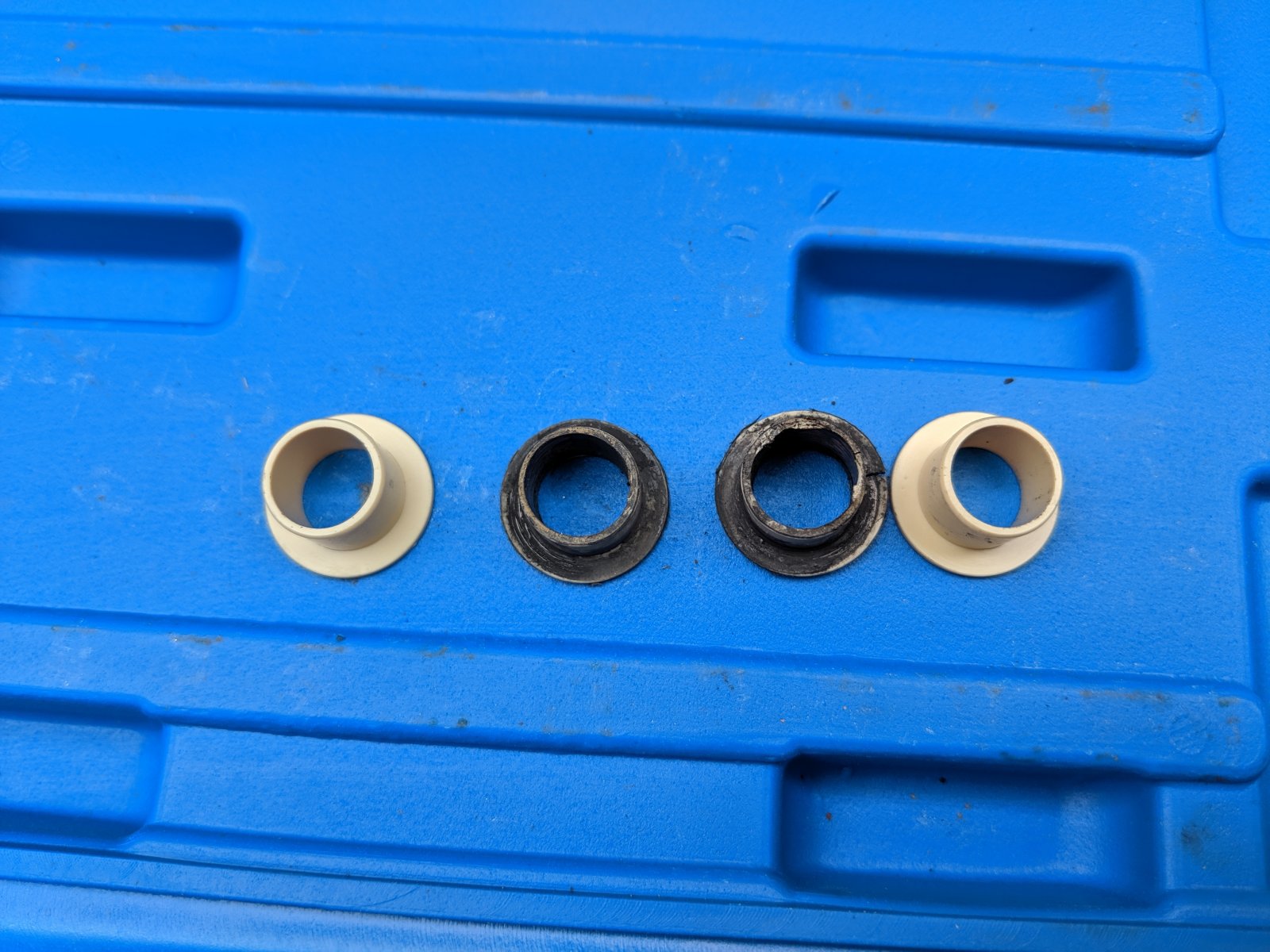

I have replaced them myself a few hours ago. I noticed it but I thought it was a loose headset or loose spokes. I never assumed it would be the pivot bushings. If you stand your bike on the back wheel and lift the handle bars you would feel the play straight away. I took some photographs of the replacing. I will post them in the forum
i thought my headset was coming loose last ride out i had, wonder if the same has happened to me? did it make a particular sound ?
Not really but if you try to pick the bike up slowly by the seat you will find the wheel stays on the floor. You can feel 5-10mm of play when you pick it up before the wheel lifts from the floor

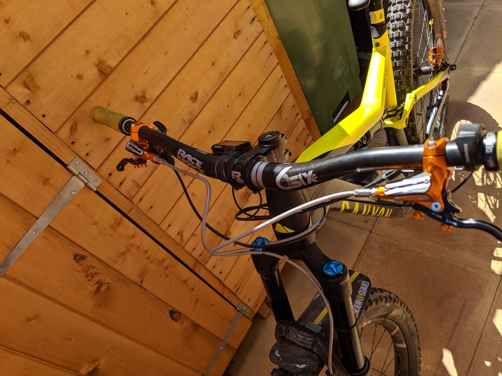

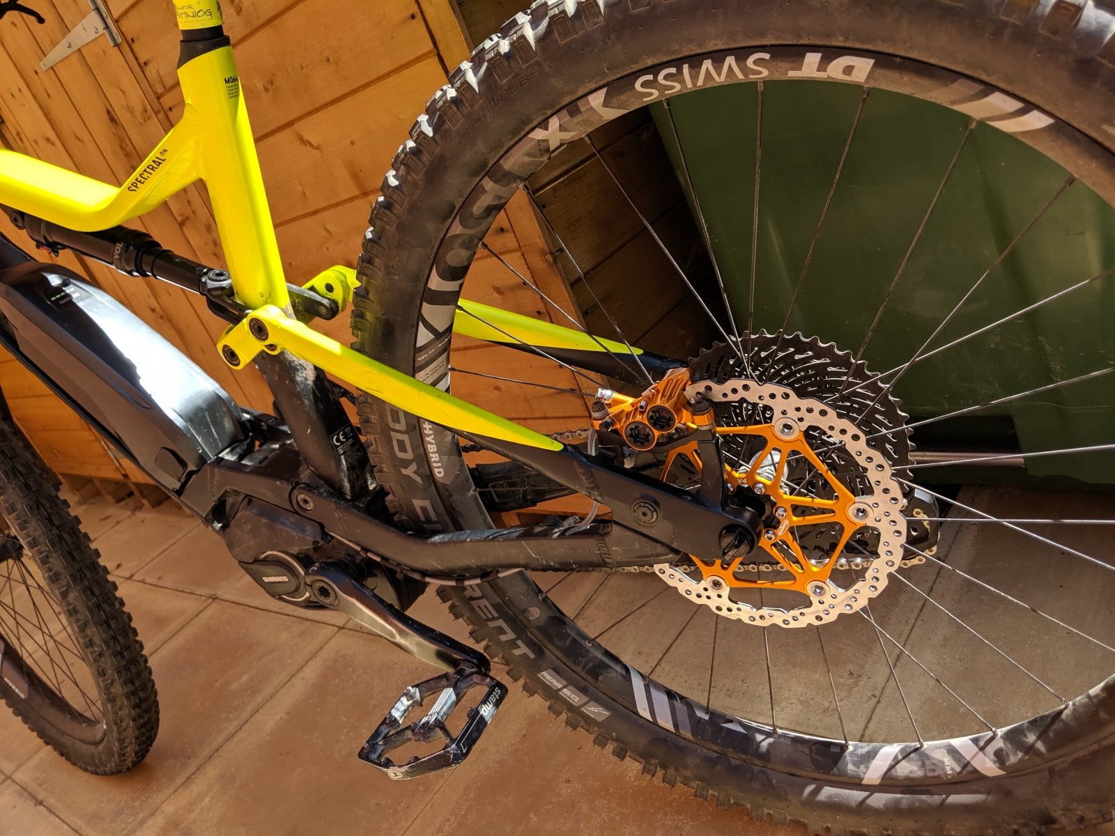

as promised ? and bonus new brake pictures
mvimg_20190524_133913-jpg.14127
Clansey
Aug 13, 2018
269
197
Liverpool
Nice bike how you finding the hopes
first real ride on them tomorrow, I've only bedded them in the local park. The initial feel and adjustments are much better than my Code R's but we will see on real trails.
P.S they were very expensive so I'm factoring that in :ROFLMAO:
