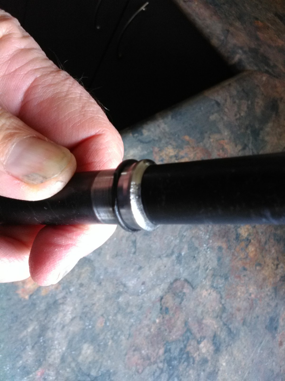

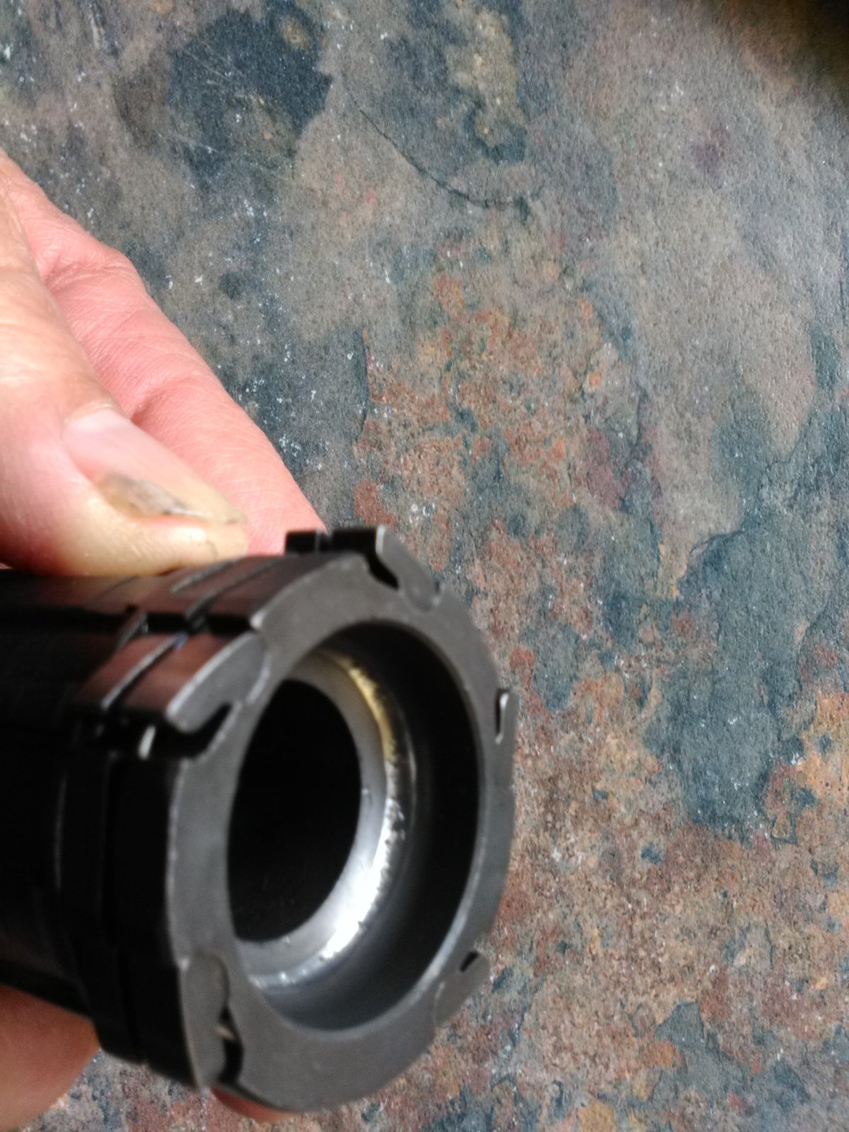

Continued to hunt the grinding noise coming from my bub. I removed the back wheel and by rolling the wheel from the cassette I felt there's point where resistance is felt. So I removed the cassette and the freehub but could not find what could cause this sound:
It's quite awful and when going for a test ride I can feel that grinding sound resonating to my feet. If it's that powerful it cannot be good for any conserning other parts either. I'm now discussing returning the rear wheel to BikeDiscount.de shop where I bought the bike from. But by shipping it to them from Finland and solving the problem there it may take 1-2 months for me to get it back...
I'm now even considering buying a whole new wheel with a new hub with it. I'm just not sure what to get and what would be compatible with the new Jam2 6.7 Plus with plus-tires / micro spline / size 27.5 /12x148 boost and 12 gears. Just too much specs for me to be sure what to get :(

Did you take apart the freewheel? If it's like mine you have a damaged race that can't really be fixed. I'm assuming the freehub is using individual balls and and not cartridge bearings. I probably ran mine a little bit loose or it has some dirt get in but either way one of the races was badly damaged.
I removed the freewheel and it's axle but didn't really know how to open the freewheel itself. Or actually how to remove it from it's axle either. How is that done ? Could not really see points where to loosen it from the axle. (Noob here so I really appreciate the help and information) :)
One end is held by something like a 10, 11, or 12mm hex and the other by a very thing 17 or 19mm wrench. Can't remember the sizes and I'll take my Novatec wheel down later to look for you. This video might show some of that. They are using a hex for both sides but can't remember what I needed for the novatec.

Btw, here's the inner part of the hub as I removed the freehub and it's axle: Hub
No the 162 comes apart just like the 462. Once you remove the assembly from the hub like you did it comes apart. They both have steel cassette drives and both come in 3 and 5 pawl versions but Focus uses the 5 pawl. The 162 has individual bearing and races that you need to grease while the 462 has 3 cartridge bearings that are sealed so it's the better option And both are the type that fit your hub. There is an 11 speed and 12 version as well. Like I said there are slots on one end for a slender wrench and I think the other end takes a hex. you adjust these for the 462 to just take the play out of the bearings on the 462 and when this comes loose as it does, then the bearings wobble and hammer the races, probably your issue. You just need to get this assembly apart now and it does come apart....but no replacement parts available other than just buying a new assy for the $70.
