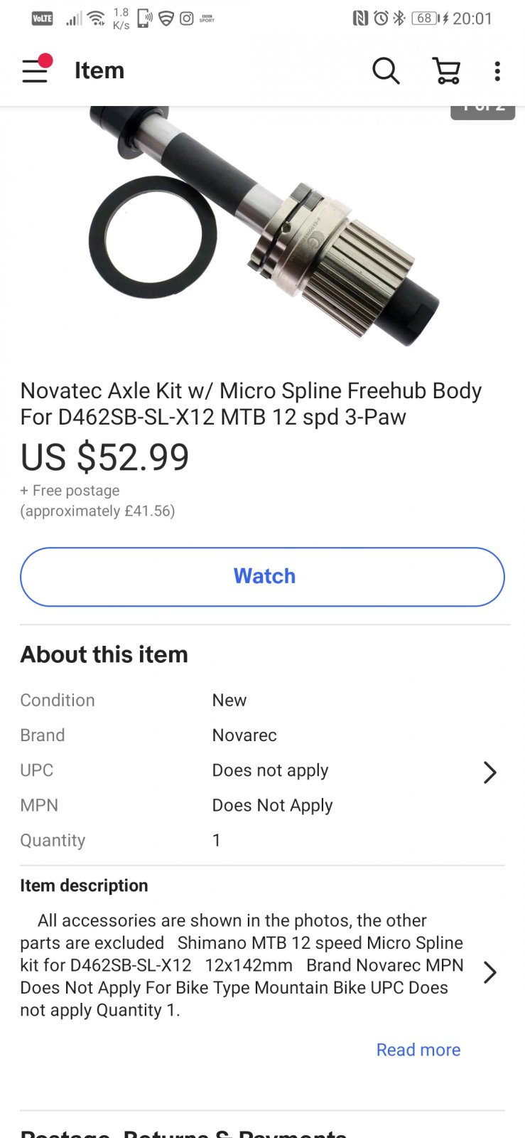

I've ordered this but in 148 mm from ebay
Yes I did the same from aliexpress (could not find at the time on ebay) but the 11 speed version (462), 3 cartridge bearings, 5 pawls and steel cassette driver. Looks indestructible but I've put on a set of Exile+ Speedtuned CF wheels given to me. 29" front/27.5" back, 4 pawls and aluminum cassette driver. It is getting gouged up over time but it is about 1.5 lbs lighter than Novatec. The Novatec is now my backup wheel just in case.

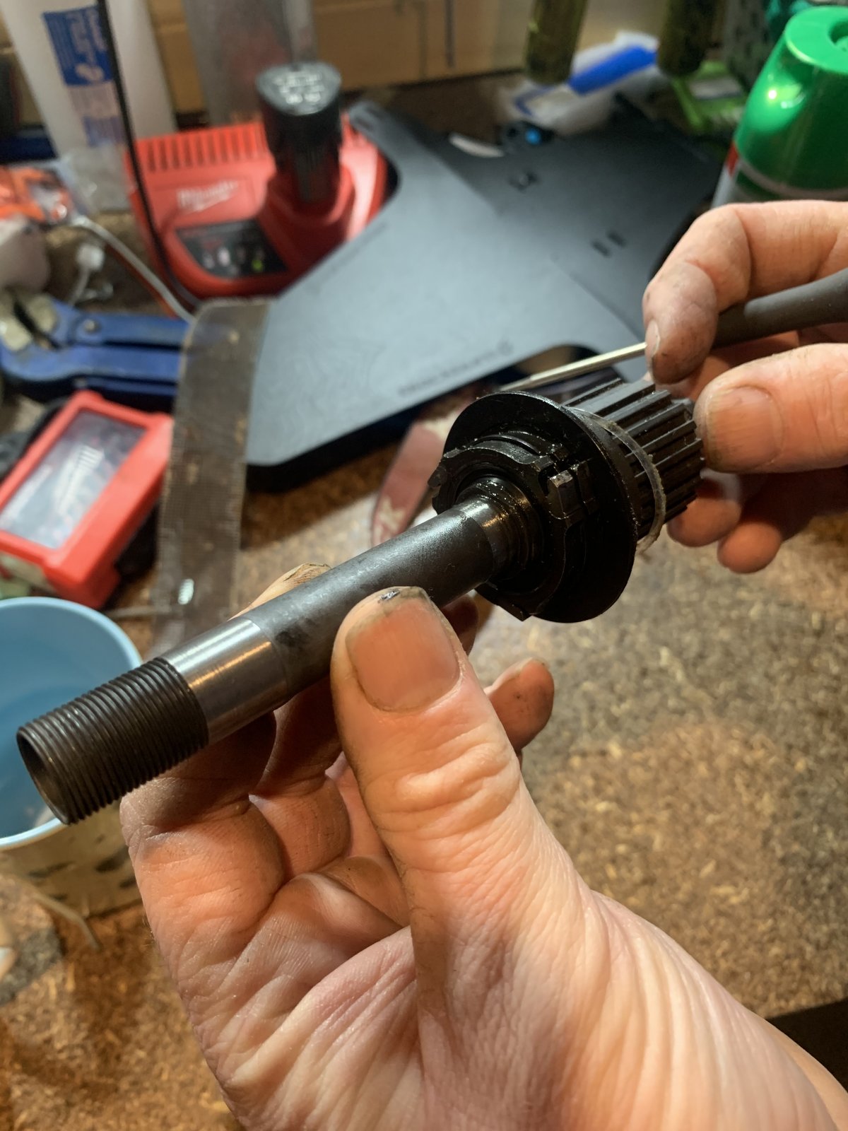

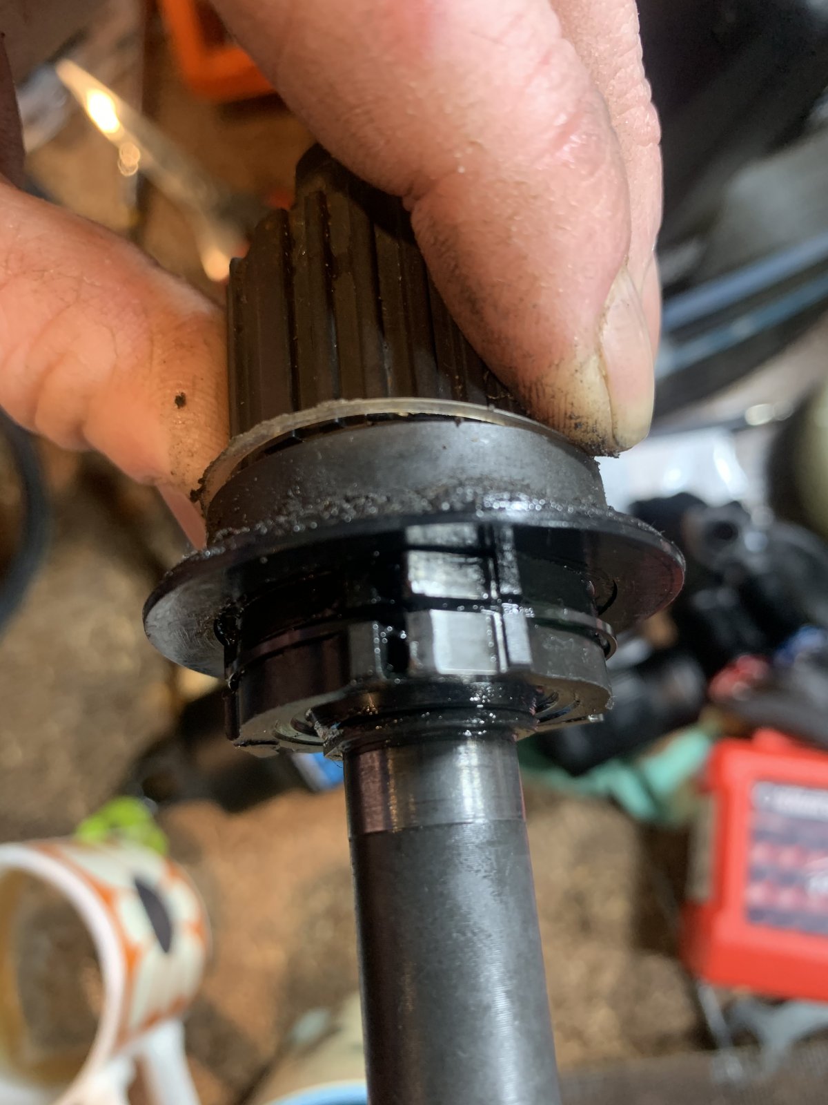

My 2018 Focus Jam2 Novatec ds162 hub had 5 pawls but the ball bearing of course. I replaced it with the ds462 with 5 pawls, steel cassette and 3 cartridge bearings.

That's exactly how mine failed too, gouged the small cup portion which I thought I could just replace.......wrong!! I did buff it out but was still rough and could not find replacement parts so I bought the 462 version on AliExpress with 3 cartridge bearings, same steel cassette driver and 5 pawls. It fit the hub perfectly.
