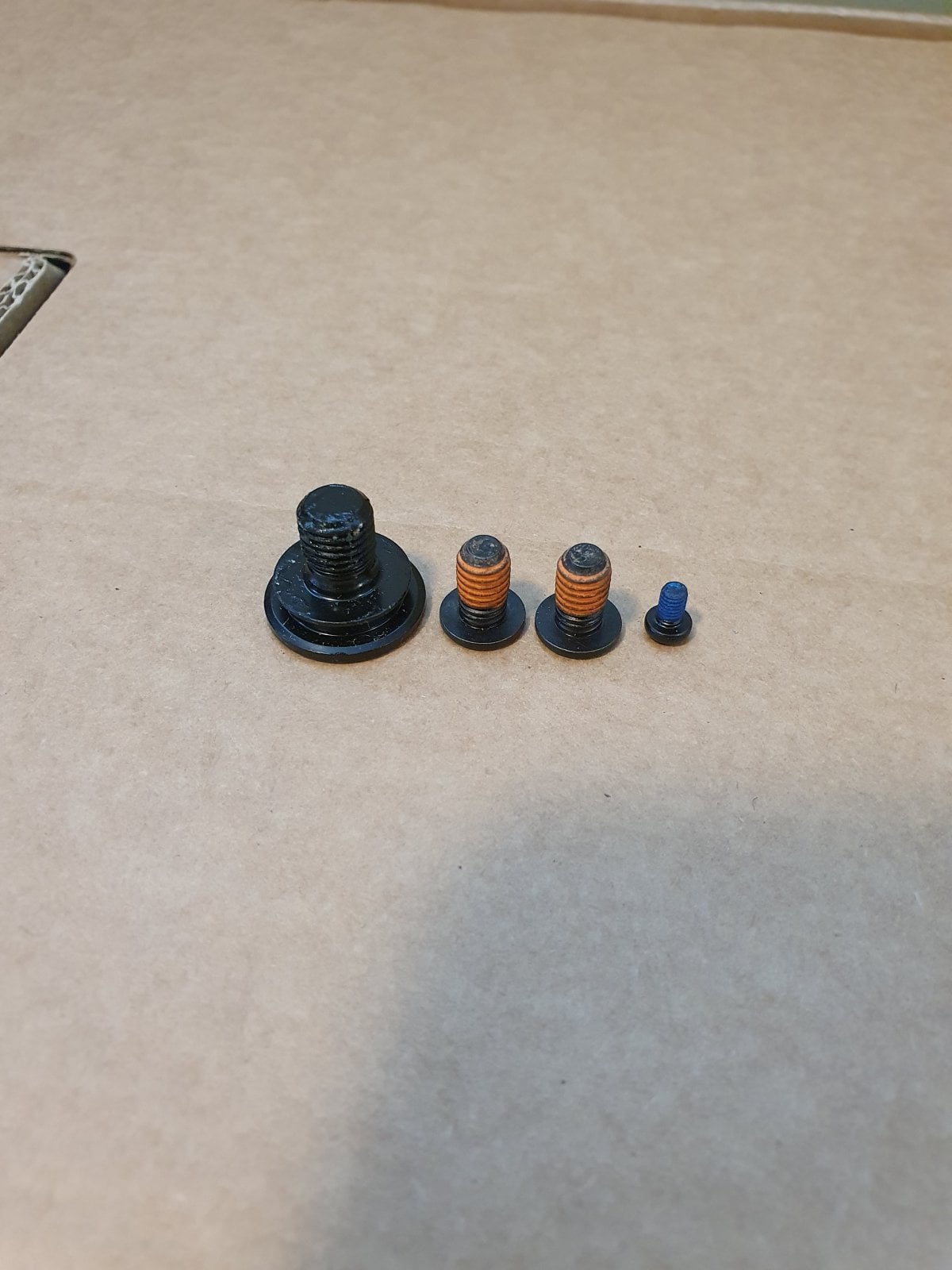

Highway, sorry I haven't. Got my bike today though! Actually earlier than previously estimated :).
But I've got two mounting questions:

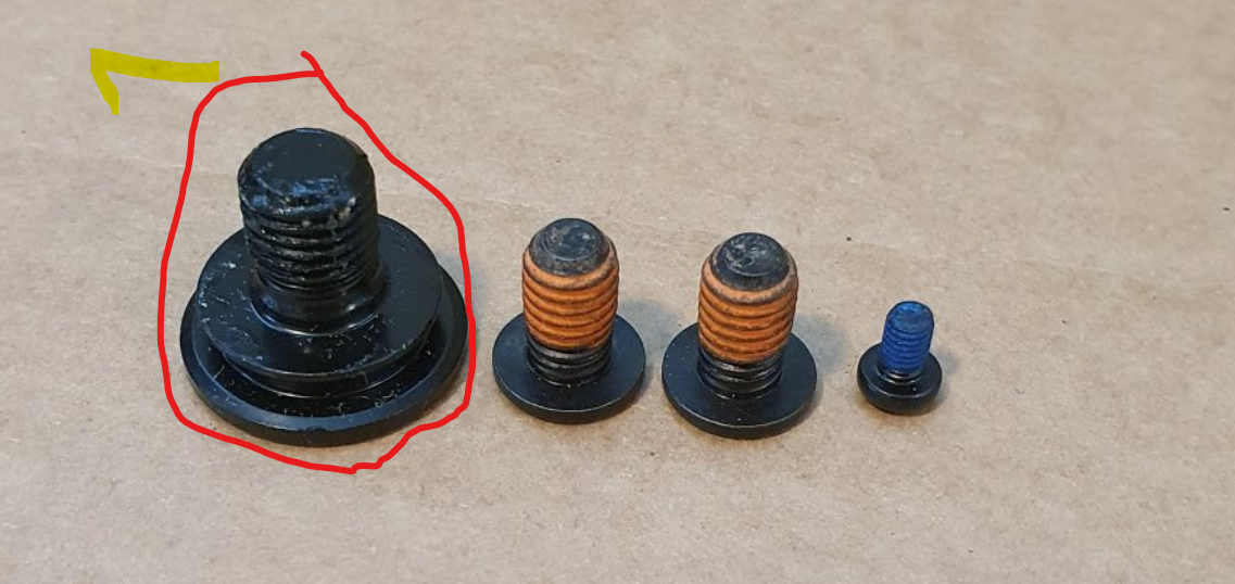

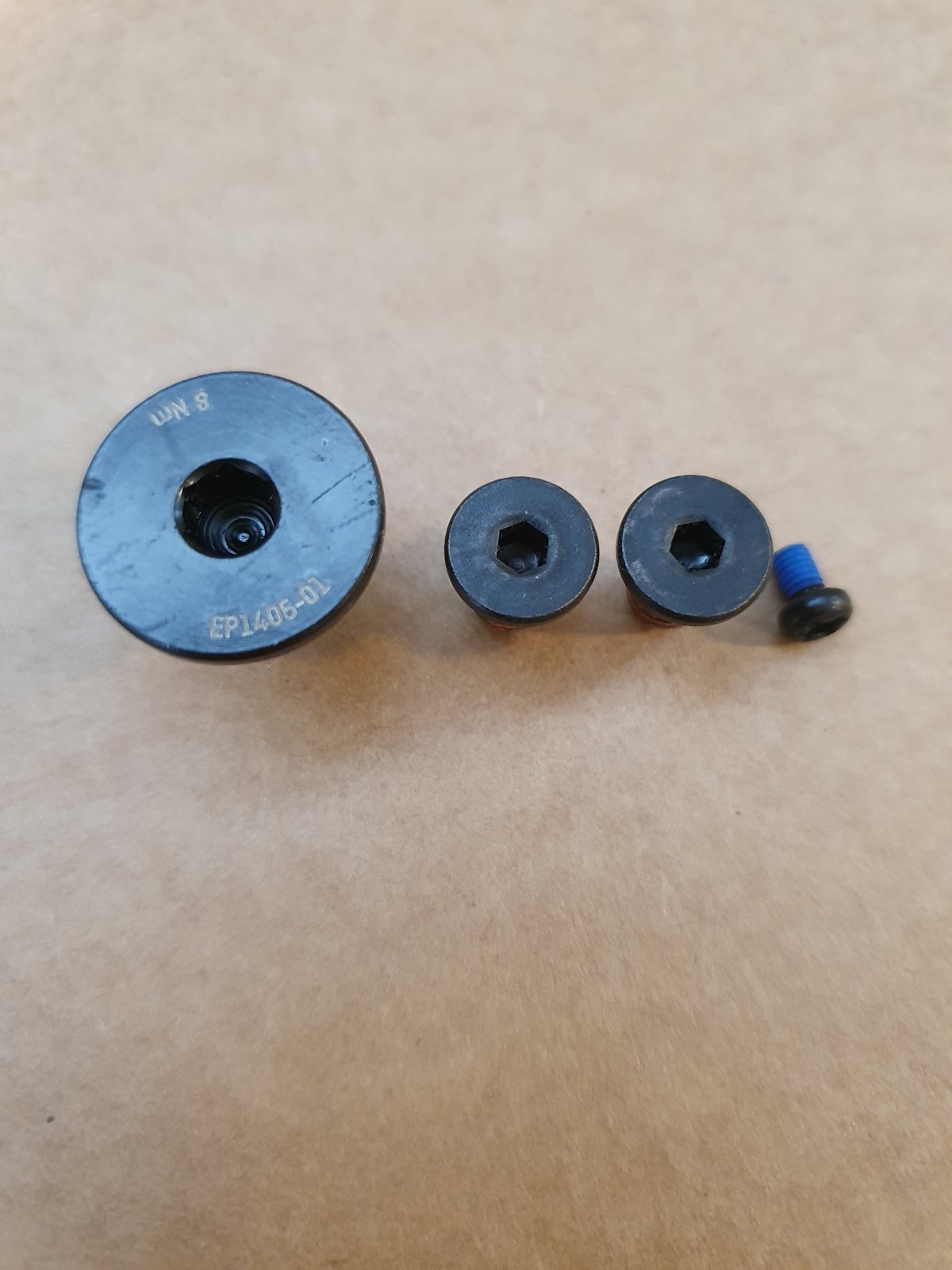

-These screws were lying loose at the bottom of the bike box, what are they for?! See pictures.

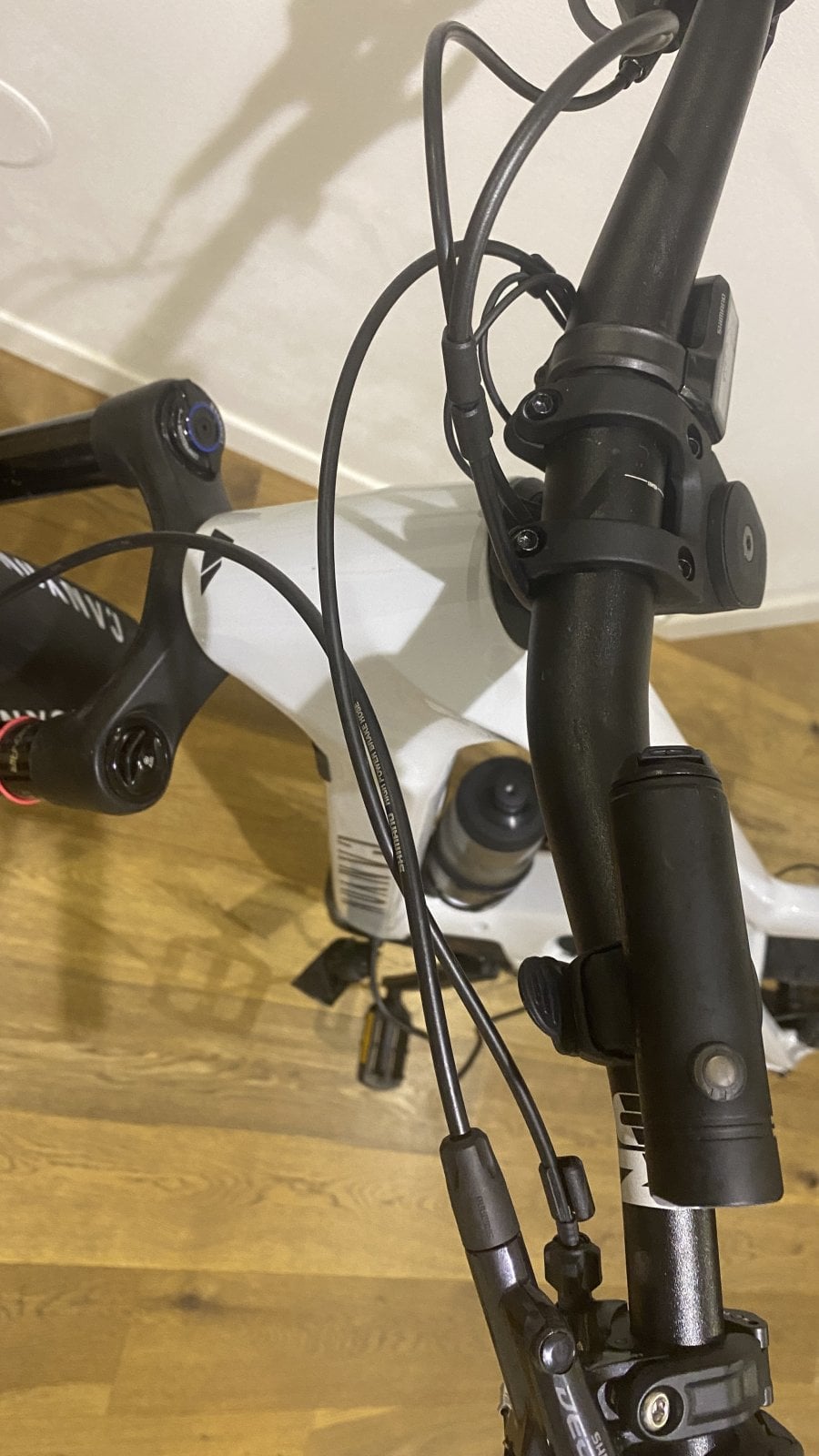

-The cable to the dropper post seems short, how hard can I pull on it to be able to attach the lever to the handlebar?

Hi, I had just smallest one (2 of them) in the box, one felt from the box when I pulled the box through our door :). I did not find the place for them.

Thanks for the input guys! I'll have a look in the battery compartment, if anything is missing there.
Have to say that the whole thing with finding unattached screws is sloppy by Canyon and a bad experience. Hopefully, I'll get a smile back when riding the bike!
Did anyone experience a too short dropper post cable?

No, my dropper post cabel has still some reserve

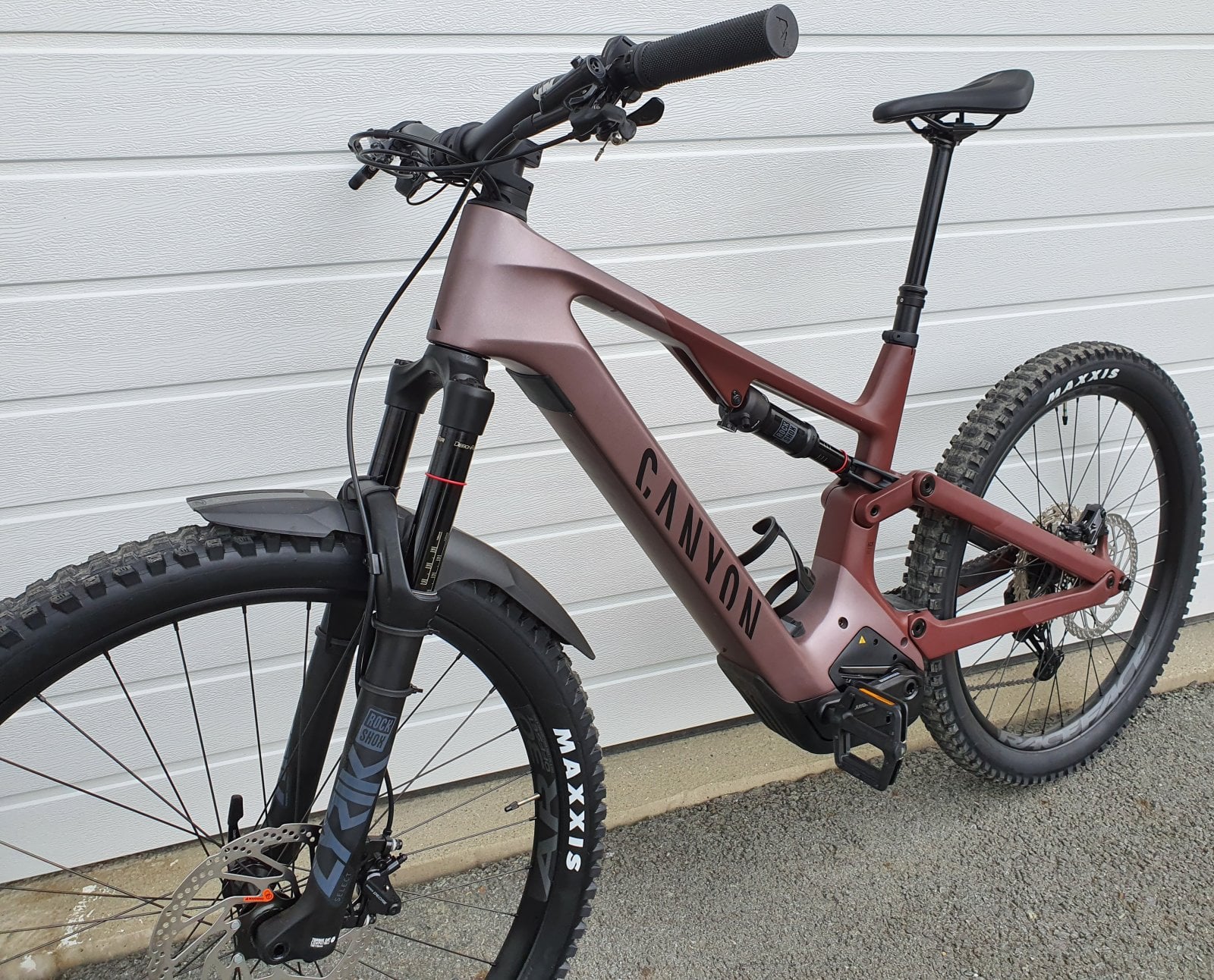

Got in contact with Canyon customer service and they answered quickly. I should just disregard the extra screws and use as spare parts. Dropper post cable came out after some mild force.
My CF7 is put together now and I had a short ride. First impression: what a bike!! Plush ride but still playful. And a very quiet motor! Compared to my wife's Focus Aventura with Bosch gen 4 motor, the Canyon is shifting much more smooth and the motor is definitely more quiet.

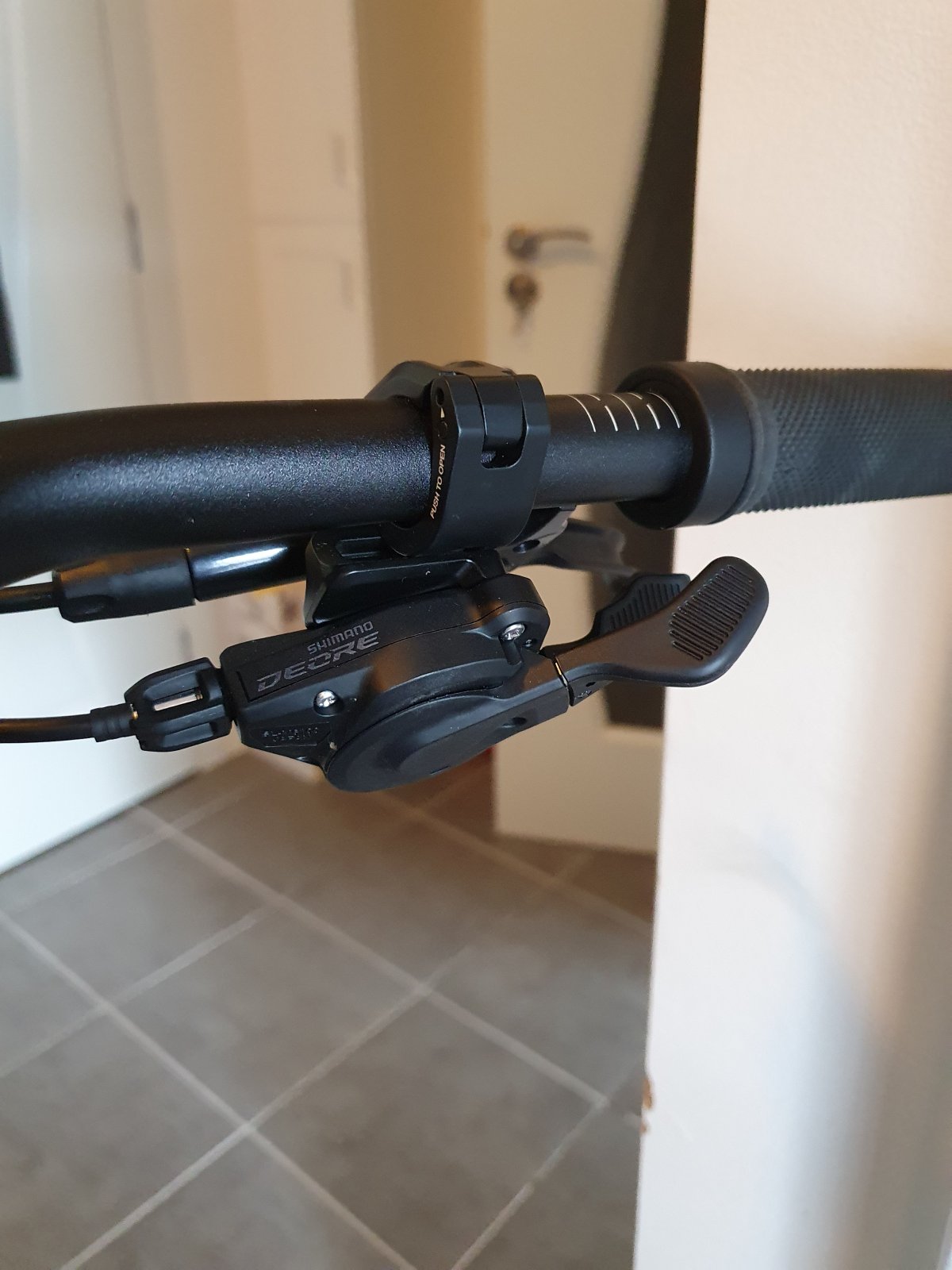

TKB / does it use a regular stem and handlebar? Cheers
Yes, CF7, CF8 and CF9 all use a regular stem and handlebar (y)
Regarding a previous doubt I had, rubbing of the chain on the chainstay, I can report that there is no rubbing whatsoever after 100km of trail riding.

Cheers TKB / on another note / does the right hand shifter use the regular clamp or the I spec integrated as I’m changing brakes to sram. Thanks in advance
TKB
Apr 28, 2022
85
35
Norway
There is only one clamp for the whole shifter/brake package. But why change to SRAM, the Deore 4-piston brake is plenty enough! And I ride 800m downhills here in Norway.

Cheers for the pic TKB / looks like a new shifter is needed. I’m not a fan of Shimano brakes tbh and I’ve a nice new set of Code RSC to go on.
In respect to the brake choice - I suppose it’s a case of what you like to use isn’t it ? Personal preference and all. I’d love to ride in Norway one day.

You can buy adapters to mount the I-SPEC EV shifter to SRAM brake clamps
One example: WOLFTOOTH ShiftMount Shimano I-SPEC EV - SRAM MatchMaker, 37,50 €
barney96
Sep 27, 2021
40
17
England
Yeah - thanks - looked into the adapters / but sadly it won’t work for the shifter that comes with the CF8 which is Shimano slx 7000. :mad:

My CF8 turned up the other day and it seems both brake hoses wheres twisted and kink during packing. Customer services have said my local bike shop can replace. Does anyone know how the rear hose is routed around the motor?
barney96
Sep 27, 2021
40
17
England
The hose is routed above the rotor. Mine is in my LBS having the rear brake changed. Seems it may even have to have the motor dropped down. I’ll confirm when I collect it.
