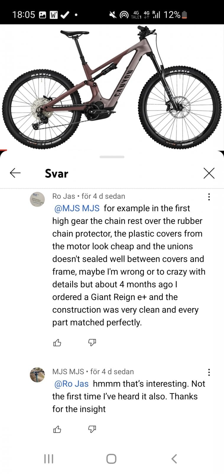

Hmm, this comment written by Ro Jas, found under the Send it Frankie video is a bit worrying!
