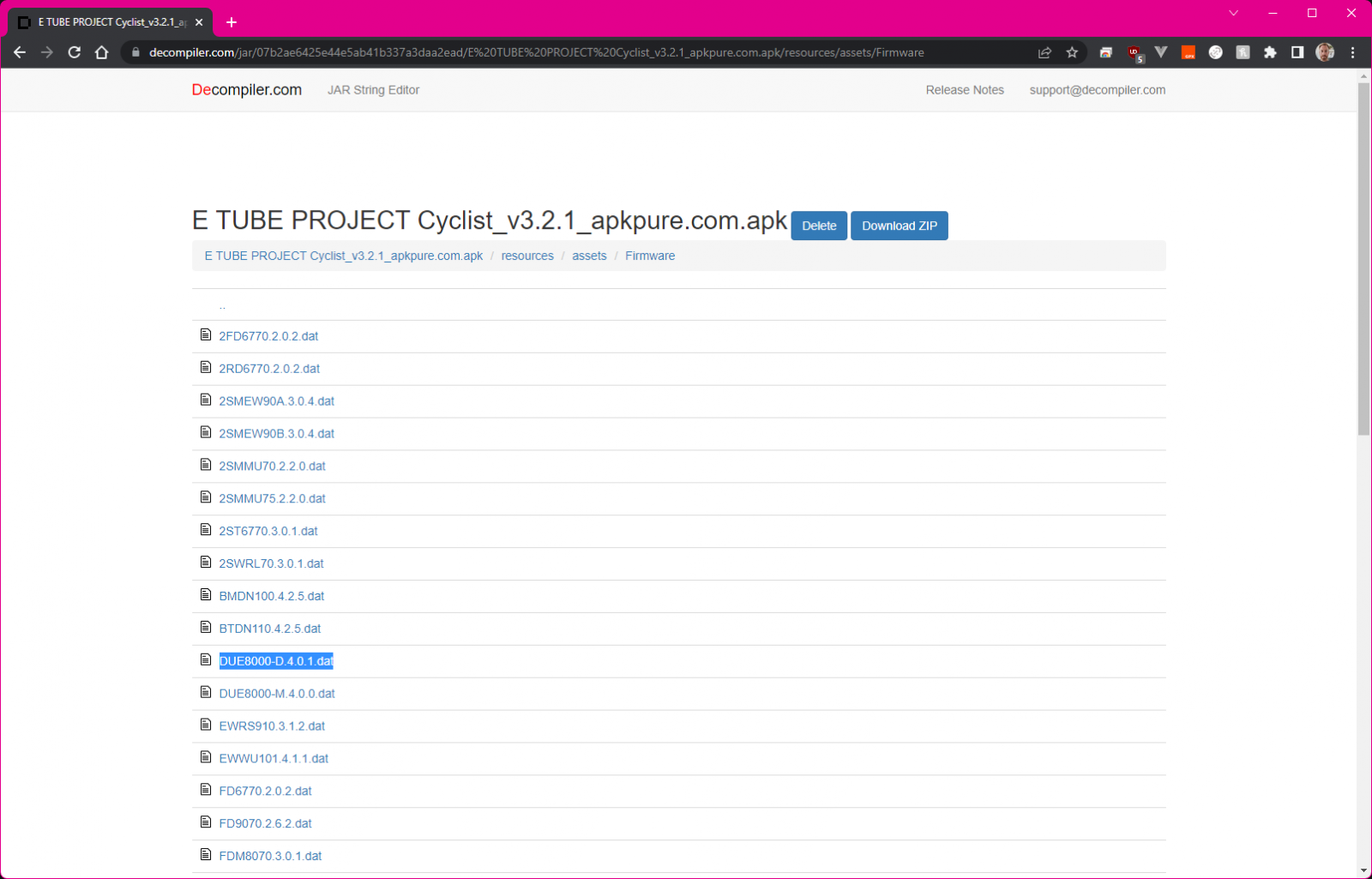

If it's too tricky on iOS I'd purchase a cheap 2nd hand Android phone just for this purpose.
BTW, the firmware files are also within the Android "APK" files, i.e. the app install files. There are lots of APK mirror sites that store old versions of the etube app.
If you go here for instance, you can download all the older versions of the e-tube app:
To get to a firmware file, download an older APK and drop it into
Browse to resources\assets\Firmware
Now you can see and download each individual firmware file.
Then follow this guide to install old firmware... https://etuning-app.com/downgrade.pdf
