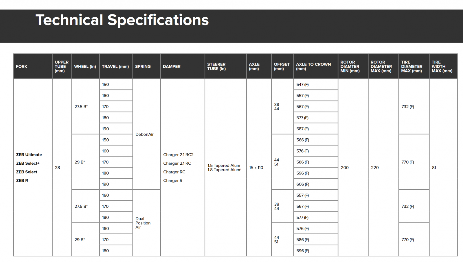

From 150 to 180 on the same fork with a just a click turn? That’s a nice feature men two forks in one
I would love to have the same option for the 190mm but it seems it's not available. :(
But that makes me wonder... if I could fit the dual-position spring kit 11.4018.103.012 inside my 190mm body and add an custom spacer at the bottom of the lower air spring shaft with a longer Bottom bolt. :sneaky: I could have the 190 lowered to 160
I suppose no one has attempted this since the ZEB is quite new.
If someone has done or attempted this before on different forks please do leave me a note.

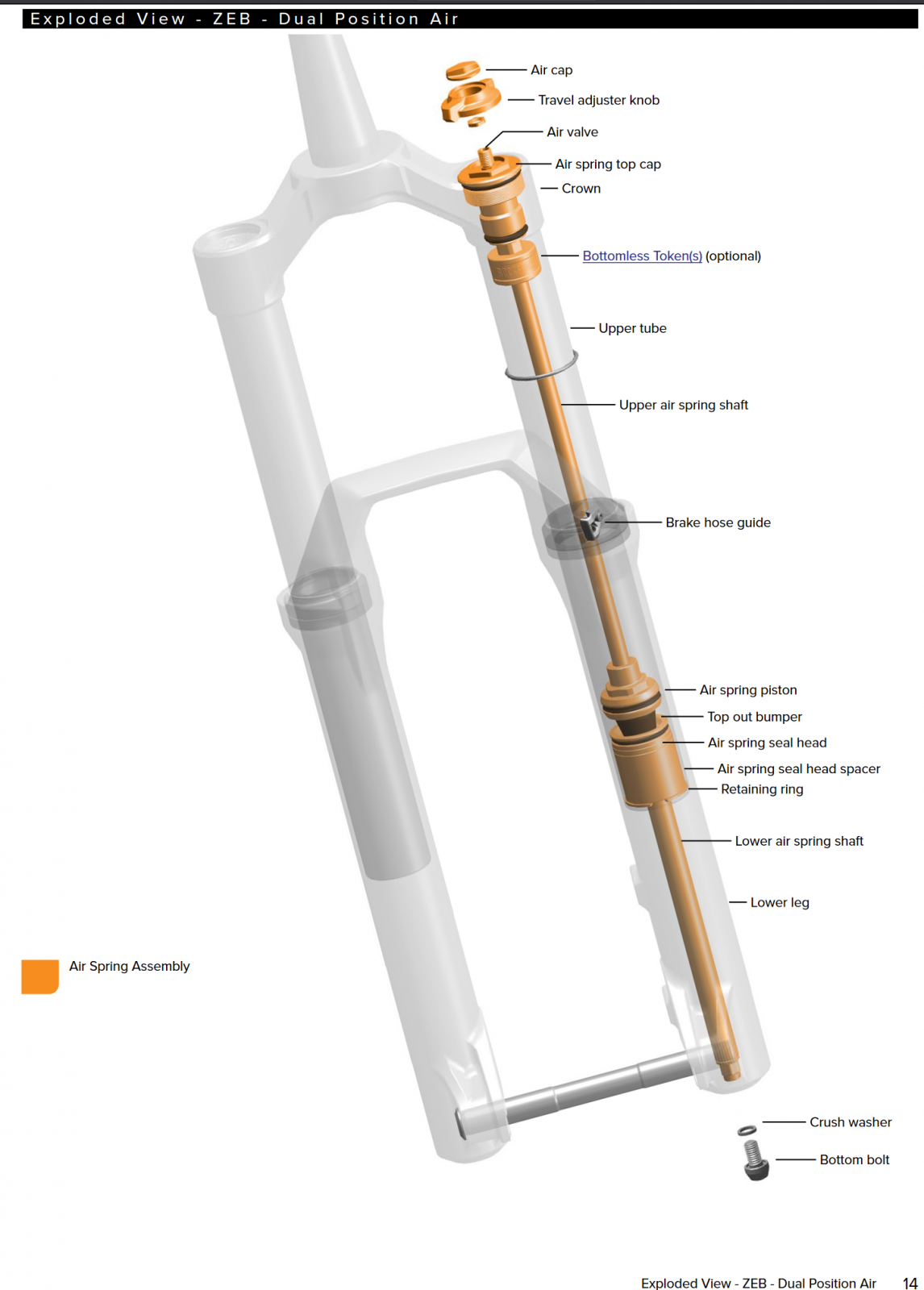

Wouldn't that make it a 180-150 fork that was 10 mm longer axle to crown?
Unless the actual longer spring shafts fit with the dual-position kit that is.
zez3
May 3, 2021
non-EU(CH)
Hmm, note sure.
Can I keep my current lower air spring shaft(from the current 190mm) and mix it with the new upper airspring shaft from the dual-position spring kit 11.4018.103.012 ?
Perhaps I don't even need the longer bottom bolt and 10mm spacer.
That is the unknown, the gain here would be that don't need to change the body and I gain the dual-position option.
zez3
May 3, 2021
non-EU(CH)
Hmm, lower air spring shaft from single position is narrower than the dual-position one, so the mix and match does not work. The only way to achieve this is by building a custom dual position 10mm longer shaft or a custom spacer with the custom longer bottom screw/bolt.
As Tim mentioned before, the later option with spacer+longer screw option will not actually bring you the dual 190-160.
Too bad that they don't have an dual-position option for the 190mm :(
