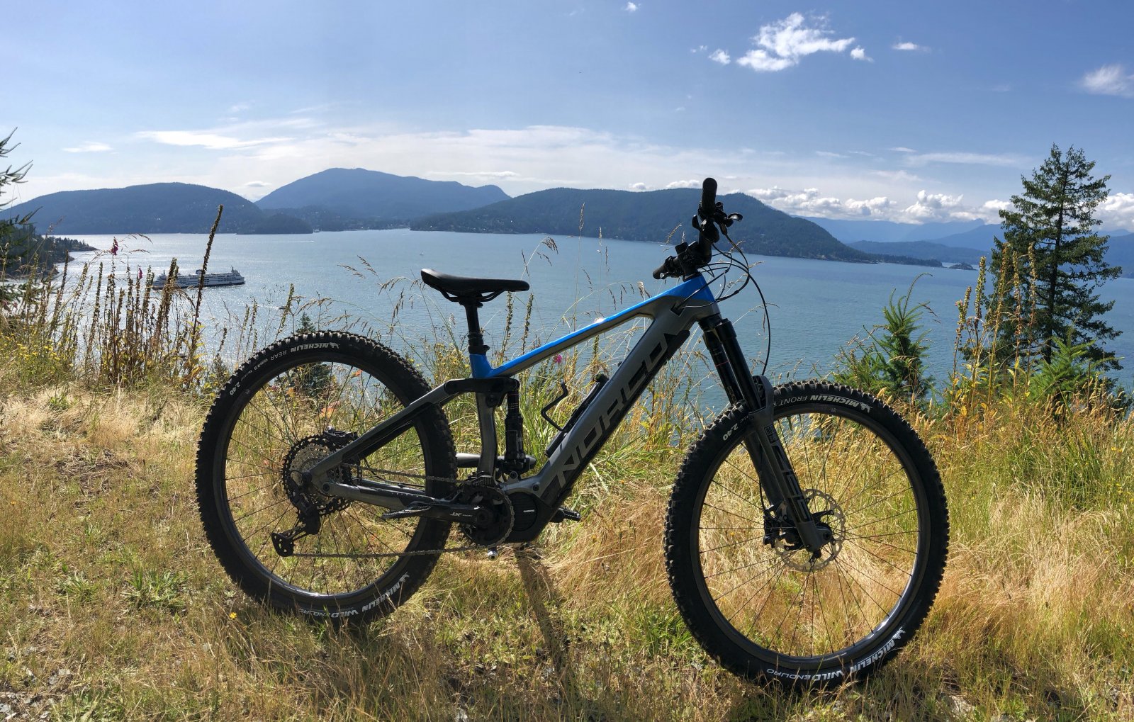

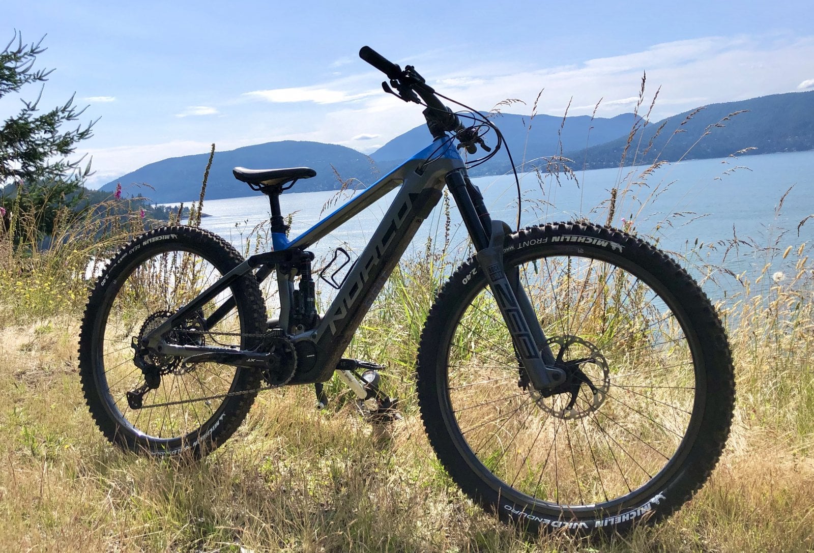

Just got these installed today.
(Stopped for a quick photo shoot on the way back from Squamish)
Will put them through the paces tomorrow.
