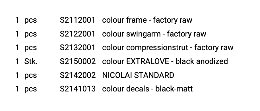

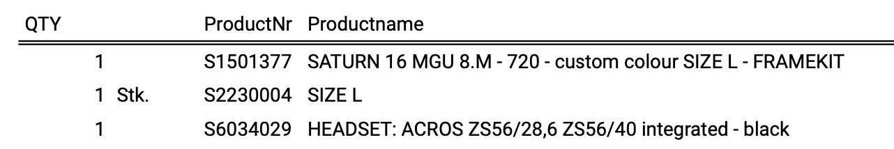

I have Nicolai Saturn 16 MGU order in and confirmed, build week 30 (end of July)
My build:
- Intend Flash 170/180mm fork
- MX Wheelset with Nicolai mutator
- Intend Hover shock
- Hope Tech4 V4 Brakes

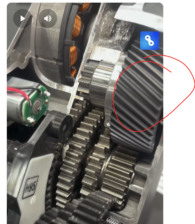

Here's a quick look inside the Pinon MGU:
I wonder why they don't use more helical cut gears (sloped teeth rather than straight cut) inside these? There's one visible in the top right, but the remainder look to be straight. It'd certainly cut down on noise with helical!
Strength maybe? - Just a guess, reminds me of when we used to build JDM big turbo cars back in the day, we used to swap out helical's for straight cut gearboxes to handle the increase in power we were delivering with the turbos.

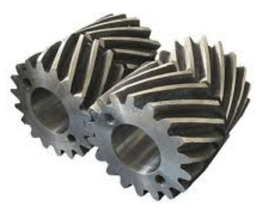

Could be, but if the car before your swap used helical, surely they're strong enough for a bike? I wonder if it's just a means of reducing cost, whereby the straight cuts are cheaper to produce? Risky though when people are 'a bit' sensitive to motor noise ;)
The helical gears do introduce a side load in the direction of the gear shaft when they're running, could be that? Then perhaps they needed to use herringbone to avoid that!
Thats a good point, there are more issues with side forces on helical gears iirc so that could be it. The cost factor as well as you say probably plays a part as well
It’s not for strength, it’s for more horse power. Straight cut gears are more efficient and make more power at the expense of noise.
