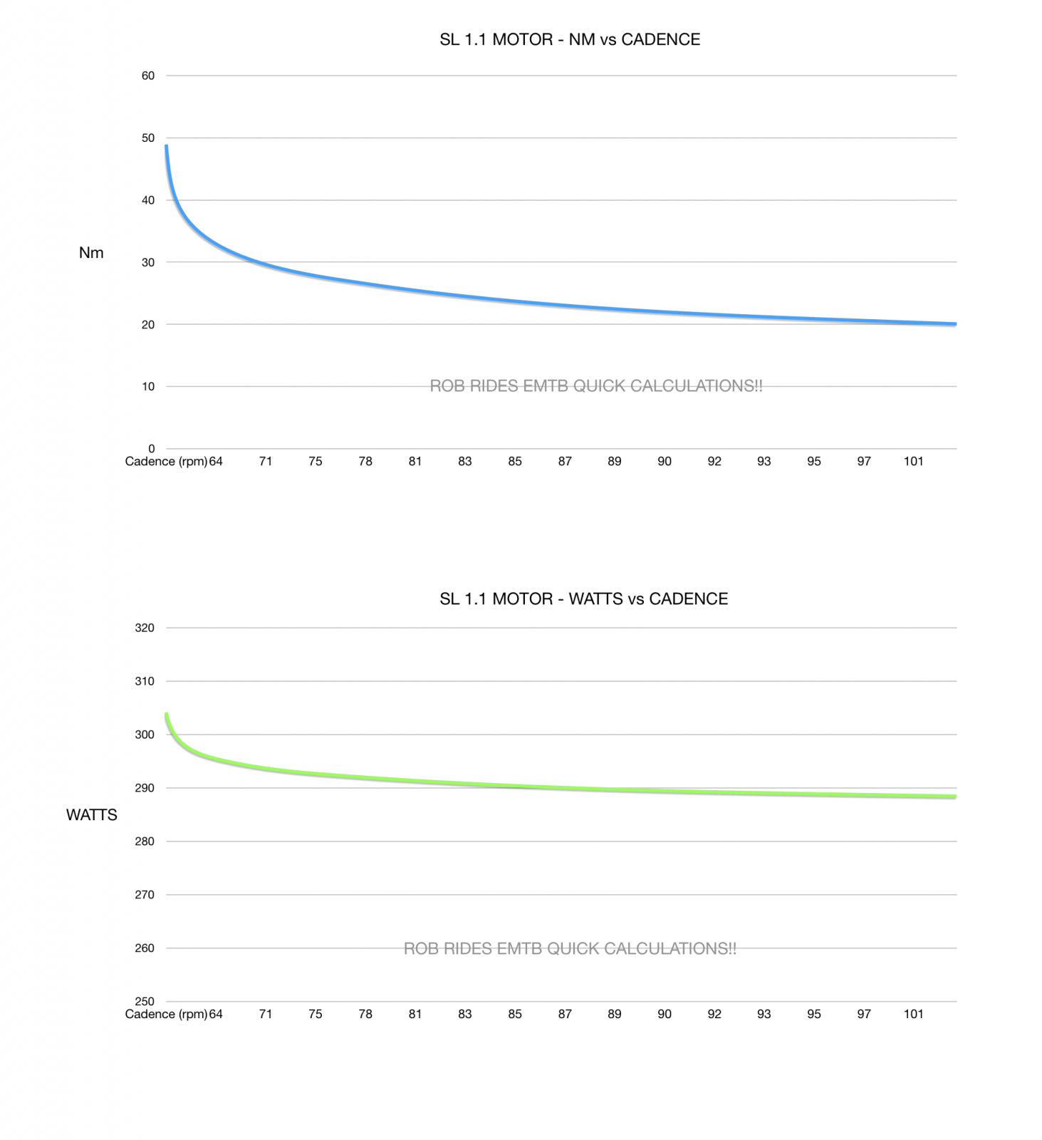

Here’s what I worked out with the Mahle motor. What you can see is NM drops off as cadence increases.

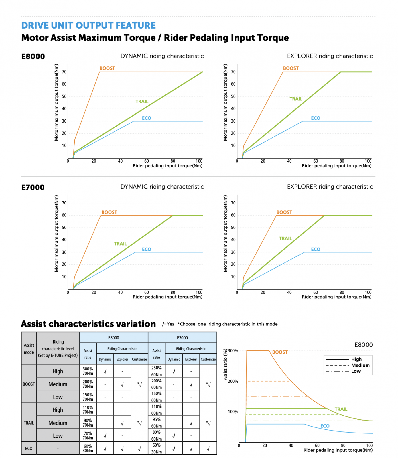

These are the Shimano Official numbers
Looks good, but nothing on there regarding cadence :) Seems like Rider Torque vs Maximum motor torque.
Cadence is super important as from what I can see we (mostly) use a range of 70-90 cadence in regular pedaling, with short blast over rock gardens etc and other obstacles.
I have heard (in a printed document) but I've not independently verified, that the Fazua has almost total loss of power assistance over 90 rpm, for example. So on paper, Fazua has 60Nm, but in reality at 90 cadence+ is has near zero.
