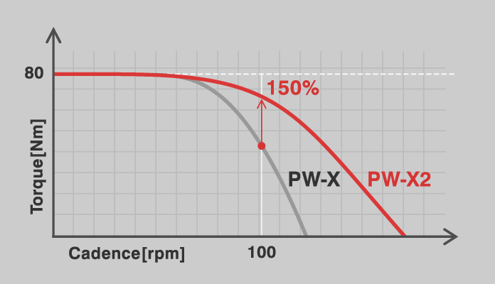

This is from Yamaha. And, yes, the torque drops down considerably with high cadence. PW-X2 seems a lot better than older PW-X.
