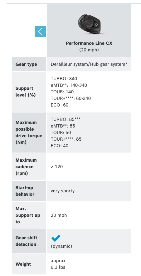

Performance Line CX:
Bosch FAQs:

I know that the Bosch chart says that Tour+ starts at 60% just like Eco, but my experience was that it gives a little more power than Eco even when soft-pedaling. ?‍♂️

It seems very unlikely. This picture gets thrown around a lot, but my impression that this is a reasonably good representation of the modes regardless of the cutoff. eMTB-lite and Tour+ should be similar to MAGICTOUR, but may have a different curve in the same ballpark.
