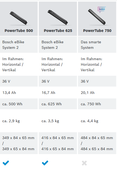

Seems to be 36V
Source: eBike-Akkus: hohe Reichweite, geringes Gewicht, einfaches Laden

As seems to be the fashion - they keep using heavier cells each time a company makes a larger battery .. :p :unsure: :ROFLMAO:
500wh Battery : 349mm - 2.9 kg
625wh Battery : + 125wh + 67 mm + 600g
750wh Battery : + 125wh + 68 mm + 900g !

Is new CX motor and 750Wh battery still 36Volts?
If it is 48V, thats the answer why is not backwards compatible.
We asked whether it was 36V or 48V, unfortunately they didn't answer.
But they did answer our question about changes, that has been published previously in this thread. There are no changes to the motor hardware. I'm guessing that means it's still 36V. A 48V motor would require different gearing I assume. Motor rotation speed increases with Voltage.
Also, using the most energy dense cells of today, the only way to get 750 Wh is to go 36V: 60 cells * 3,6V * 3,5Ah = 756Wh
It still is 36V.
  • Energy made to measure_ PowerPacks from Bosch eBike Systems. - Bosch eBike Systems.pdf
