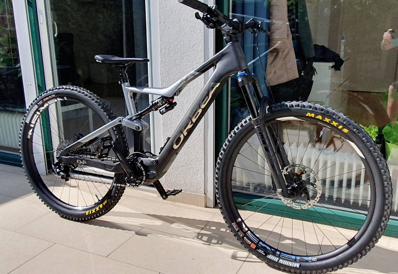

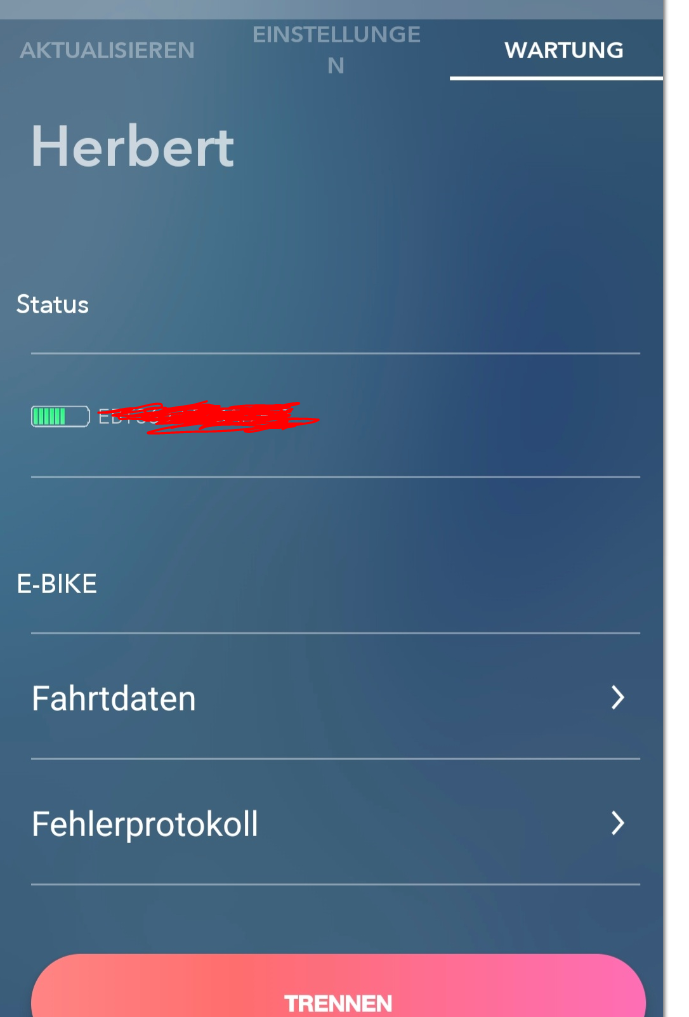

Hi,
i got a m10 and i have some questions:
1) is there a general rise 2023 thread anywhere?
2) When I changed the shock, I wanted to check the torque in the blue paper, and it says 6nm, but the screw itself says 10nm?
3) Is it possible to display the battery indicator in the app as a percentage or at least a little larger? or is there an other way to show the battery status without a display, app or without a garmin?
4) I would like to replace the rear brake and I need to lay a new line for this. is the line simply plugged through the frame, or is it still clamped somewhere in the frame? do you have to remove the battery to do this? Have somebody already done that?
here is herbert:

Re: battery 5, yi can download STUnlocker (just the basic version) and that tells you the % and other data. It sends a voice memo reminding you how much battery is left (if you want that). It connects to my Apple Watch to see, also.

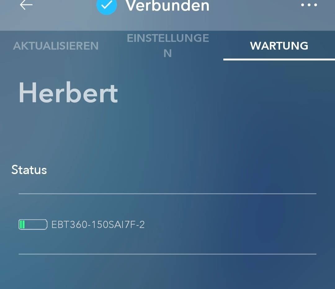

Nice bike. Did you get the 360 wh or 540 wh battery? I am curious as to the range with the 540 wh battery.

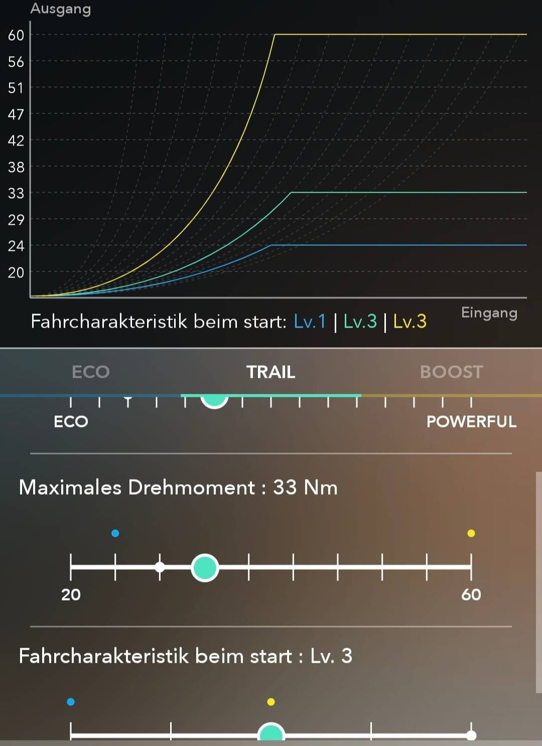

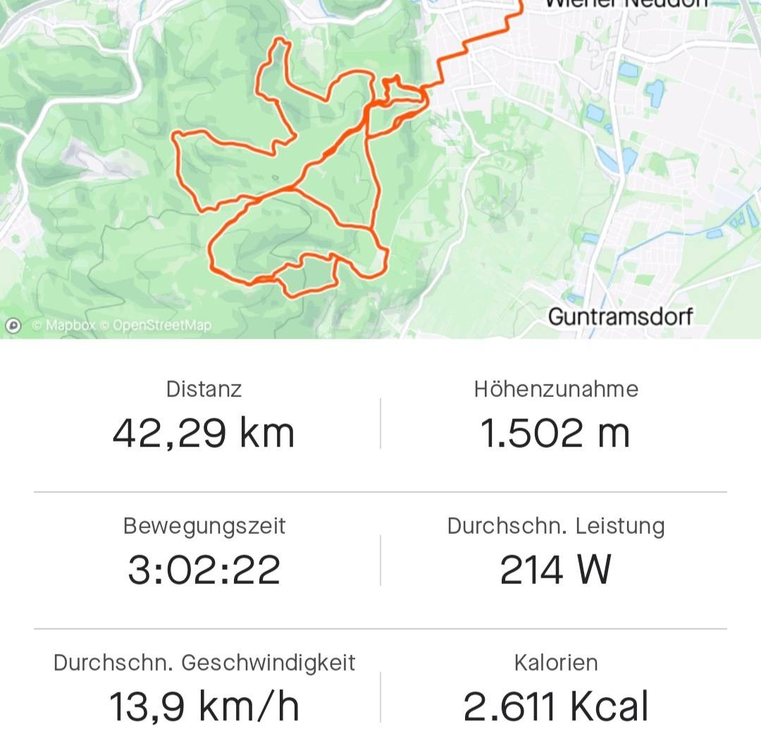

Hi,

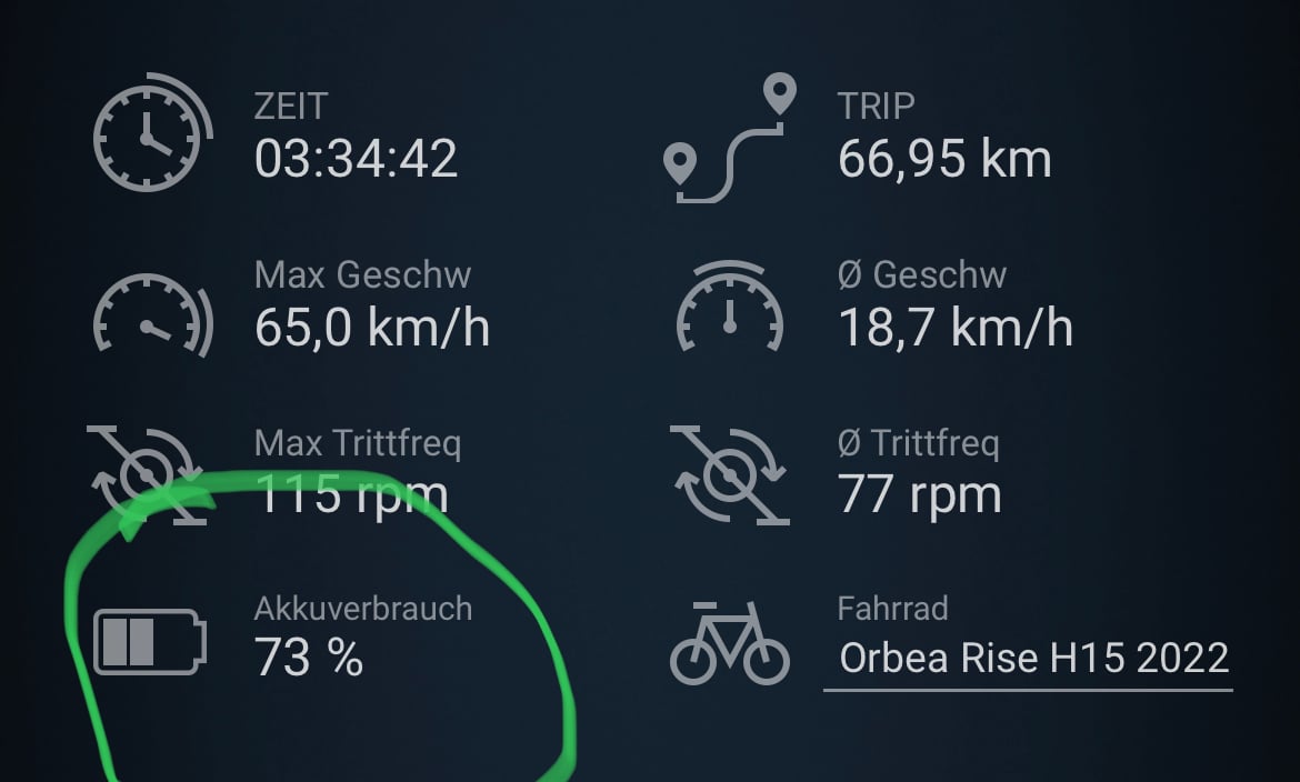

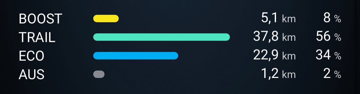

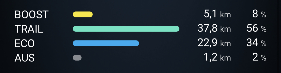

so today I rode my rise for the first time. used about 5% eco, 85% trail and 10% boost. After 42km and 1500hm there were still 2 bars in the app, whereby the display on the switch had been red for a long time, so I assume that there were 2 bars in the app but definitely <20% remaining battery
I used these settings in trail mode, so set them slightly differently
I have modified a lot on my rise. the dissector that was on the front tire is now in the back, in front is a DHF, float X, newmen SL EG 30 wheels, sqlab 611 saddle, 1x11 drivetrain (to be compatible with my other bikes), slx brakes, cameleon skin. the bike now weighs 19.7 kg with pedals. I will still change the handlebars and stem and install a Lyrik 150mm. Then the bike should weigh 19.5kg. I weigh 83kg ready to ride.
the first ride was great. Similar to my levo SL, but the rise is much faster uphill and has more range.
I will adjust all modes a little more powerfull, I don't need that much range. and if I do, I still have the eco mode.
The only thing that really bothers me is the incredible engine clatter. Even on forest roads with 5km/h and almost flat ground there is some rattling. That can not be normal. if I really shoot in the trail then something rattles, but it is a deeper sound and it sounds like the rattling that you see in many videos about the ep8. but the rather high rattling on the forest roads sounds more as if it would come from the transmission and not from the engine freewheel. Does anyone have any ideas? Is this normal in my video?
kr.
