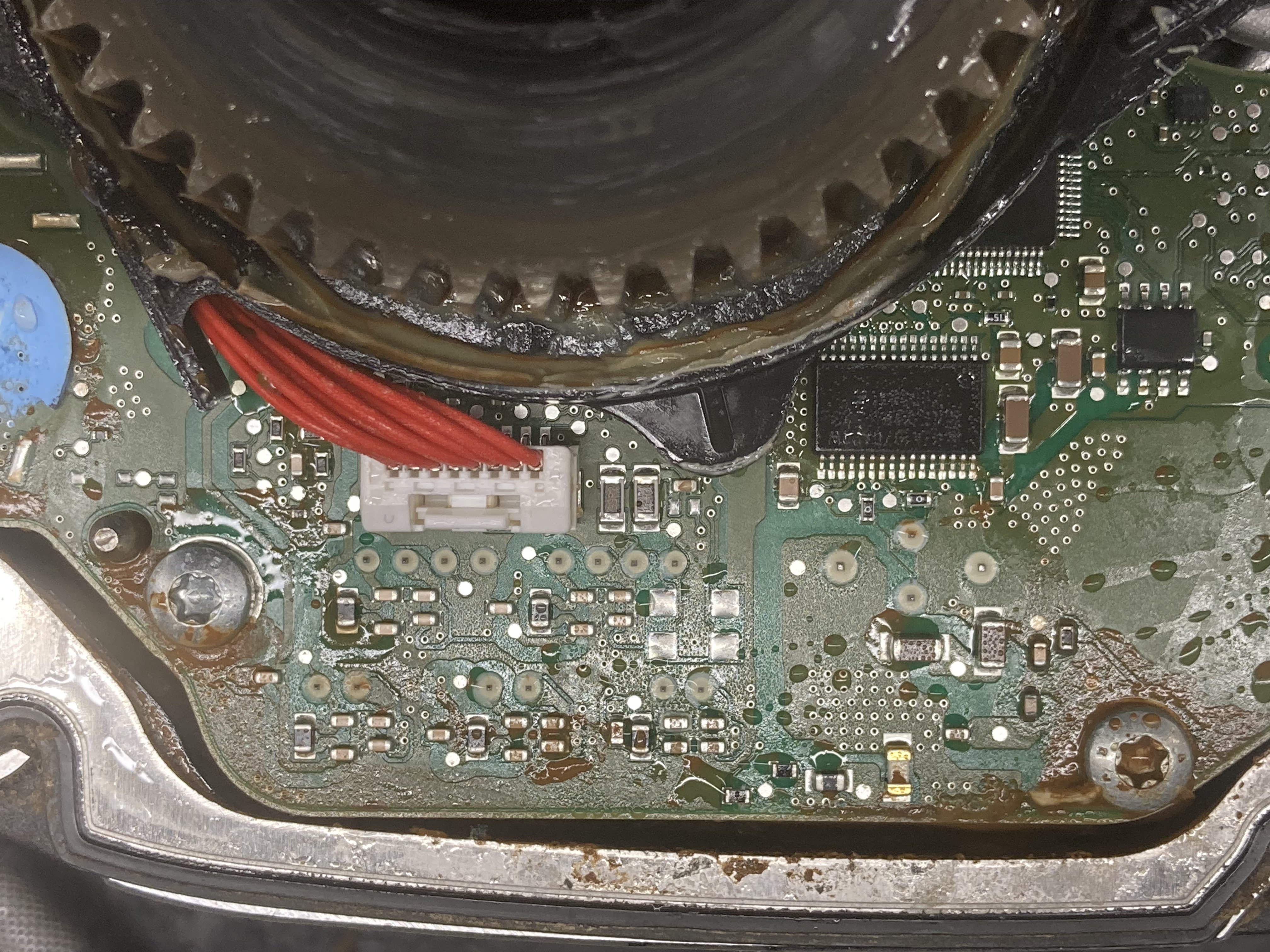

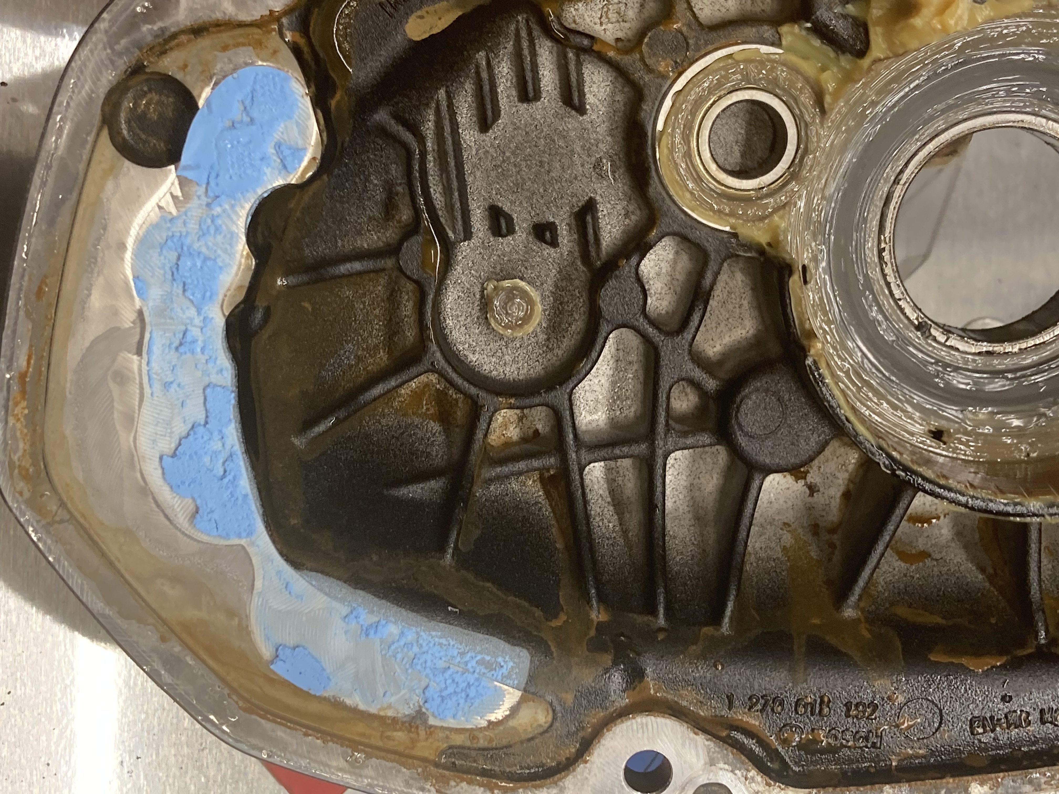

You can remove and coat the board, but the big problem with the Gen 4 is that Bosch have used the motor body as a large heat sink, this puts the electronics close enough to the motor casing to sort out when a drop of water gets to this area (see image below). Unfortunately, once a little water enters this motor, it condensates and usually ends up all over everything. See a typical scene below.

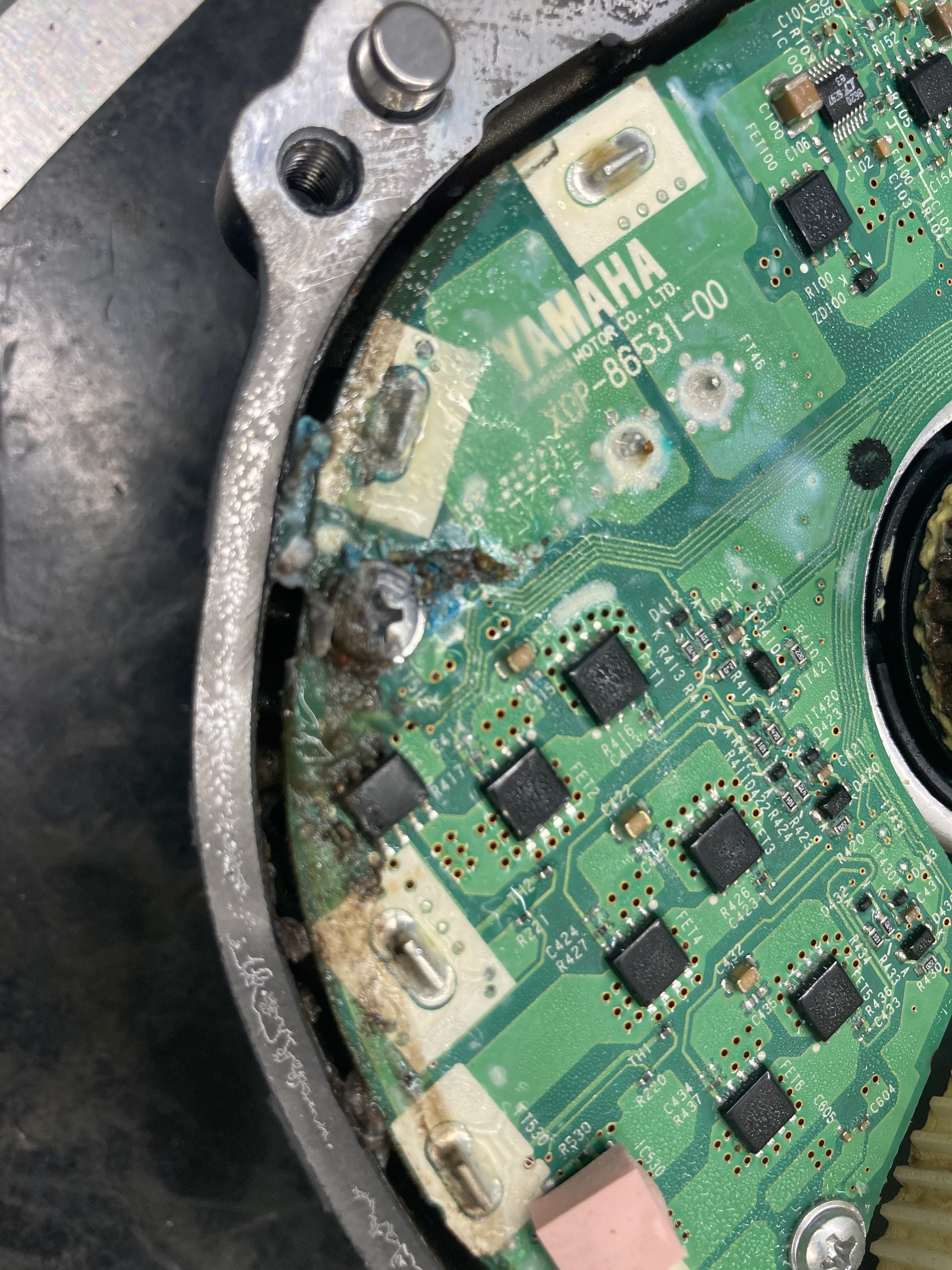

Yamaha, for example, are one of the few who do put a liberal protection coating on their PCB's but it does not really help. Yamaha's PCB's are also at the bottom of the motor, so water seeps through the multi layers of the board and shorts all the tracking out.

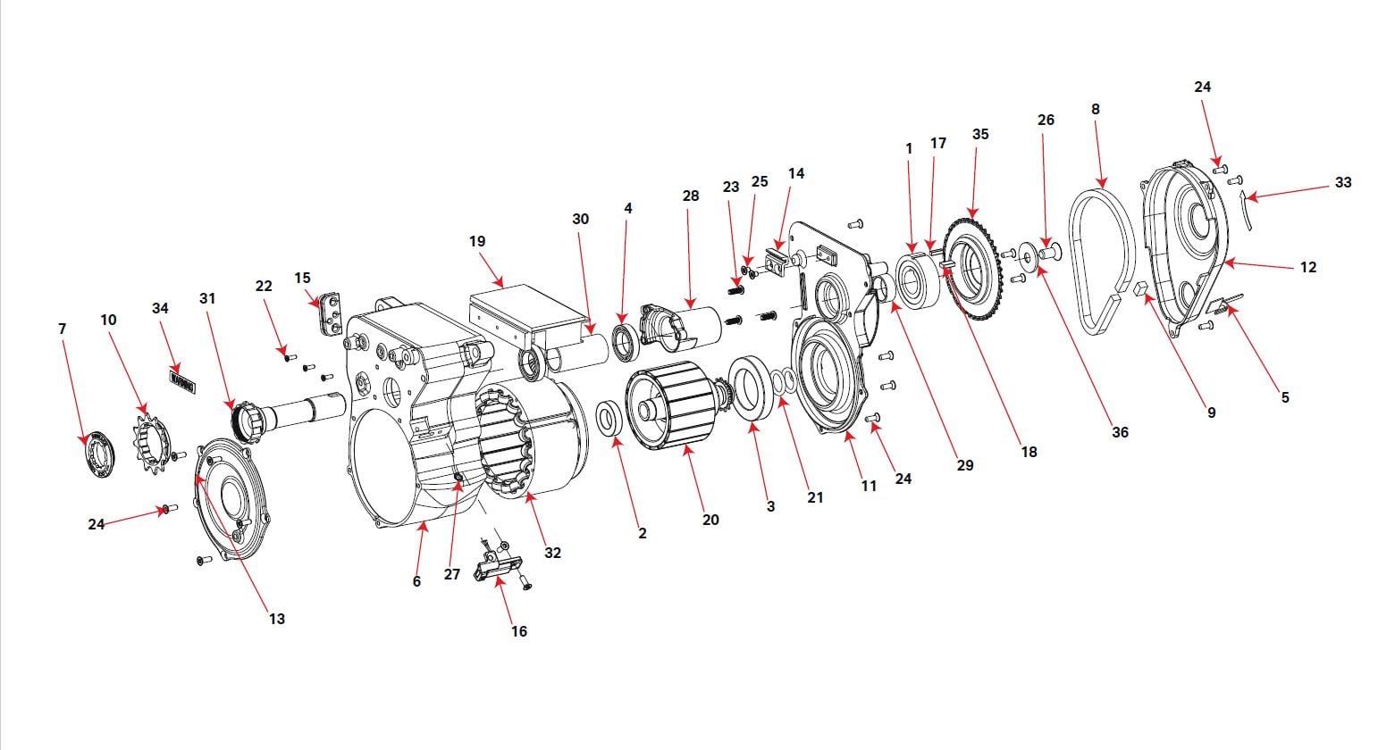

The motor bearings sit inside a sealed space
Ish.. We do find that the water comes through the bearing into the motor housing, as it does on the Brose etc. Sadly there's not one seal on the Rocky Mountain, but I do agree with what you're saying. The drive chain area is pretty well shielded, but the bottom bracket bearings are pretty vulnerable but easy to change, as is the chainring clutch bearing, but when water gets into the output shaft bearing, you're in trouble. Personally, I like this motor, it's built like an American V8 😎

Your diagram looks like the Dyname 3.0. On the Dyname 4.0 I don't see an exposed motor bearing. Or are you saying the drive chain cover itself doesn't seal against the motor casing?
This diagram is from the Instinct Powerplay Carbon. The bearings fit the same as most ebike motors, where the bearing fits into the machining space for it in the motor housing. Although this protects the the bearing seal to a degree, it does not stop the water traveling along the impute or output shaft and it can then get through the bearing seal and that's then the beginning of the end. Unfortunately, if the bearing is behind the motor case, it is not protected unless there is a seal in front of it (just like any car or motorbike engine). One thing you don't see in that diagram or the BOM list of parts is a single seal on this motor.
Once again, I will agree that the motor drive train and bearings seated behind that plastic cover generally do ok... Well except the clutch bearing crack, but they are generally well shielded so the bottom bracket bearing failure is not an issue for the motor. As I said, these are a pretty good robust (heavy) motor, but they are not sealed.
