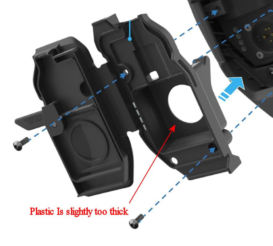

Disko,
Which style battery charging cover door does your Levo have?
My 2022 Levo came with the older style, solid plastic hinge type charging door. I was fearful of the door falling off, so I upgraded to the newer style spring operated door. Everything seem to work fine for the first month or so. However, after a while I began to have issues with my Levo not turning on. I'd have to unplug the power cord and re-insert it back into the connection port. The problem seemed to get worse with time.
I researched the matter via eMTB forum and discovered there were other Levo owners who had a similar issue. The problem appears to be a variation in the thickness of the molded plastic on some of the charging cover doors. If the plastic is too thick, it will prevent the power cord from inserting full depth into the battery's connection port. Interestingly, not all of the doors have this issue.
I still had my original solid plastic hinge type charging cover door. I re-installed it back onto my Levo and I no longer have an issue with my bike not turning on.
If your 2022 Levo has the older style cover door, then disregard my post. The issue which I've discussed only occurs with the newer style spring hinge operated door. I hope your sort the problem out.
Here's an eMTB forum posting from a Levo owner who describes how he used a chisel to shave/remove a small amount of plastic from the door cover in order to fix the issue. I've attached a picture to describe where the material needs to be removed.

Disko,
Thx. I try it.
