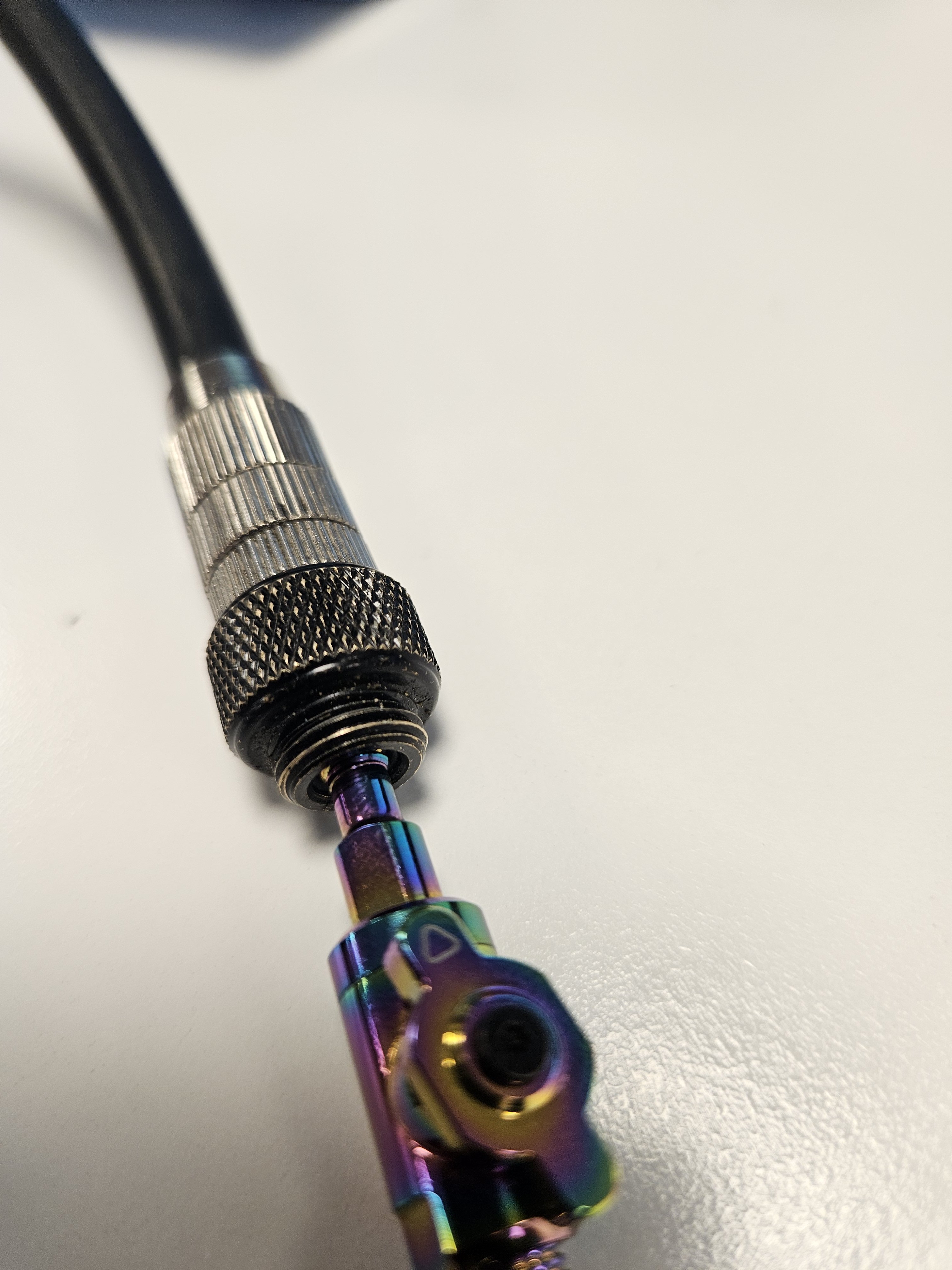

I reached out to Muc Off to ask about compatibility with pumps with screw-on chucks (specifically Lezyne), and this was their reply:
"Our Big Bore lite valves have a standard sized Presta thread with the only difference being the length of the threaded section. On the Big Bore valves the threaded section does not extend all the way to the head so we have found that with some threaded chucks you need to just engage the threads to create a seal rather than thread it all the way to bottoming out. If you attach the chuck past the threads then it can loose it seal and not work correctly. I have attached a photo to illustrate this for you."
This could be what "Michael F" was experiencing ? This is the photo Muc-Off sent to illustrate the point
I'm pretty keen to give these valves a try - probably the hybrid version - I think they're a great idea
So in the above event you have to thread your chuck just the right amount and no more in order to ensure getting an effective seal?

I agree it's definitely not ideal. One would hope this is something they will address in a future version 2 of the valve. Ideally the valves would not have made it to market in the first place, with this issue. However, it's definitely something I can happily live with in order to avoid sticky, gummed-up, bent valve cores.
Also very easy to pump up on trail-side in case of emergency, as @slickrock attests to. I imagine once I get used to screwing the pump chuck on just so, it will become second nature. It may not even be an issue with my pump as they did say "with some threaded chucks", also they are talking about the Lite version, and I am considering the Hybrid version, which has a Schrader fitting.

As mentioned, if you have a screw-on chuck, the coreless design of the Big Bore is the bees knees because there is no core to unscrew. That said, I must have dodged a bullet getting the Hybrids instead of the Lites, as I don't have any issues with my pumps getting a seal on the schrader head. Regarding the Lites, it looks like a redesign is in order to add some thread length to the head. AFAIC, the fundamental ball-valve design is not at fault here, so maybe an update will not be far off.
